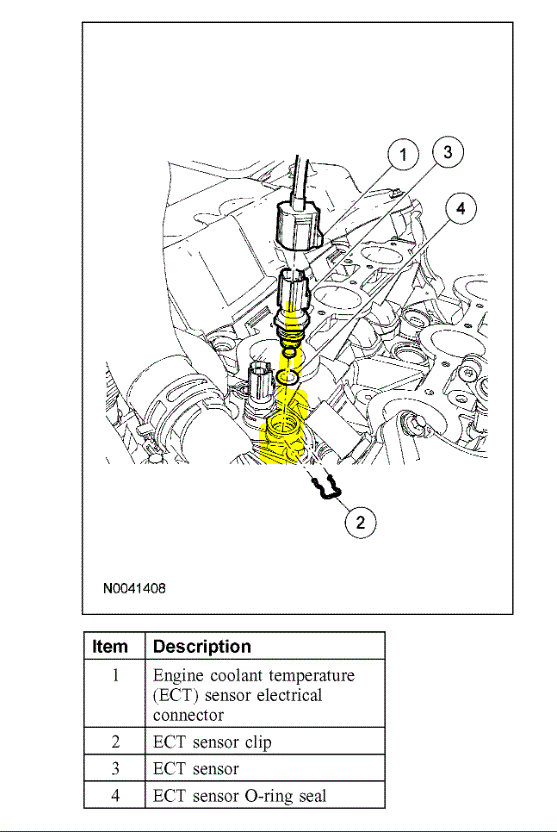

i need to know which one of the engine temperature sensors is the one for the ECM. They are located behind the thermostat and set side by side. I need to change the ECM sensor for a cold start. Thanks

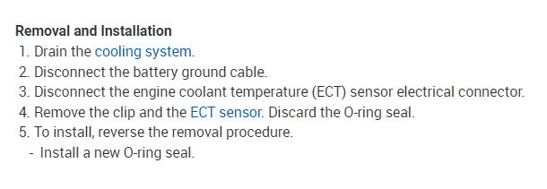

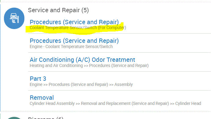

I looked up the info and the ECT for the computer is highlighted in the pic below. Additionally, the directions for removing and replacing are also included.
Let me know if this is what you need or if you have other questions.

As far as the sensor, if you look at the pic below, it shows the ECT related to the computer. That is where I went to get the removal and replacement directions.
If I recall, that is correct. If it was wrong, there would be a lot of upset people with Alldata. LOL
Let me know if this helps.
See pic below.

Sorry Joe to be a pain but the illustration shows the sensor to be the one for the cluster, is that right? so the other one is for the ECM is that what you are saying?

You are not a pain at all. According to the manual, the pic indicates the ECT for the computer and not the gauge.
I have absolutely no idea why Ford placed them side by side. Anything to make it more confusing. LOL

Looking at the picture above, it appears to be the one on the right side if you were standing at the front of the vehicle. Sitting in the vehicle, it would be on the driver's side.
Let me know how things turn out for you.
