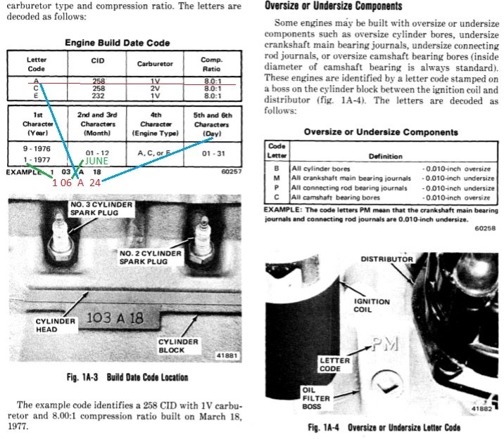

I am trying to setup timing. I have all information but suspect someone changed engine. There are three different references for the 258. Hence I need help identifying 106 A 24 this is on the block between cylinder 3-5 on passenger side. I know it is 24th day and a 258 but what year? Also have a serial number below the year date stamp it is # 970 490.

Well buddy, you cannot go wrong with that year!
I have got the same one in "Mr. Jeep", the one barrel is long gone, he now has a Holley 390.
Screenshot you a table below.

Awesome, yeah the guy before me has the distributor all wrong.
Thanks.

Yes, you have answered the block question thank you!
