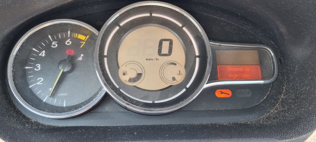

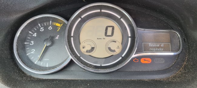

SAMANTHA HAINSWORTH
  • 14 POSTS
These are the warning lights that show up. The air conditioning or cruise control does not work either.!!!
Jul 29, 2021 at 12:23 AM
  • 110,251 POSTS
I believe that indicates an issue with the fuel injection system. (I think it's Spanish, correct?). The people who replaced the engine would have had that apart. Have you contacted them?
