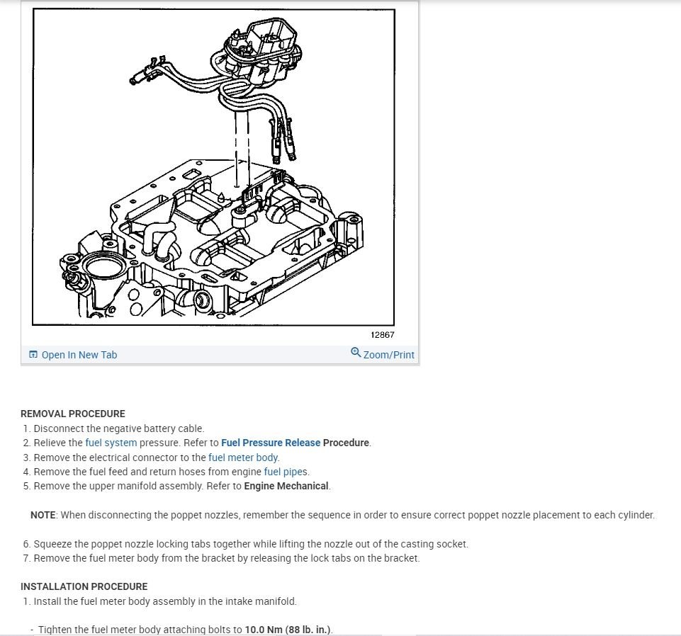

I just rebuilt the engine on the vehicle, listed above and I believe I have the timing and everything right, but when I try to start it the engine will turn for a few seconds does not start and binds up won't turn anymore. What am I doing wrong?

I took out all the spark plugs but when I got to #3 spark plug gas started pouring out. Why is that?
Feb 21, 2022 at 1:08 AM

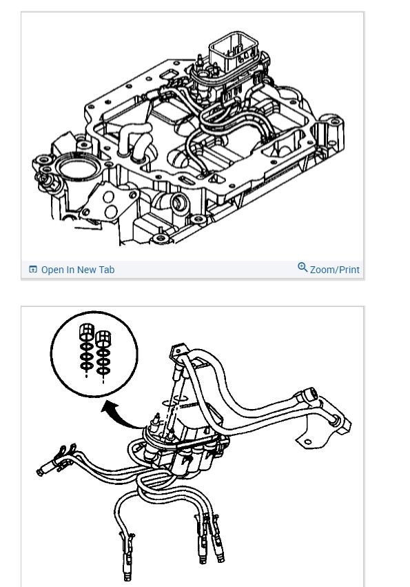

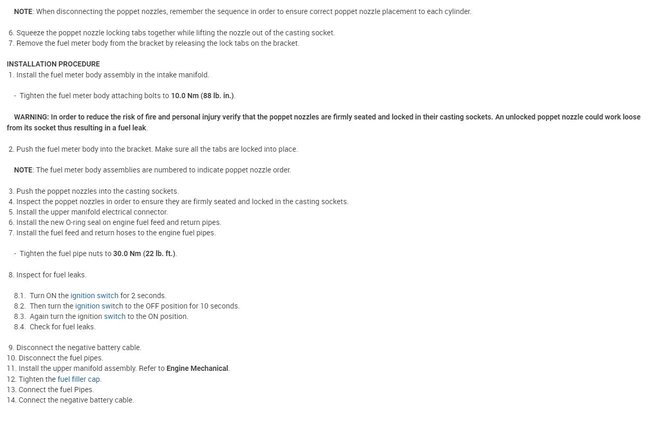

Okay, it sounds like the injector is stuck open and filling the cylinder with fuel.
The motor is a hydro lock as you cannot compress a liquid.
I would replace the injector.
I attached the procedure below for you. You will need to replace the entire unit for an injector. It is called a spider unit.
