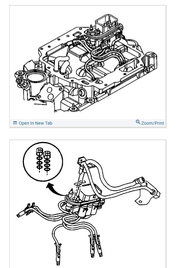

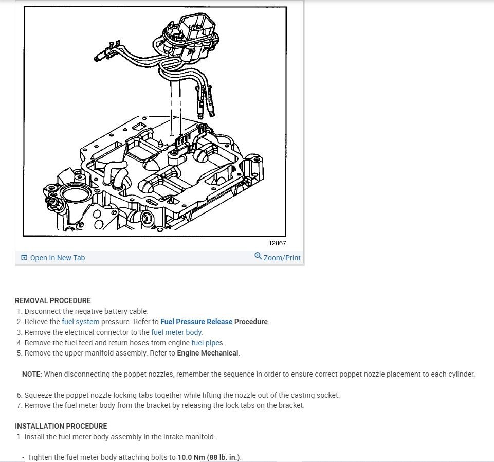

Okay, it sounds like the injector is stuck open and filling the cylinder with fuel.
The motor is a hydro lock as you cannot compress a liquid.
I would replace the injector.
I attached the procedure below for you. You will need to replace the entire unit for an injector. It is called a spider unit.
