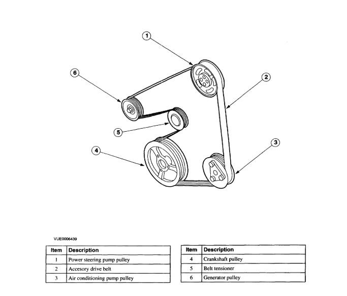

I need a descriptive engine belt diagram for the car listed above.

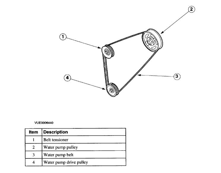

I attached the diagram for both belts for you for the 2.5.

The car has six pulleys, but the diagram you gave is five.

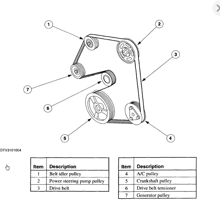

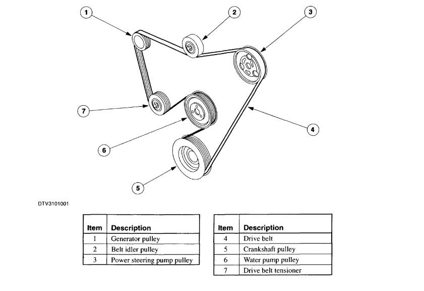

You listed the vehicle as a Cougar but I suspect you meant a Contour as a Cougar was a Mercury and was not offered in 1998. Plus the Contour is the Ford with a 2.5L.
I attached the belt diagram for this engine. Let us know if you need more info. Thanks.
