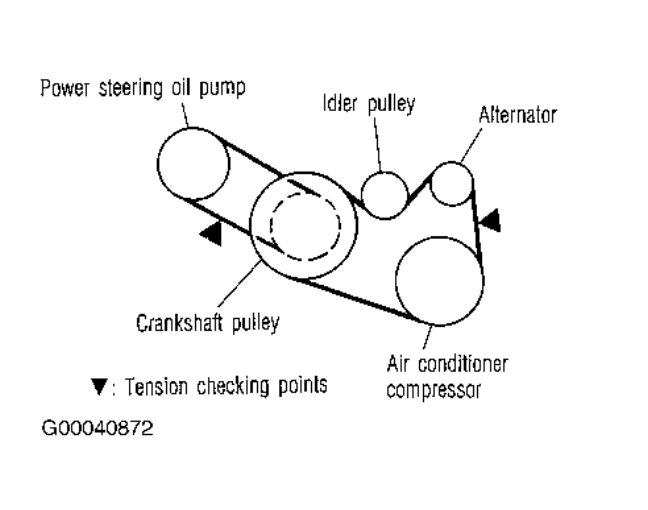

How many drive belts does this car have?
Dec 30, 2022 at 9:19 PM
  • 55,214 POSTS
It looks like there are 2 drive belts, one for the power steering and one for the A/C compressor and alternator. Check out the images (below). Please let us know if you need anything else to get the problem fixed.
