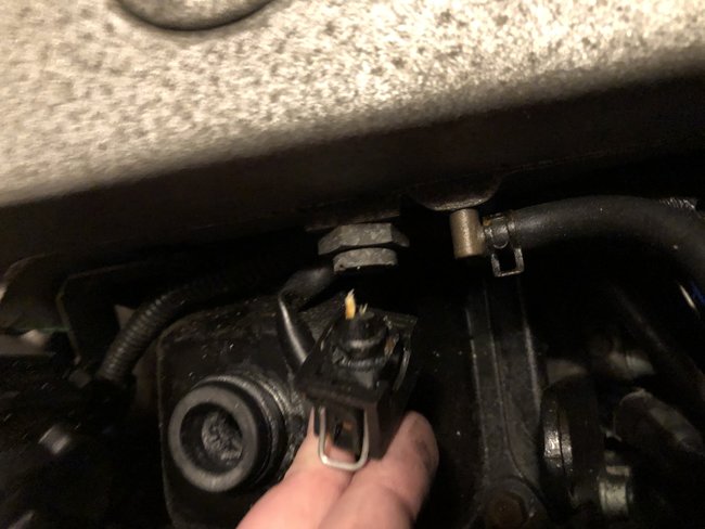

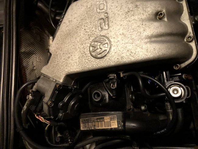

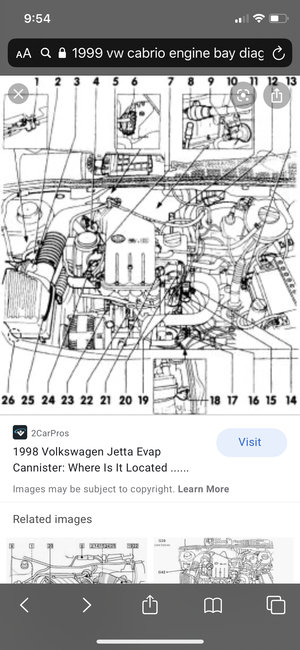

There’s a plug that goes into the left side and it is broken and I am wondering what is the name of that part, it is #7in the diagram.Thanks!

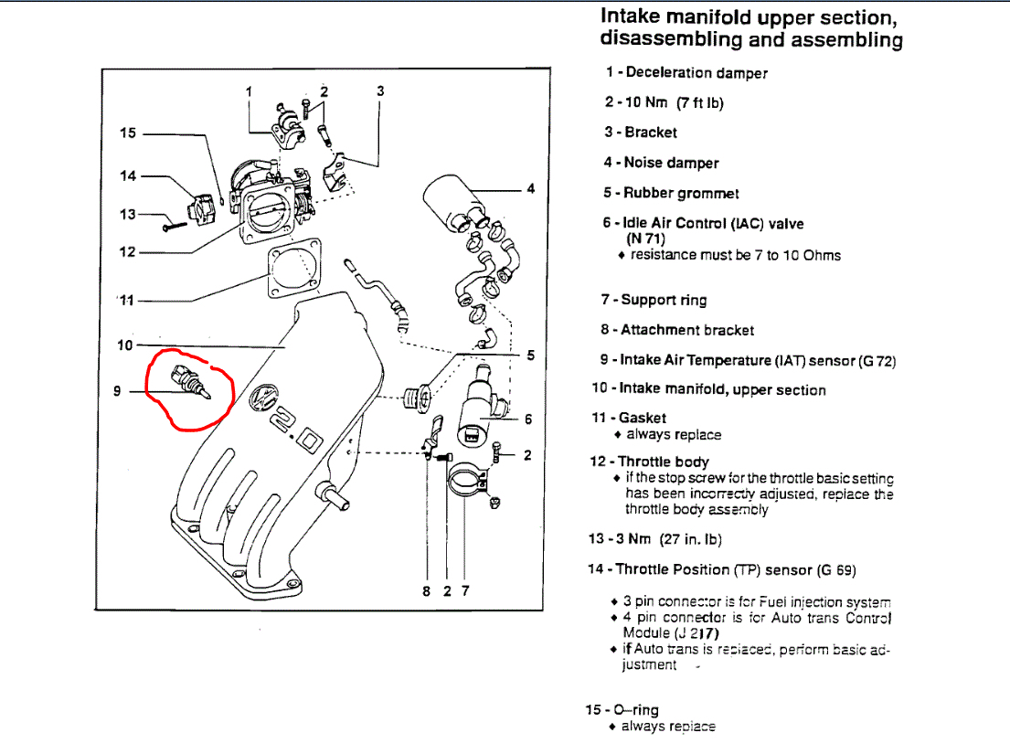

I believe that is the air intake temperature sensor. Take a look at the attached pic. I circled what I believe to be the part. Let me know if that is what you are seeing on the vehicle. To me, it appears to be this part.

Thank you so much! That was the correct part.
