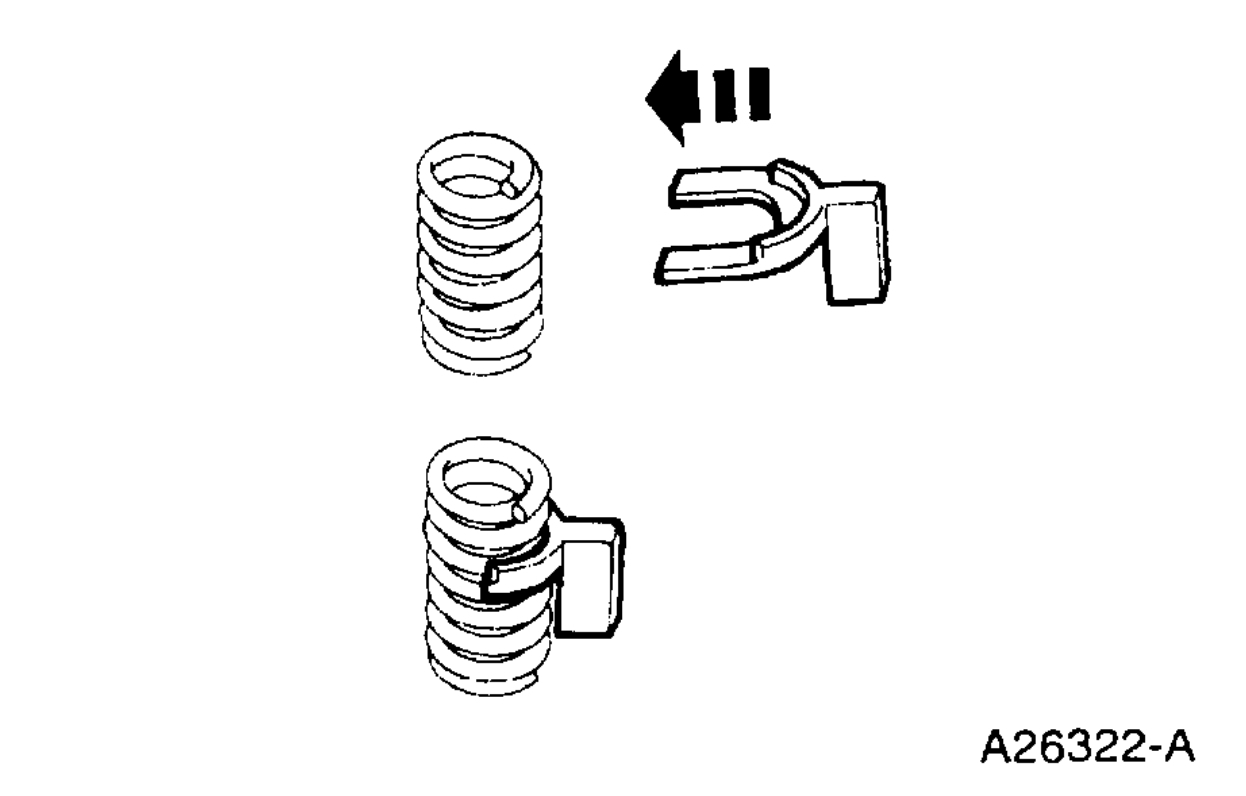

Engine is backfiring through exhaust. Bad valve?
Jun 12, 2021 at 8:49 AM
Good evening,
I would start by checking the compression. It could be a valve if the compression is low.
https://www.2carpros.com/articles/engine-backfires-while-running
It could also be a broken valve spring. The valve may not be closing all the way and it backfires out that cylinder. I attached a picture of the valve spring for you. Once one of the coils break, the spring will not have enough pressure to hold the valve closed.

Thank you Roy, I will do a compression test before I start pulling valve covers. Lee
