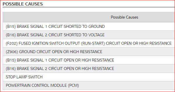

My engine and TCS lights both came on at basically the same time. I had a lot of trouble scanning with just "error" coming up. Eventually I scanned it and the code P0571 came up. My car will not engage/disengage my TC or cruise control. Are these issues all related? No issues prior.

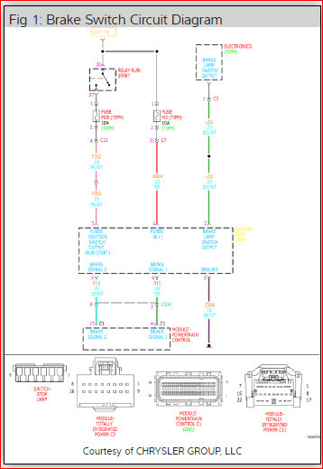

Yes, they are related. Code P0571 is Brake Switch 'A' Cruise control relies on information from the brake circuit to shut it off when braking so, It is all in the same circuits. I have attached a picture showing you the circuit diagram. I have also attached a link showing you how test and a few things/symptoms to look for. Hope this helps and feel free to ask any questions if needed. Thanks for using 2CarPros.

I had the exact issue indicated above. I replaced the brake light switch and that resolved my problem.
