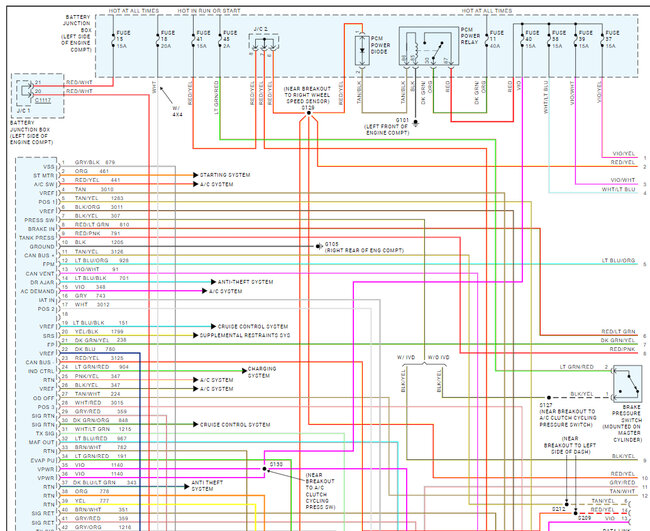

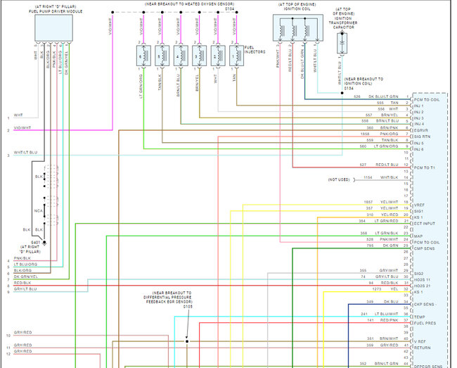

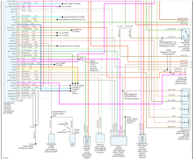

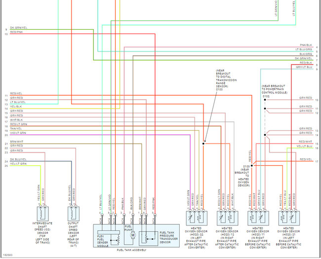

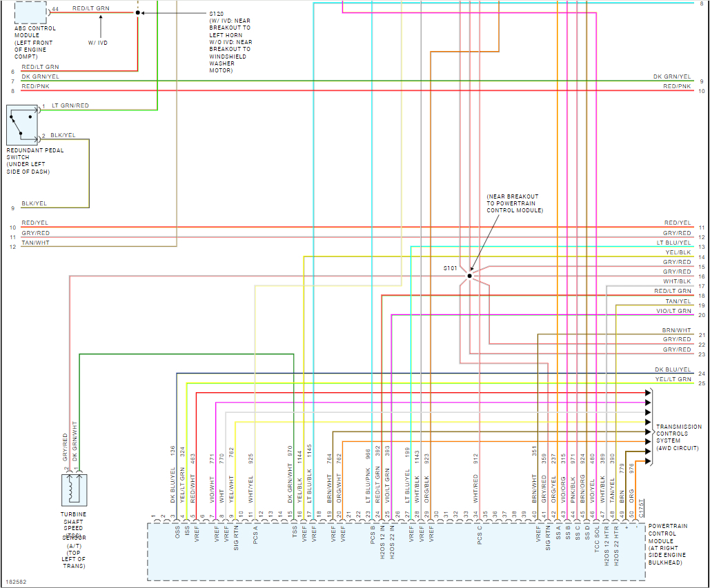

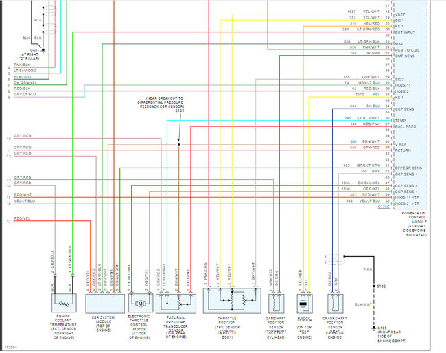

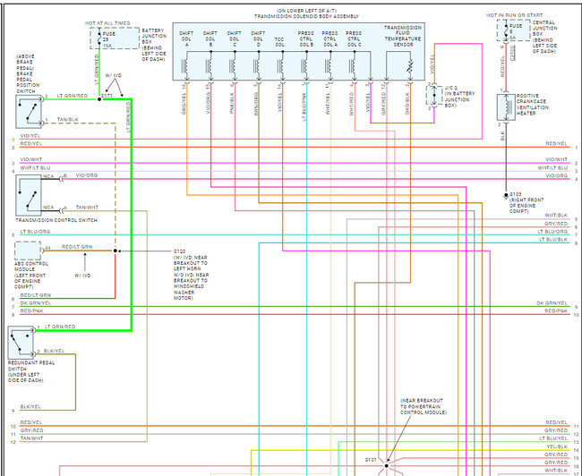

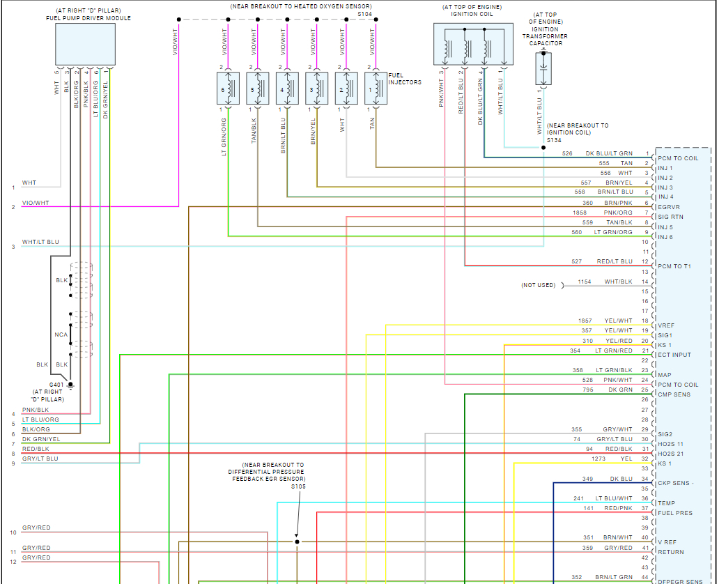

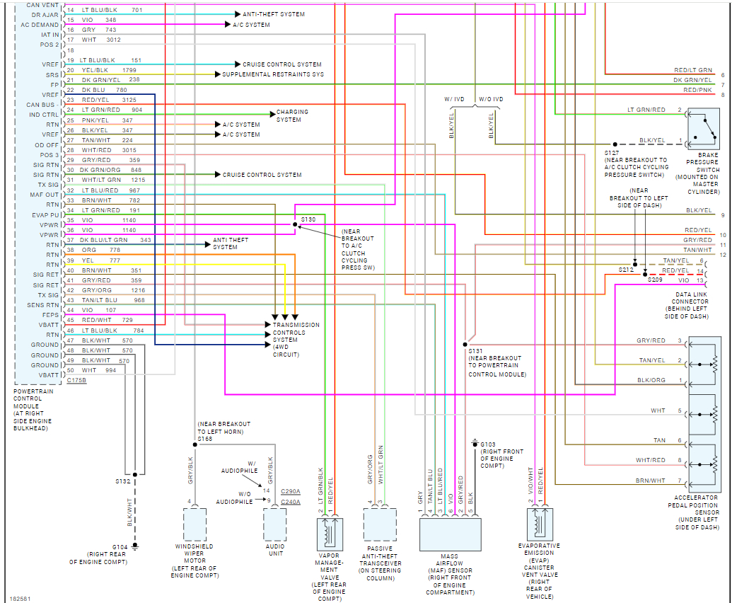

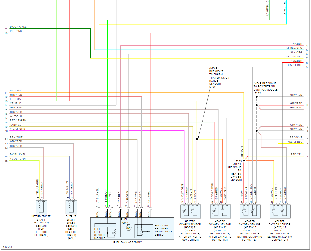

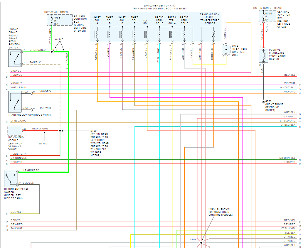

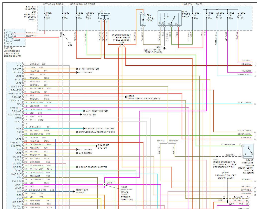

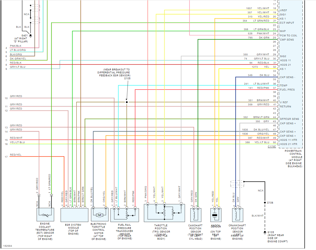

Thank you for the plans. I have to rewire the oxygen sensors because I have an error code P2195/P2197 and I noticed that the cables were all stripped at the connector and the probe cable goes into which PCM connector?
Dec 28, 2023 at 1:47 AM
  • 55,447 POSTS
Sure, here is a guide to help you test the connections and I have included the engine /PCM wiring diagrams which included the oxygen sensors.
Check out the images (below). Please upload pictures or videos of the problem so we can see what's going on.
