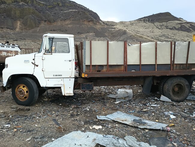

DSHJR
  • 11 POSTS
Would you like a pic of the engine or the truck?
Jun 1, 2025 at 5:48 AM
DSHJR
  • 11 POSTS
Picture of the truck.
Jun 1, 2025 at 12:20 PM
  • 55,402 POSTS
Okay, it sounds like the the fuel injector pump is going out. I need to say I am a automotive tech so I am a complete expert on larger trucks like this. I would look at the linkage for the throttle and make sure there are no fuel leaks.

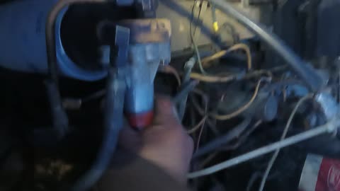

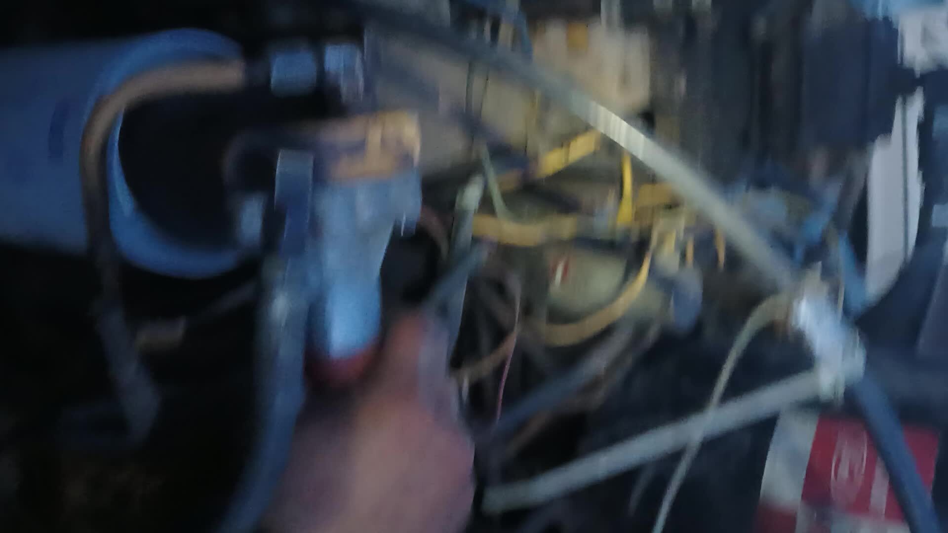

When I prime the fuel it does not keep the pressure for long it bleeds off quickly the and there is some fuel on top of the engine after I have tried to prime it a few times. When I bought the truck I noticed that there was a few bolts that were loose and tightened them up. But when I prime it I can hear something like it is bleeding off some where but I can't find where.. when the engine RPM is high and won't go down when I let off the throttle or go back up step back on it. And when it is not moving down the road it will idle fine for a long time until I step on it and release it quick then the engine will run rough and die and won't start back up until I reprime it again I will try to make a short video on what I am talking about today.
Jun 2, 2025 at 5:36 AM
DSHJR
  • 11 POSTS
Here the video sometimes it doesn't start up that easy like it did in the video.
Jun 2, 2025 at 2:32 PM
  • 55,402 POSTS
The fact that you need to prime it to get it started means the injection pump is going out or you have a hole or crack in the fuel line going to the fuel pump, I would check that first. Thanks for the video it helps.
Jun 3, 2025 at 3:53 AM
