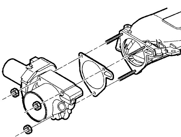

These cars are easy to fix so don't let them tell you stuff like that. With only 85k on the car it is still young, I would run the codes to see if any are present even if the check engine light is not on. This video can help
https://www.youtube.com/watch?v=LBCpCWEFnTg
If no codes are present I would replace the throttle body, this is a common failure which will cause the problem you are describing. Check out the images (below). Please upload an image or a short video in your response, so I can see what's going on.

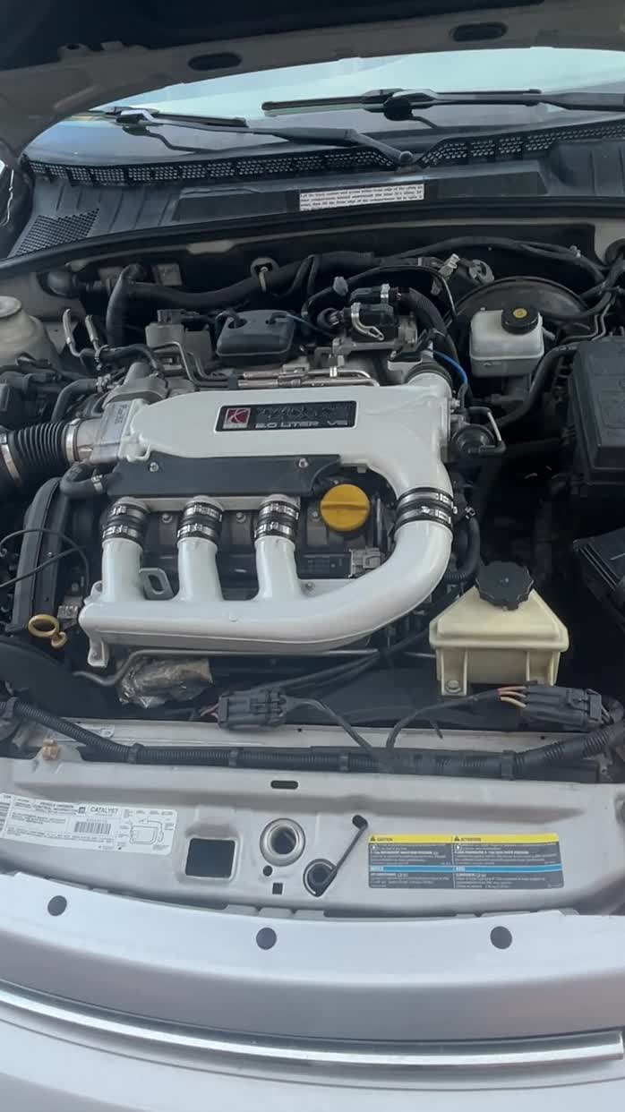

NICHOLAS PRISCO
This is another very short video from under the 2002 Saturn’s hood.

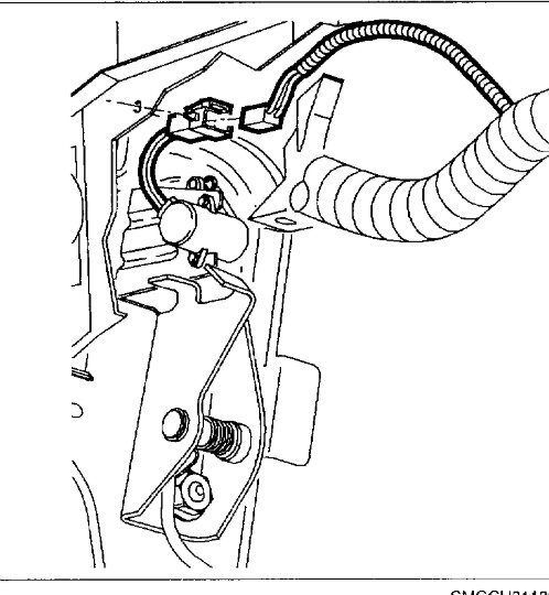

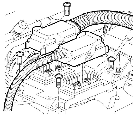

Thanks for the videos, so you did not say if the shops ran the codes and if there are any . If there are no codes the only things that can be wrong is the PCM or the throttle pedal position sensor which is at the throttle pedal itself but that should leave a code. You can get a preprogrammed PCM from these guys.
https://www.flashmastersecm.com/
Here is the location of the throttle pedal position sensor and PCM which is on the engine so you can try swapping it out. Check out the images (below). Please let me know what happens.
