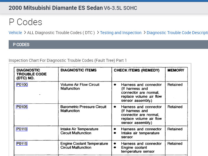

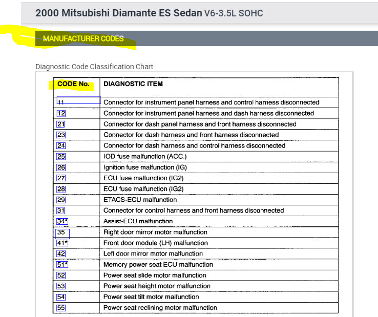

Where did you get the codes? None of them make sense to me either. The factory codes are two-digit numbers. The P codes will have the letter P followed by four digits. See pics below for examples. Note: I tried looking for a 72 and a 73. The list I have ends at 55.
Are these the only code numbers that were provided?
