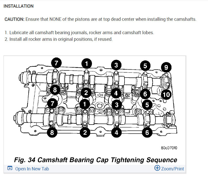

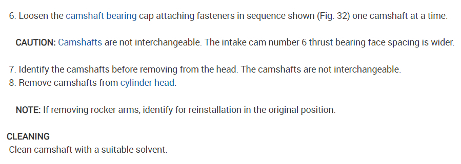

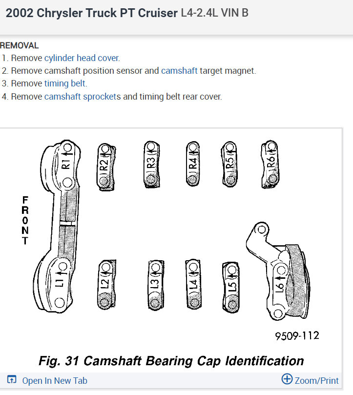

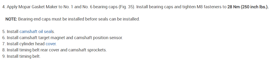

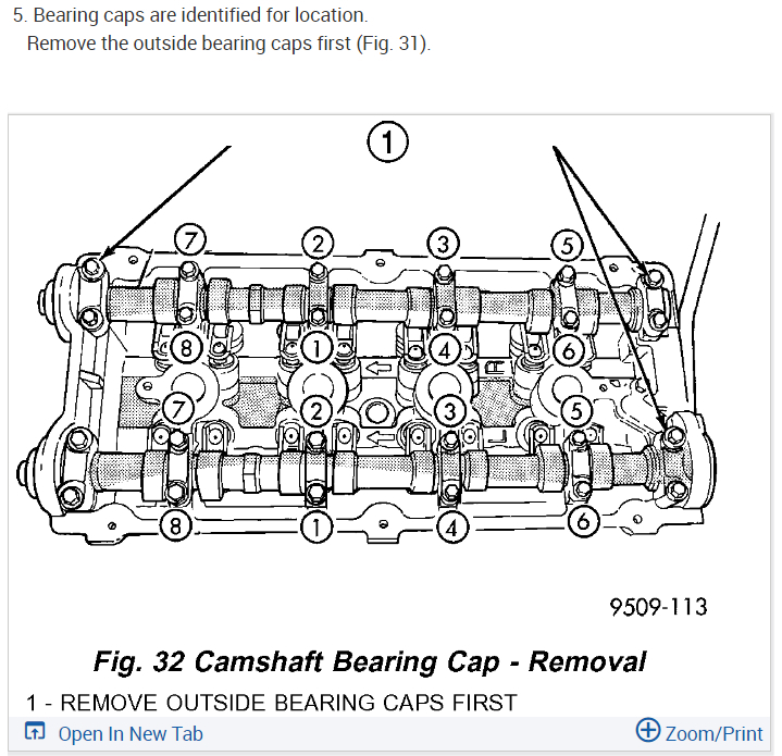

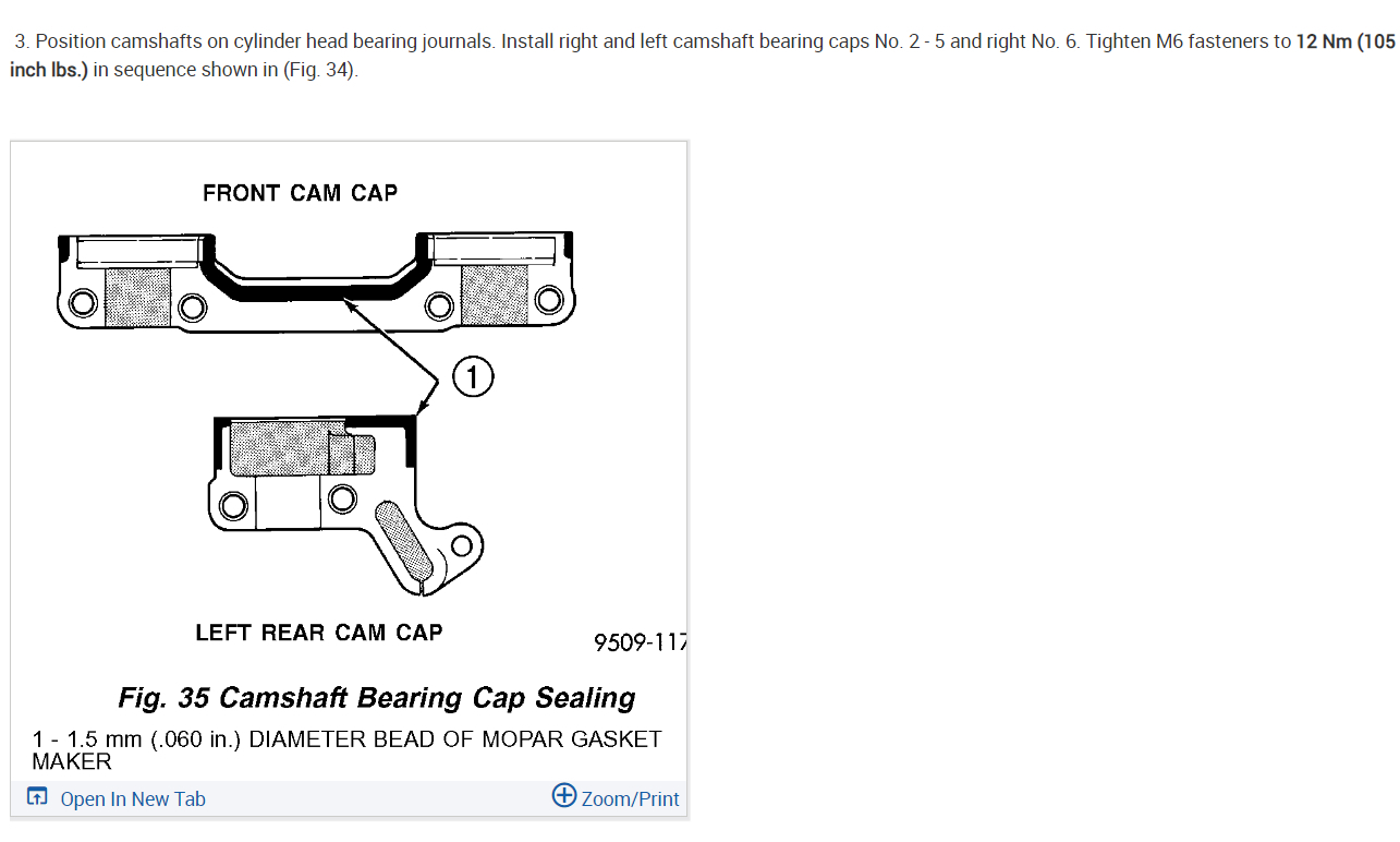

Camshaft bearings how do they go back on by using the numbers on top?
2002 CHRYSLER PT CRUISER
120,000 MILES
RAYMOND SANTISTEVAN
MEMBER
2 POSTS
Camshaft bearings reinstallation issue.
Jun 23, 2024 at 1:45 AM
Experienced Mechanic
55,688 POSTS
Sure, here is the camshaft removal and installation instructions with the torque specs and how the camshaft bearing caps are assembled. Check out the images (below). Let us know if you need anything else.
Images (Click to enlarge)
