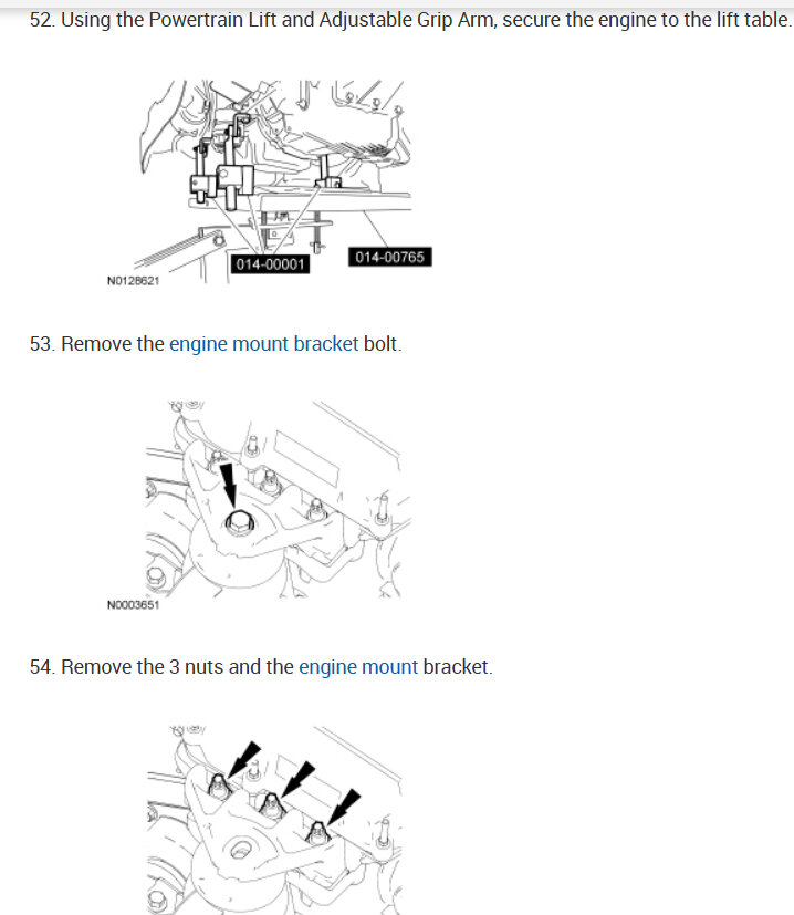

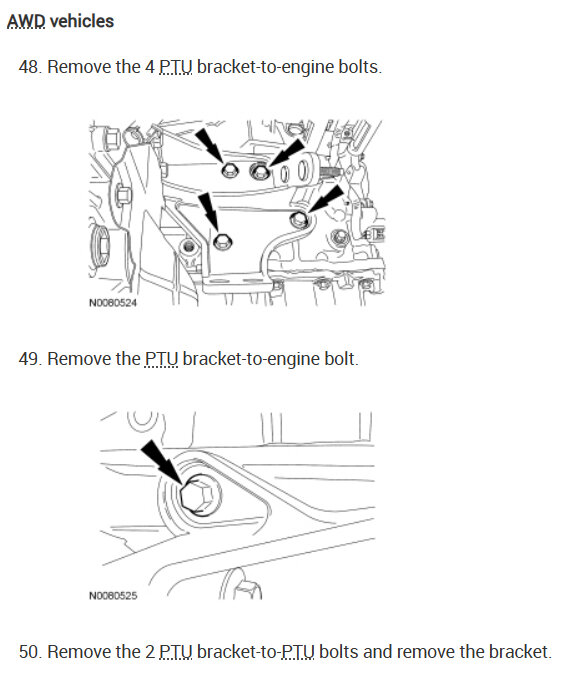

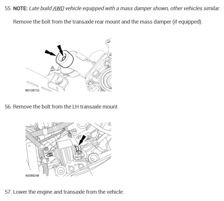

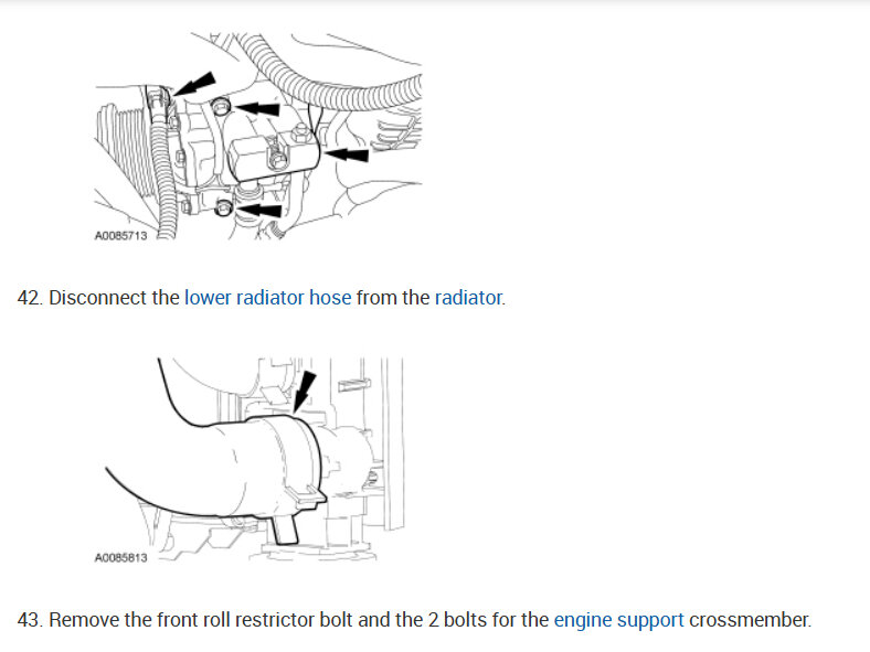

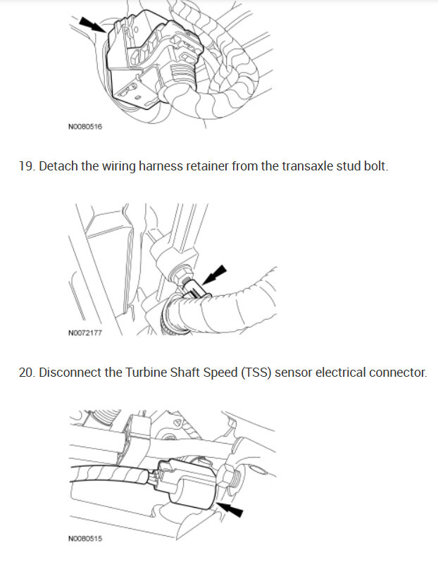

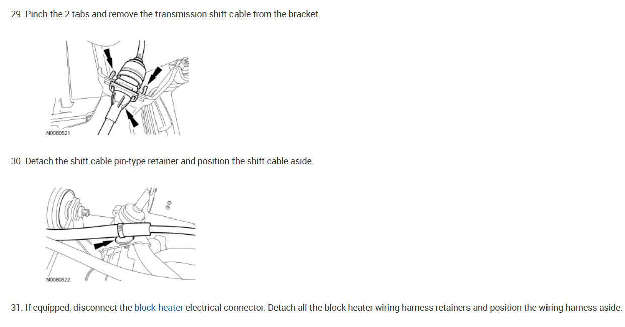

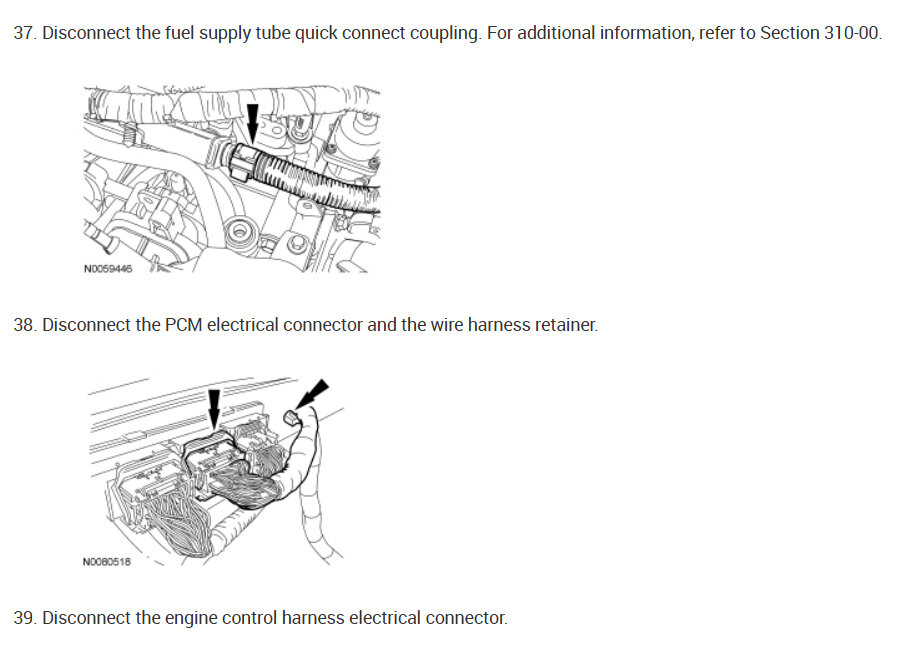

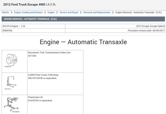

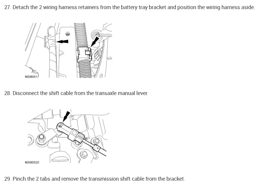

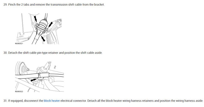

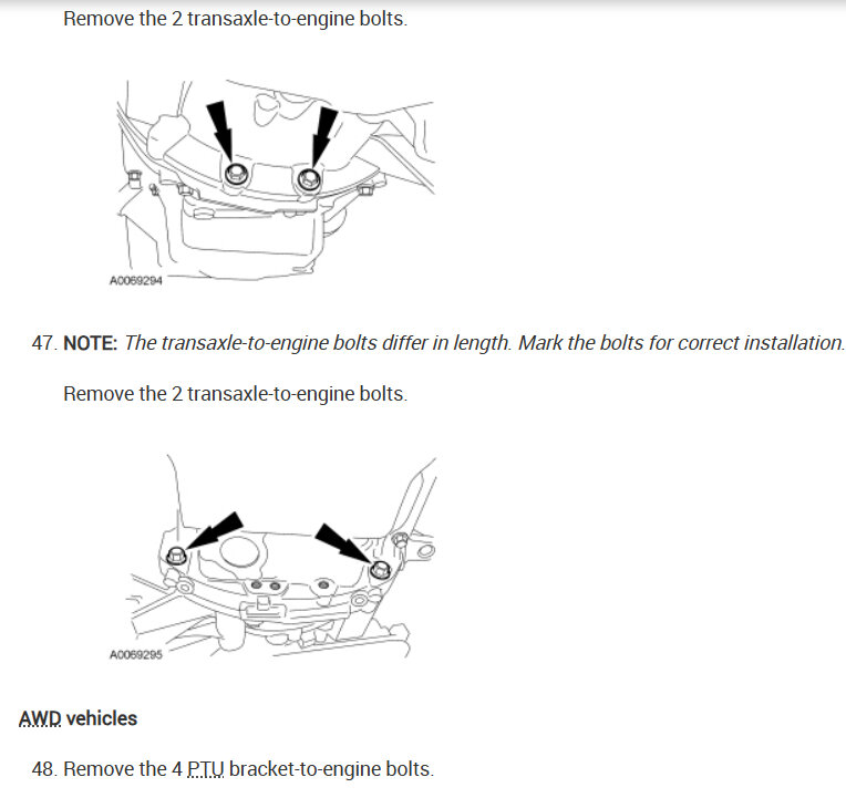

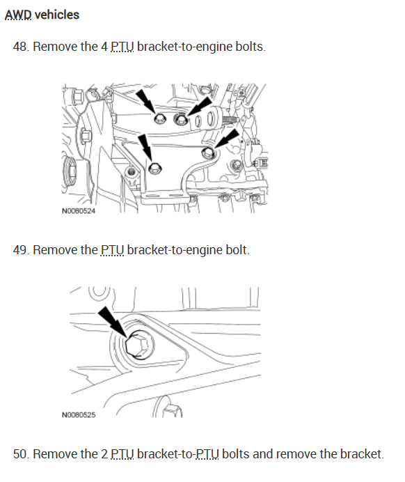

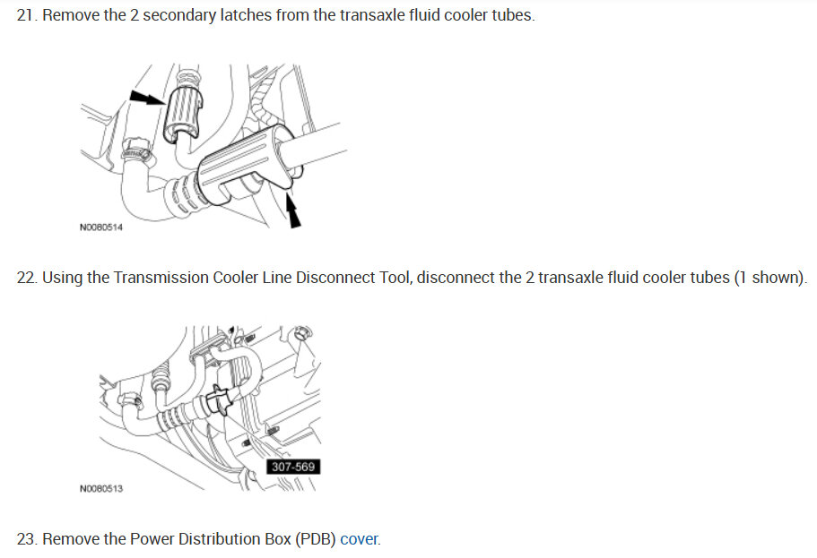

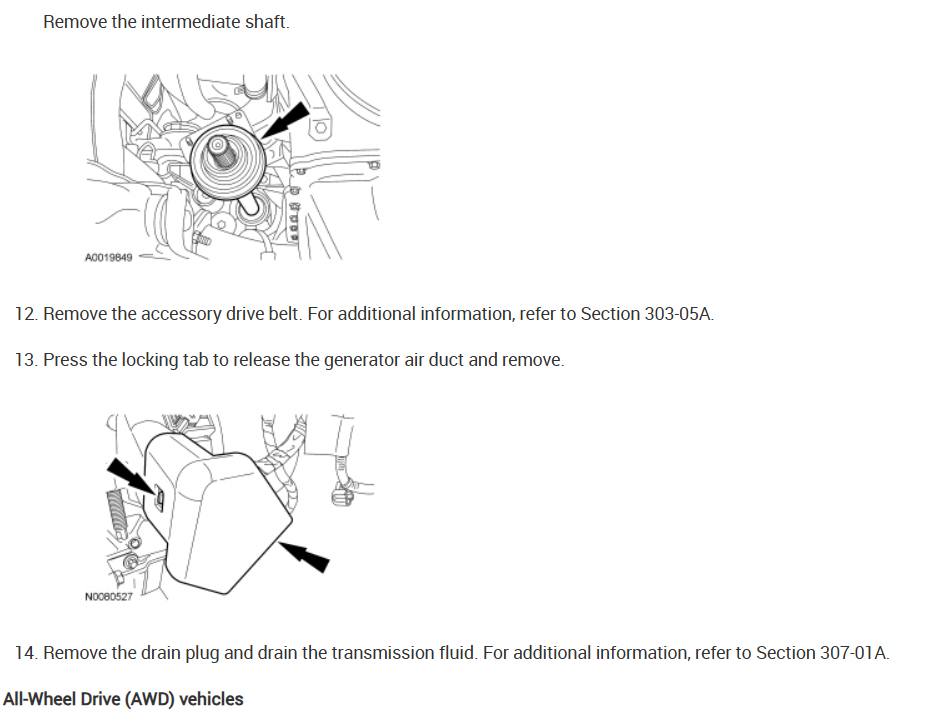

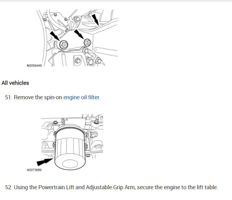

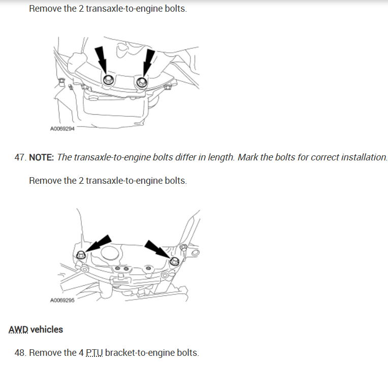

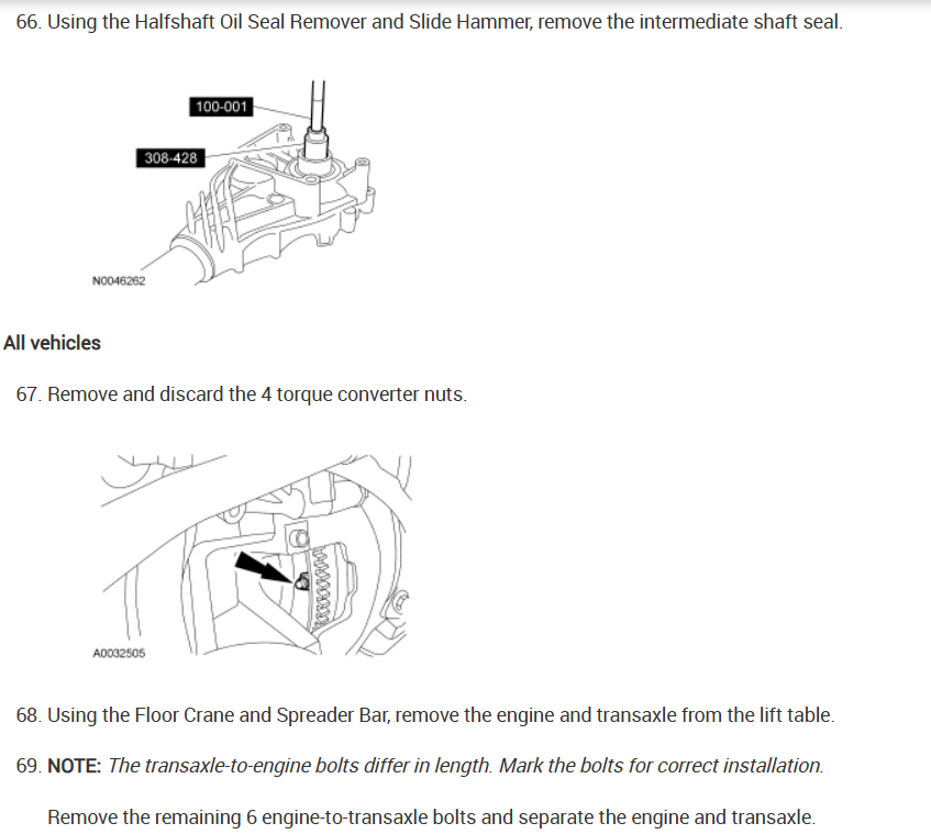

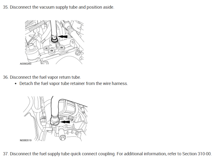

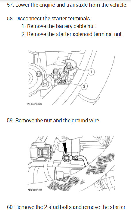

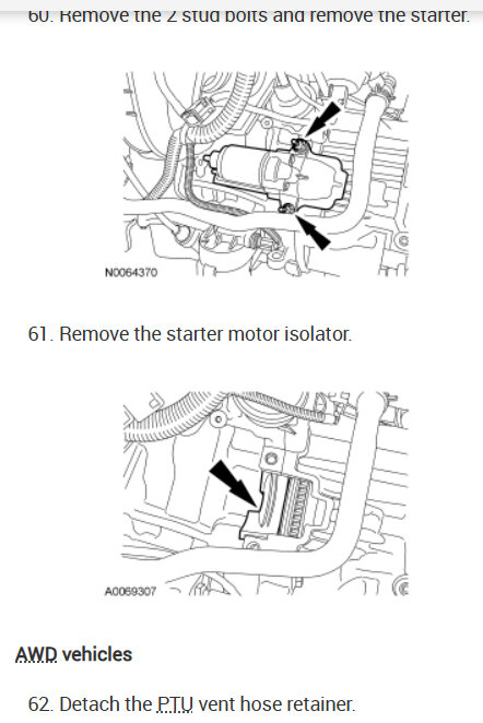

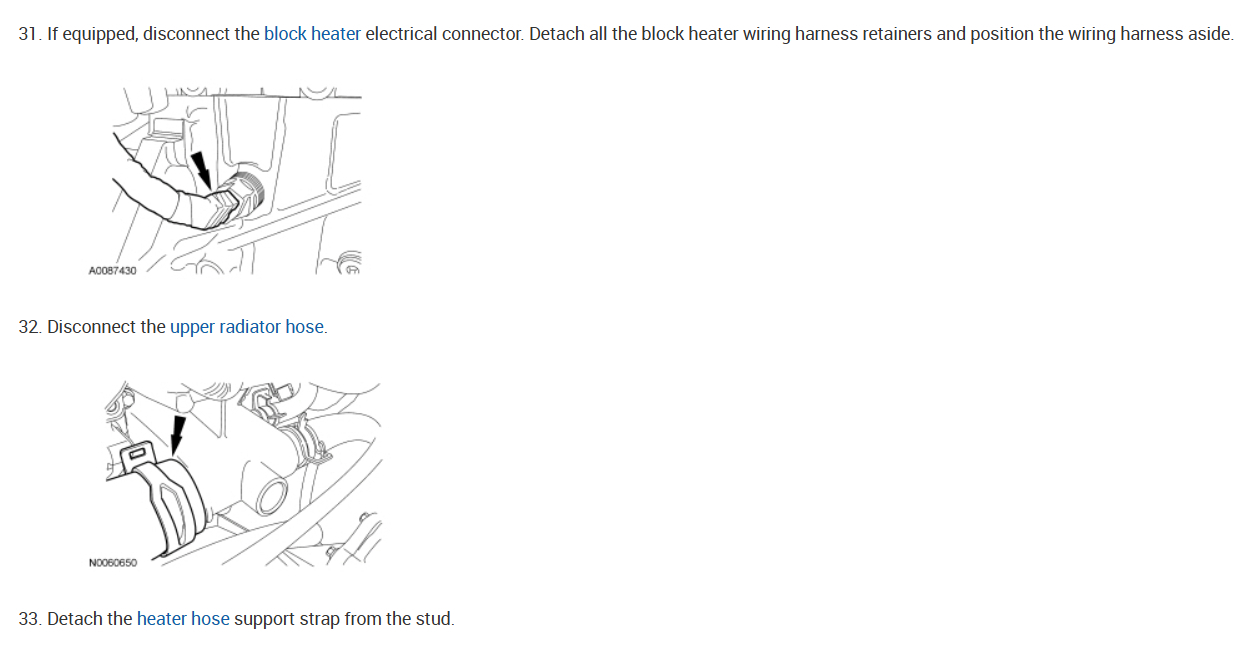

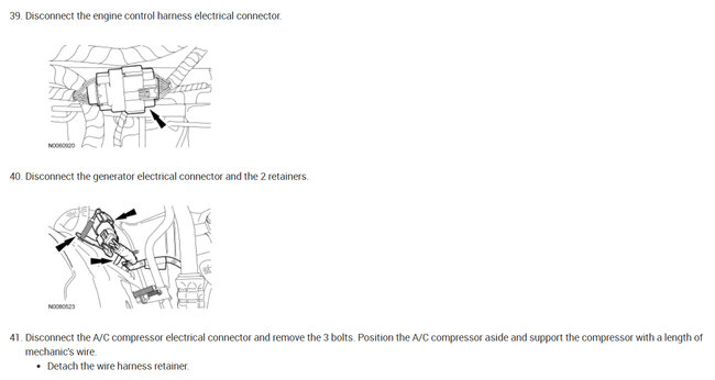

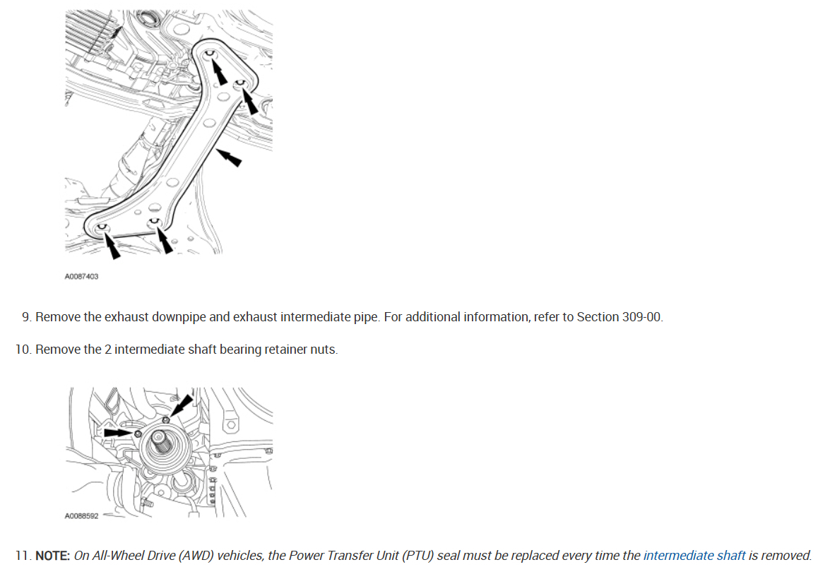

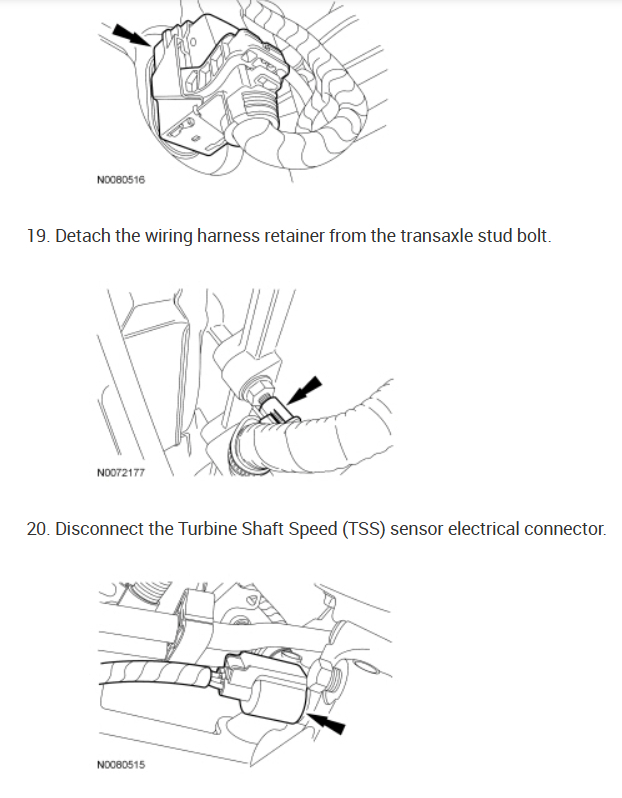

Step by step engine removal guide needed.
Jan 6, 2025 at 2:20 PM
  • 55,433 POSTS

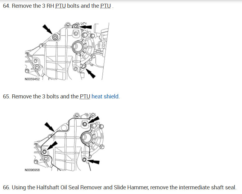

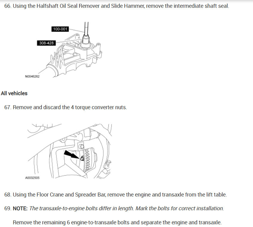

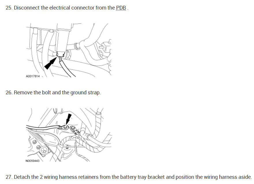

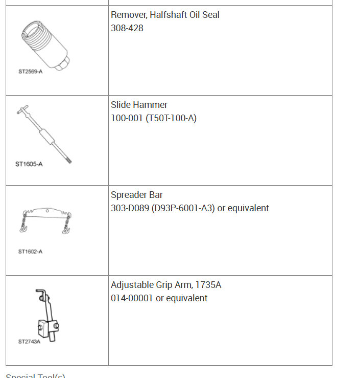

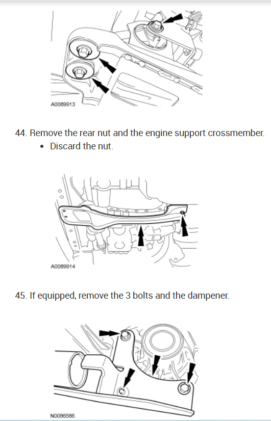

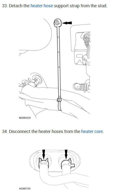

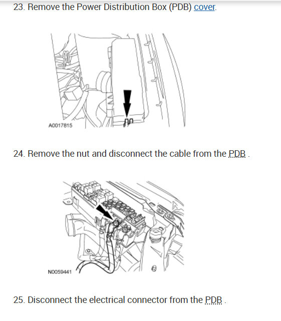

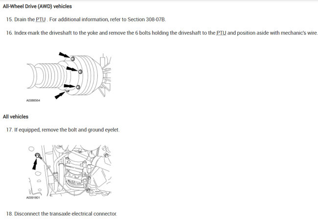

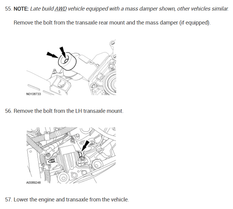

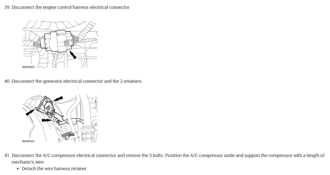

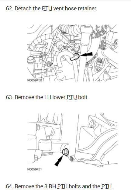

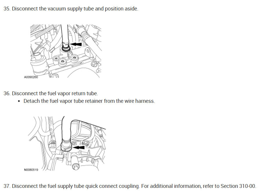

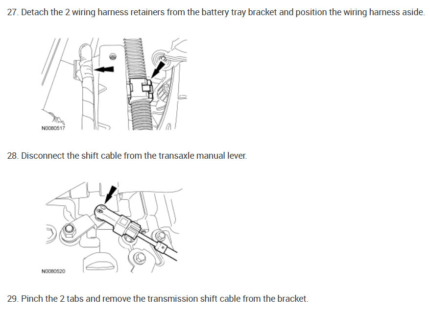

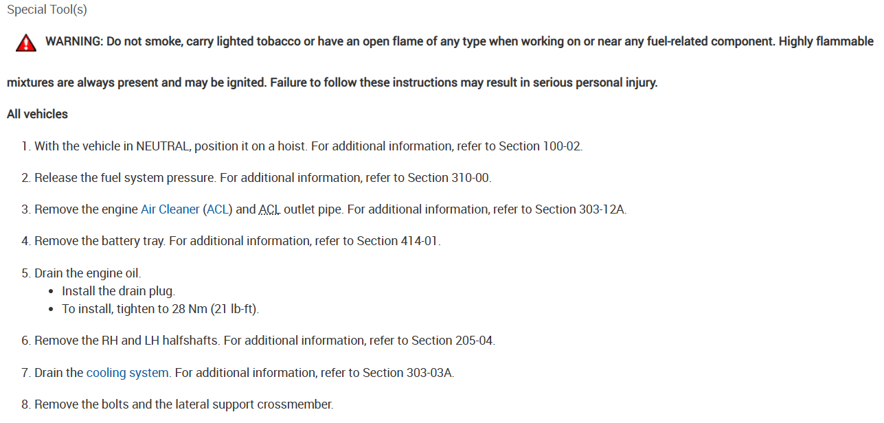

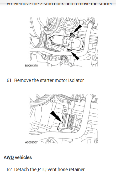

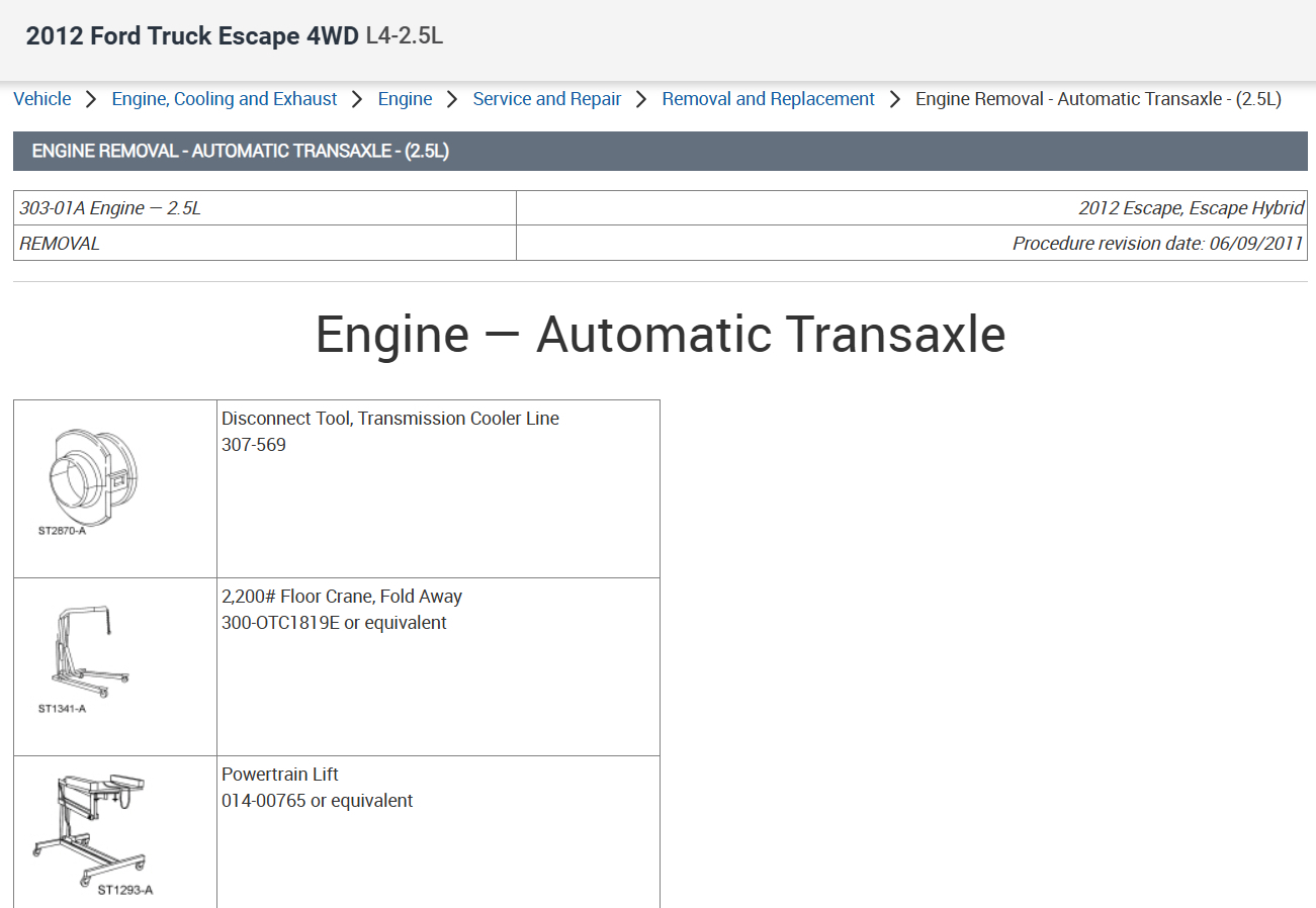

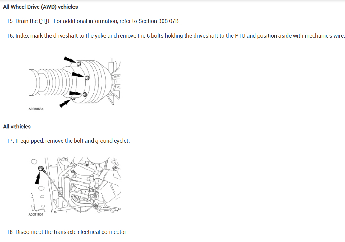

You will need some special tools and an engine hoist, start by removing the battery and drain the engine oil and coolant from the system, I like to remove the radiator next, so it does not get damaged. Also, vacuum down the AC system which will need to be recharged.
This video will help:
https://www.youtube.com/watch?v=4EqdrBVb0sY
Here are the step-by-step instructions which included the AWD version which you can just skip the steps for. Go slow and don't take any chances with the engine or transmission there are heavy and can cause injury if not handled correctly. If you run into a situation you are unsure of please get back to me with an image or short video. Check out the images (below).
