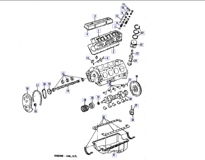

My engine blew up want to replace it with different engine. What year of engines can I get to replace it.
Aug 11, 2018 at 2:32 PM
Good evening.
The 350 motor block is the same from 1987 to 1995.
Even if you got another year engine, you would need to strip it down to a long block and change everything from your engine to the donor motor.
Will you be doing this yourself?

No, I will be hiring it done. Could I pull the whole motor out and replace with a 2013 motor? I still have to use the block.
Aug 11, 2018 at 5:34 PM
The 2013 is totally different. It is a fuel injected engine with coil over plugs.
If you wanted to do that, you will need complete engine assembly plus the wiring harness from the donor vehicle. It will then have to be adapted to your van which will be extremely expensive. You will also need a custom shop to perform this.
