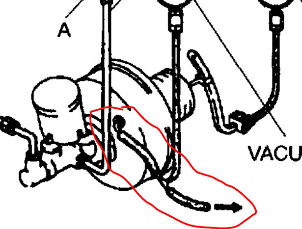

The car runs and stumbles when you put the brakes on.
Feb 24, 2020 at 7:10 PM
  • 110,194 POSTS
If it only happens when you come to a complete stop, I need to know if it has an automatic transmission. If it stumbles anytime you apply the brake regardless of speed, it sounds like an engine vacuum leak that can be directly related to the power brake vacuum booster.
Here is a link that explains how to find a vacuum leak:
I attached a pic of the booster below and circled the vacuum hose. Check it for damage and make sure it is properly attached.
Feb 24, 2020 at 7:24 PM
JOHNNYP43
Car cranks up and idles and then shuts off.
Feb 24, 2020 at 7:32 PM
  • 110,194 POSTS
Are you able to keep it running if you keep pressing the gas or is it only when you apply the brakes?
