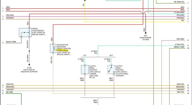

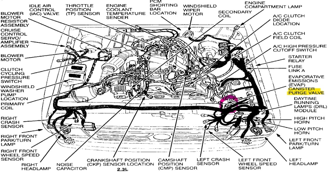

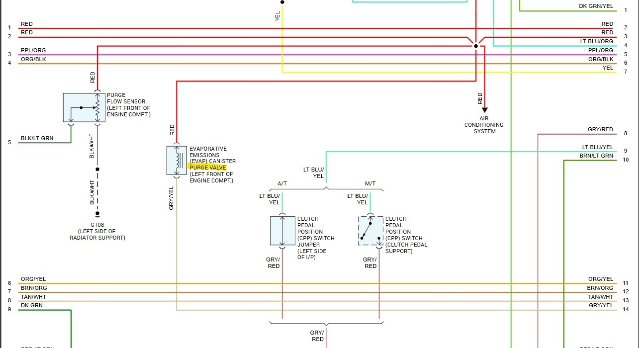

On other thing you can check is the Canister Purge valve, if its stuck open due to a charcoal canister failure, the purge valve can actually draw fuel threw the Evap vapor system into the intake manifold, Ill try to find a picture of the purge valve for you,. It should be on the driver side of the engine compartment, a 2-wire purge solenoid. With a red wire and a grey with yellow stripe wire.
Jan 31, 2025 at 5:58 AM
AL514
  • 5,610 POSTS
Service info for the location of the purge valve solenoid is terrible, to find it you'll have to go by wire colors, but it should be closed when its unplugged and you shouldn't be able to blow any air through it. If you find that it's stuck open, and you might even find gas in the vapor line/hose coming to the purge valve, that might be the issue. But with a hunting idle, it means the ECM is able to control the idle with the IAC valve, if there is a vacuum leak large enough to where the ECM is closing the IAC fully due to excessive air coming into the engine you can end up with the idle up and down like that.
