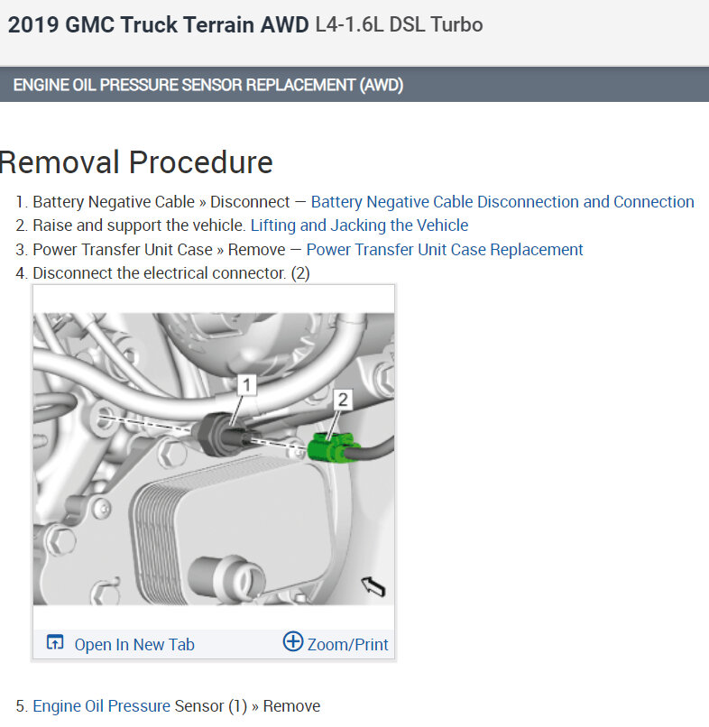

Oil pressure sensor location?
Oct 8, 2024 at 12:36 AM
Experienced Mechanic
55,594 POSTS
The oil pressure sensor is right above the engine oil cooler near the A/C compressor. Check out the images (below). Let us know if you need anything else.
