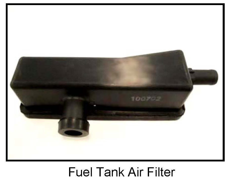

I suspect there is an issue with the fuel tank air filter. Over time, the filter gets dirty and prevents air from entering the fuel tank. If there is no air movement, fuel struggles to enter or exit the fuel tank.
I found a technical service bulletin (TSB) on this problem. It includes the directions for replacement. Before you do this, contact a dealer and see if it was made into a recall. I honestly can't remember if it was a recall or simply a TSB.
Here is the TSB. The pics attached below correlate with the directions.

This Bulletin provides the procedure to replace the Fuel Tank Air Filter in 2003-2004MY Kia Sorento vehicles. Over time, the fuel tank air filter accumulates dirt, which can restrict airflow. If the fuel tank air filter is not replaced during regular maintenance the restriction of airflow will eventually reach the point where the vehicle may experience fueling difficulties. Kia is also providing an owner's manual insert for the 2003-2004MY Kia Sorento identifying that at a minimum the fuel tank air filter is to be replaced every 30,000 miles.
pic 1

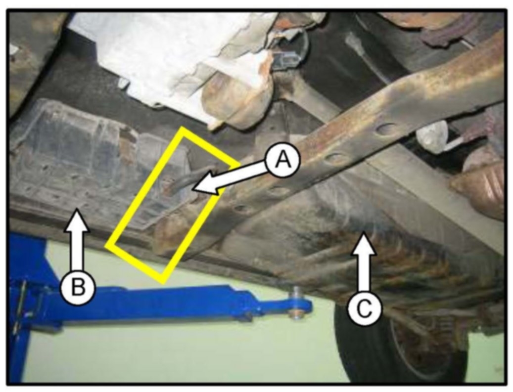

Raise vehicle up on a lift.

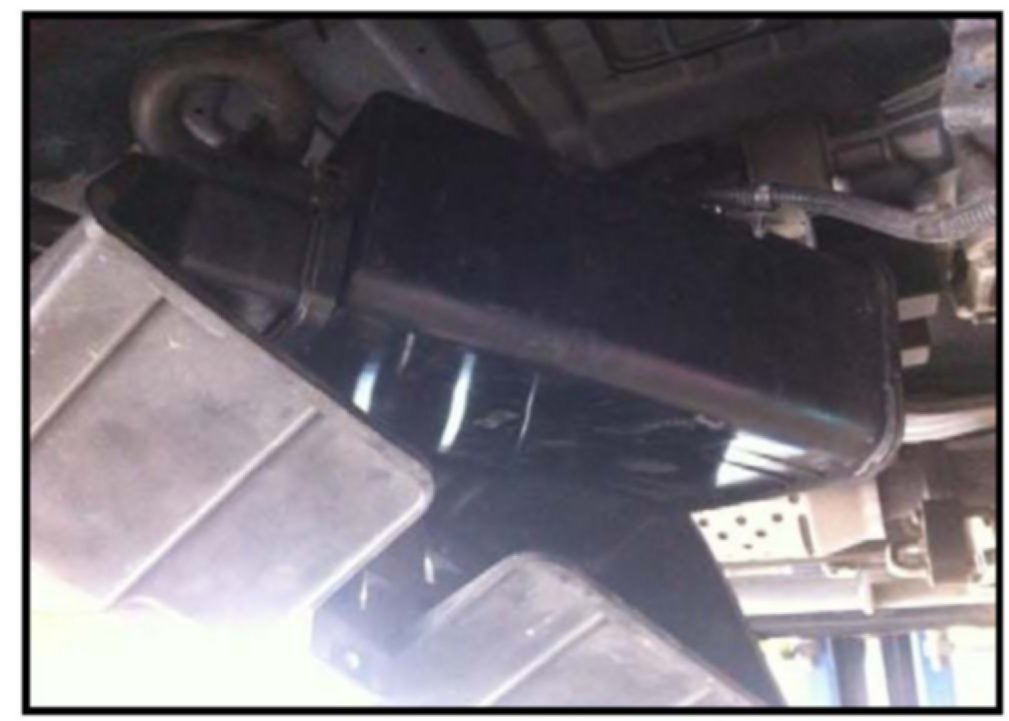

pic 2

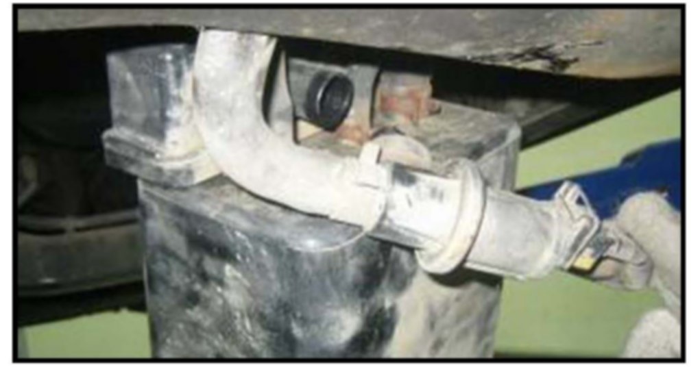

Locate the fuel tank air filter (A).
B: Canister housing assembly
C: Fuel tank

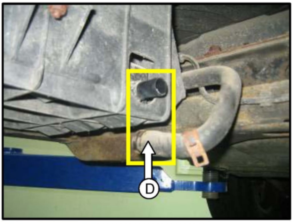

pic 3
2. Move clamp away from hose end, and disconnect the air hose (D) from the fuel tank air filter as shown in the photo.

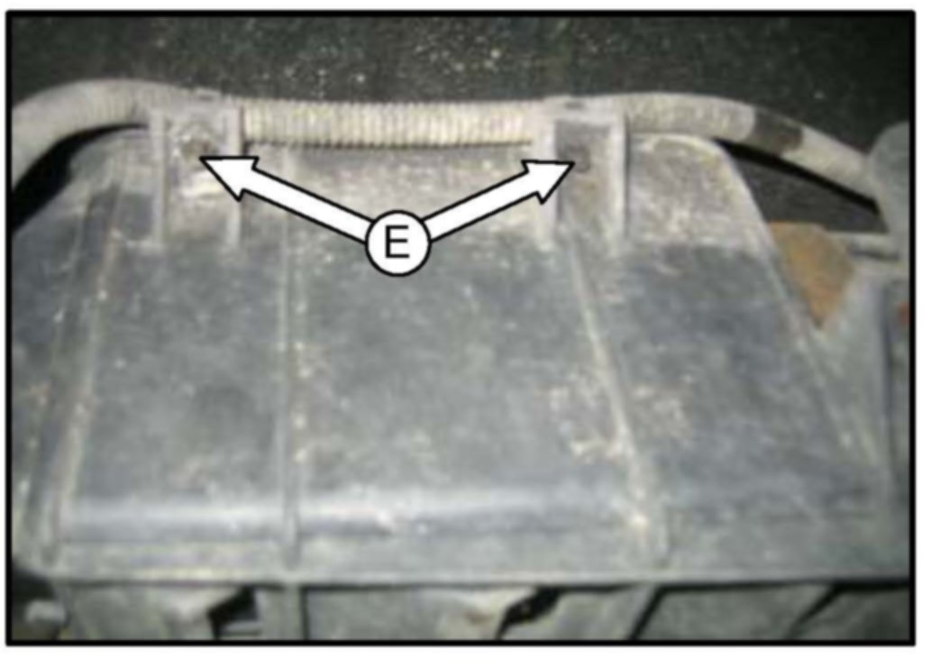

3. Remove wiring mounting clips (E) from canister assembly.

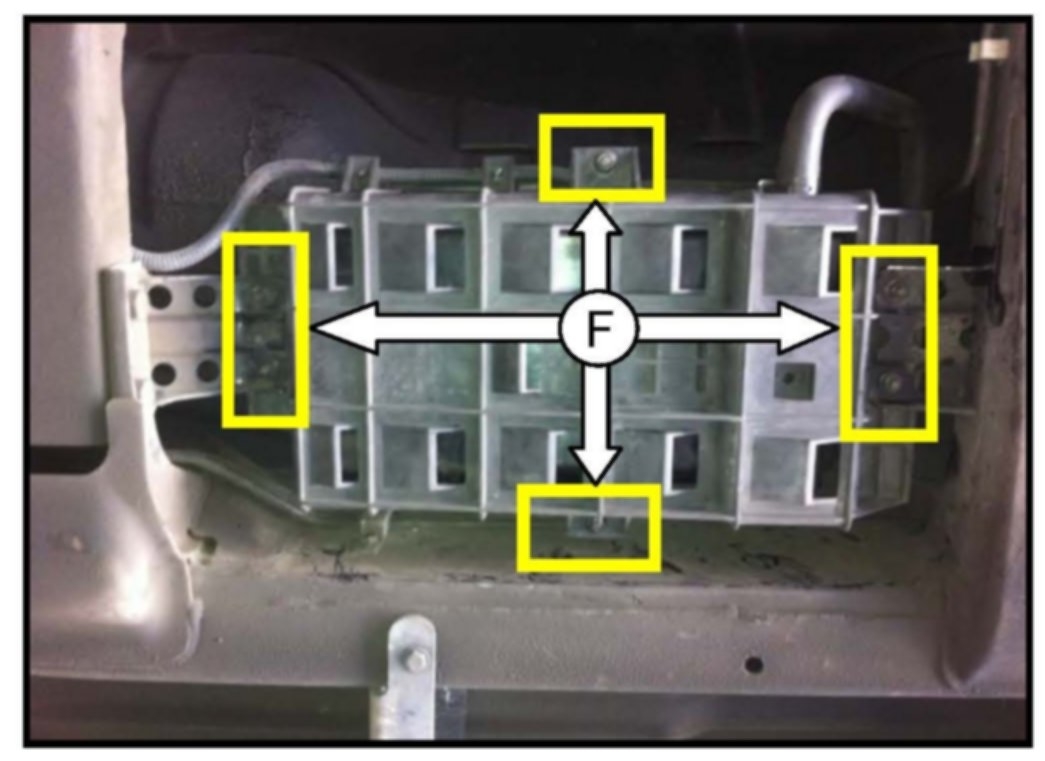

4. Remove the six (6) mounting nuts (F) that retain the canister assembly.
NOTICE:
Support the canister as necessary. Do NOT let the canister hang from the wiring harness or evaporative hoses.

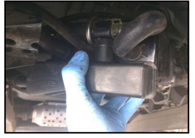

pic 6

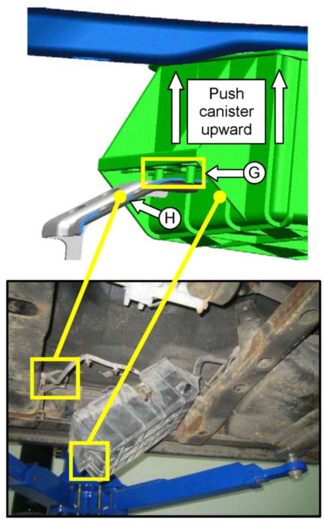

5. Push the canister assembly upward to remove the threaded studs (G) from bracket (H) as indicated in the photo on the right; then pull the canister assembly downward.
pic 7
6. Lower canister assembly and mounting bracket enough to separate the bracket from the canister assembly and fuel tank filter.

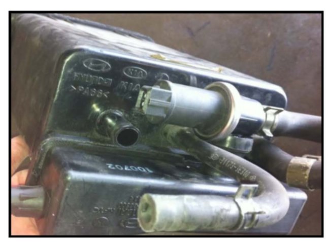

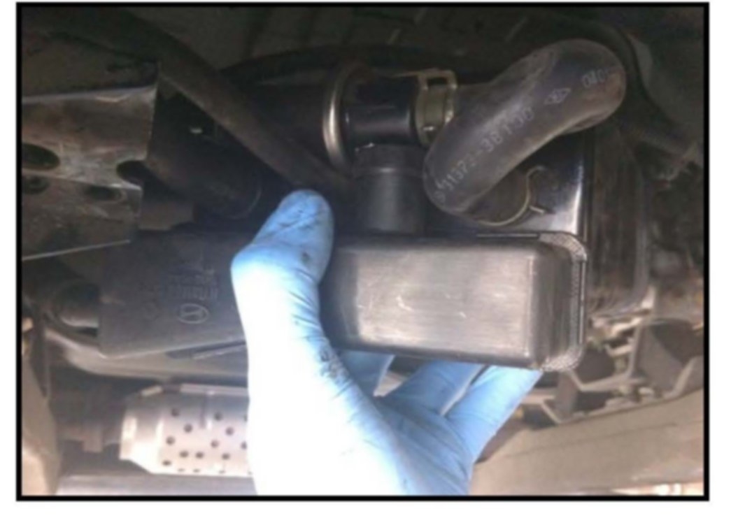

8. Remove the CC (Carbon Canister) and Fuel Tank Air Filter assembly. Remove the Fuel Tank Air filter by pulling straight up from the base of the filter.
NOTICE:
Ensure to properly align the filter with the CC before pressing into position.
pic 10
9. Install new Fuel Tank Air Filter and re-install the evaporative hoses and clamps in reverse order of removal. Re-install the canister/CCV and filter into the retaining bracket. Connect the electrical connector to the canister close valve - then install the canister assembly to the vehicle. Torque the fasteners to 84 inch lbs (10-12 Nm).

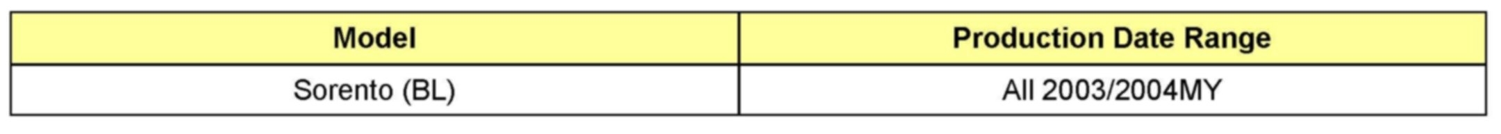

AFFECTED VEHICLE PRODUCTION RANGE
pic 12

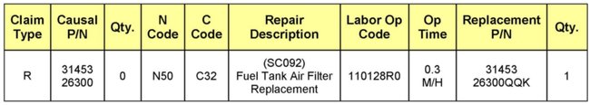

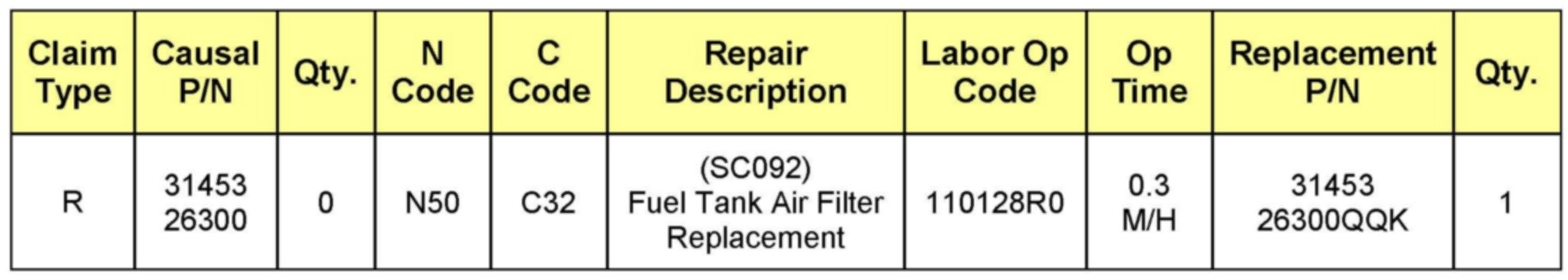

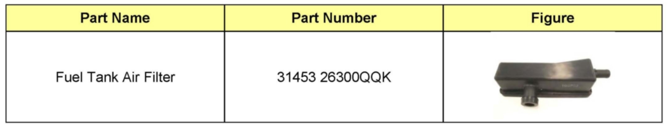

REQUIRED PART
pic 13
WARRANTY CLAIM INFORMATION
