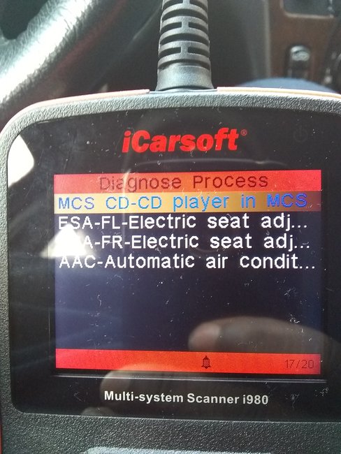

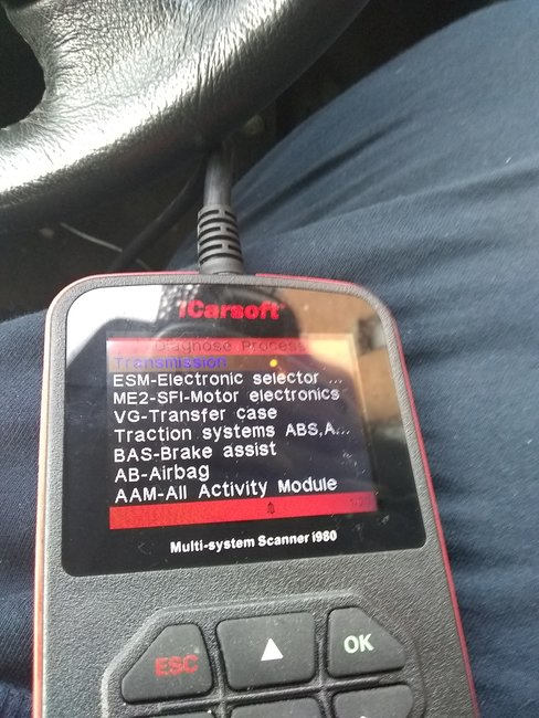

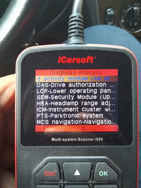

Good morning. I hooked the icarsoft up to the car and don't understand what I'm reading.Can you please tell me where I should start if you are familiar with this scanner with what's relevant to my issues? Thank you.
Nov 18, 2019 at 12:13 AM
Can you take pictures of the screen so I can see what you are seeing? I am not familiar with that scanner but I am sure I can help you figure it out.

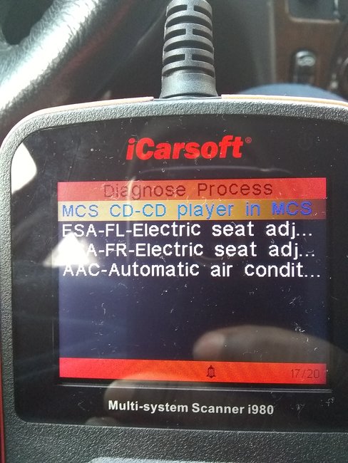

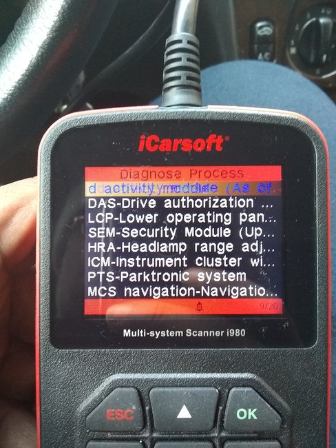

I uploaded a video on exactly what I was talking about with the vehicle.There are no lights on the dashboard.There are also pictures of the icarsoft start up menu because I don't know how to approach the issue I have.
Nov 18, 2019 at 10:36 PM
Okay. The video helps but first the tool is just showing you a list of all the modules that are on the vehicle. However, if the issue is that when you rev the engine in park it gets to 4,000 RPM's and then you hear is surging? Is this correct? When you said you were accelerating I thought you meant when the vehicle was picking up speed. But you mean the engine speed is increasing but you are sitting still and it revs up and then kind of surges or bounces?
