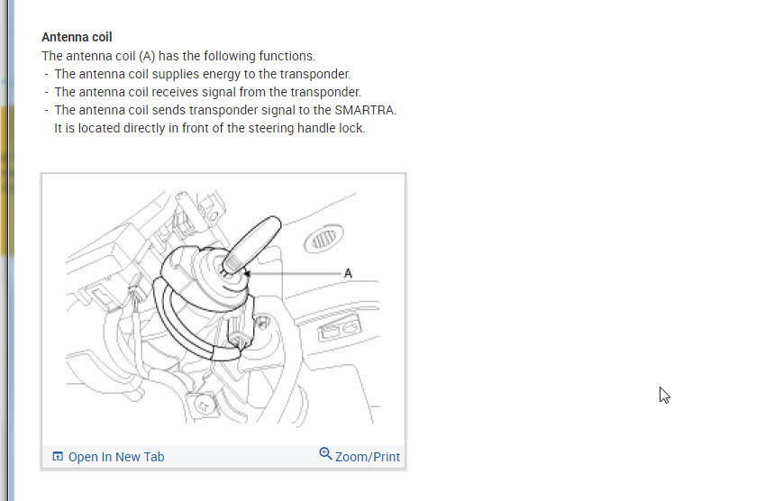

Okay, so the engine I’m wanting to try and put in the 1993 Toyota Corolla is out of my 2009 Hyundai Elantra. I mean engines look almost identical.. so even if I was to put the engine and transmission in. What about the computer and what nots? I was thinking swap the whole wiring harness as well from my Elantra if that would work? Only difference I know of is the Elantra has electric power steering and the Corolla doesn’t. Reason i'm wanting to do this is the Elantra’s totaled but engine and transmission works great the Corolla's has a blown engine so it’s no rush just trying to be more cost efficient if it’s worth it...
Dec 19, 2020 at 7:08 PM

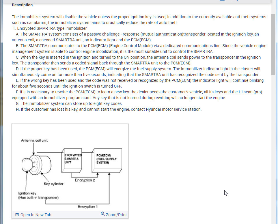

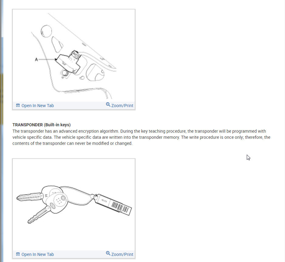

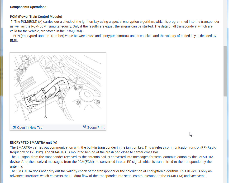

That would be a good candidate then but I would recommend before you get too far is pull them both out and sit them next to each other. Then you can really compare mounting locations and other possible fitment issues.
Clearly we don't have any information about this being done and it may have never been done but again, mounting it is the hardest first step. Once you get it mounted in there, using all the other engines harnesses and modules would be required. Don't forget about the immobilizer system because the PCM will not be unlocked if you don't move that over as well.
I attached below the detail about the immobilizer you will need to move.
