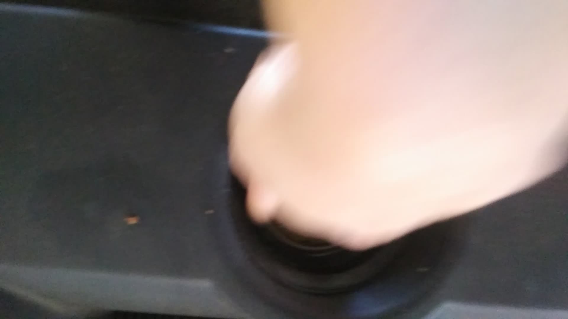

My ex put sugar In my engine at the oil cap . What do I do? Is my car fixable?
Jul 30, 2019 at 1:27 AM
  • 55,412 POSTS

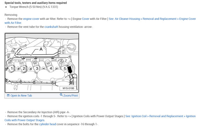

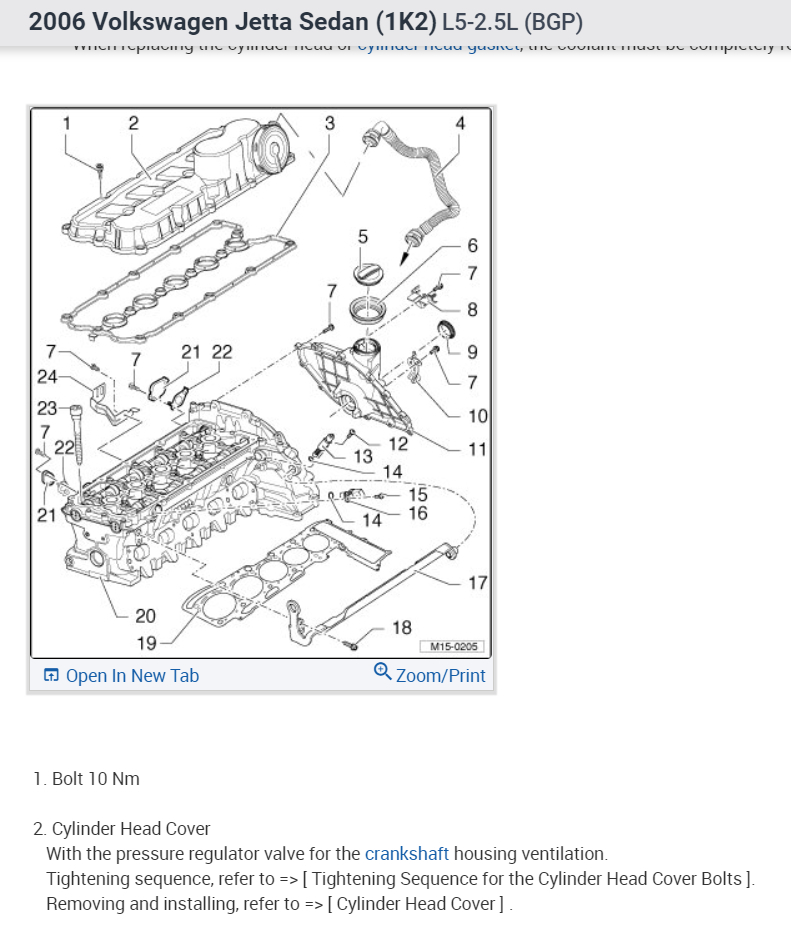

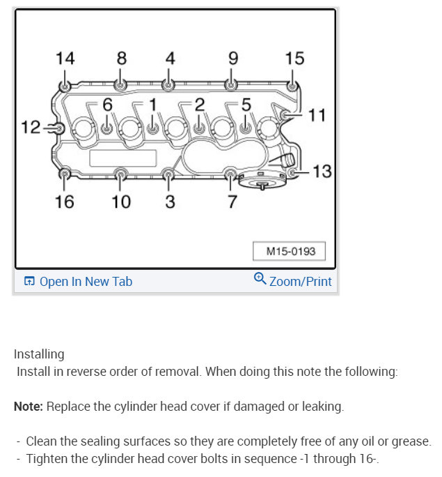

Please do not start the engine we must get it cleaned out before you run the engine by removing the valve cover. Here is a guide to help you with diagrams instructions for your car below:
https://www.2carpros.com/articles/replace-valve-cover-gasket
Use a vacuum cleaner to get the sugar out of the engine, small spoon etc. Get all that you can out. Can you please shoot a quick video with your phone so we can see what's going on? that would be great. You can upload it here with your response. Check out the diagrams (below). Please let us know what happens.

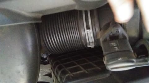

Here is the video:
Jul 30, 2019 at 8:48 AM
  • 55,412 POSTS
O boy, that's bad, do not run the engine, lets remove the valve cover to vacuum the sugar out. Use a small brush etc. Sorry about that. Good job finding the issue before you ran the engine. Please let us know how it goes.

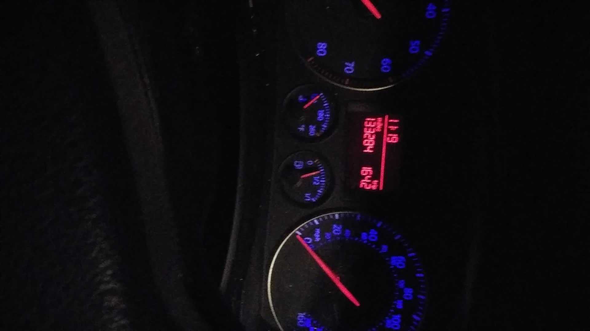

My engine light was on. I drove it for two days. It drove just fine. On day three my battery light came one and seconds later my car shut off. I tried jumping it but it won't start. All the the lights on the dash are coming on like normal when your turn the key. It act like it wants to start but can't. I have the wrong oil dipstick in there until I can get the right one. Would that have sensor-ed the car to shut off?
Aug 6, 2019 at 12:24 AM
  • 55,412 POSTS
No, can you please shoot a quick video with your phone of the engine cranking over so we can see what's going on? that would be great. You can upload it here with your response. I want to hear if the engine is hurt so we can continue.
Aug 6, 2019 at 3:38 AM

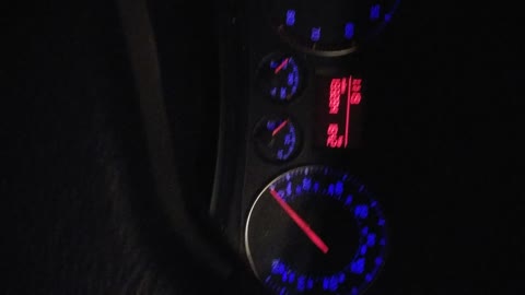

This is what's happens.
Aug 6, 2019 at 3:43 PM
  • 55,412 POSTS

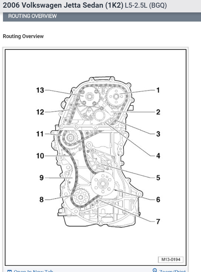

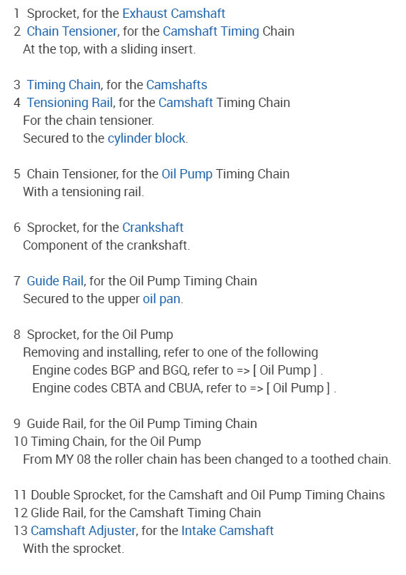

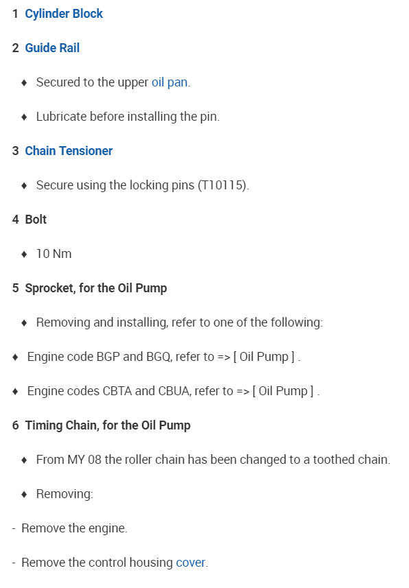

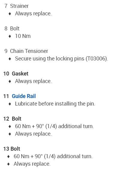

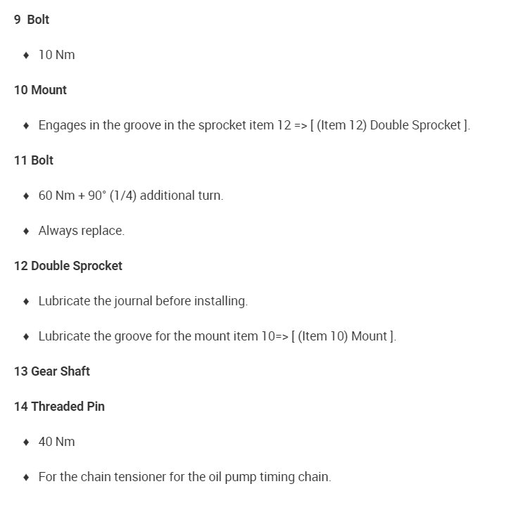

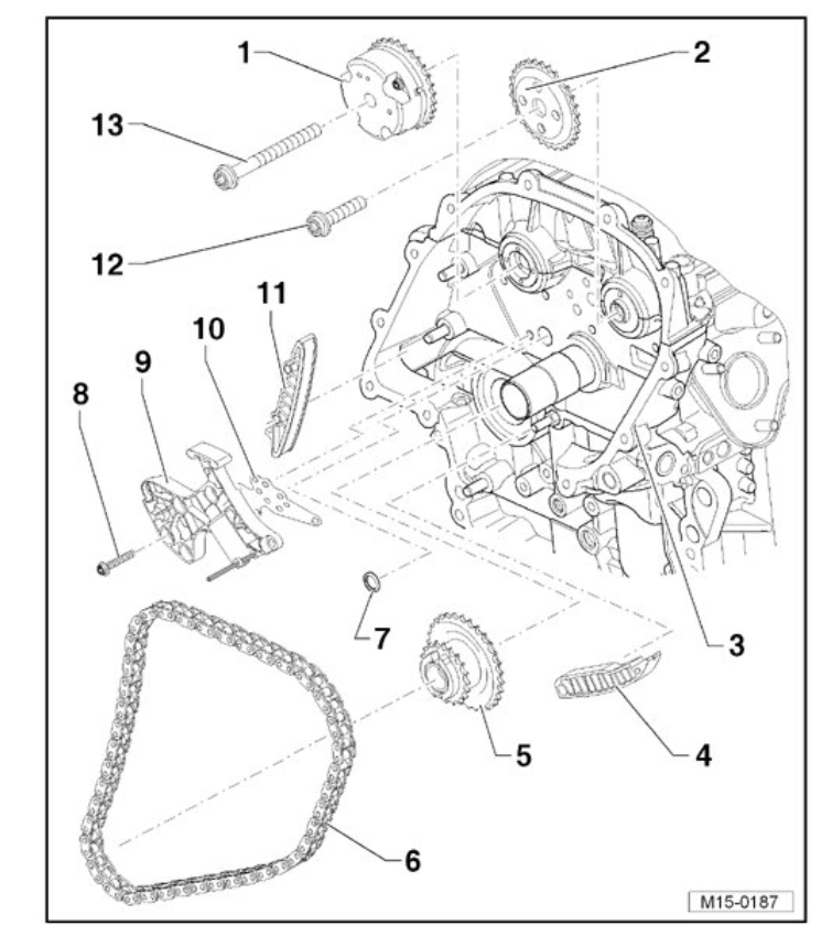

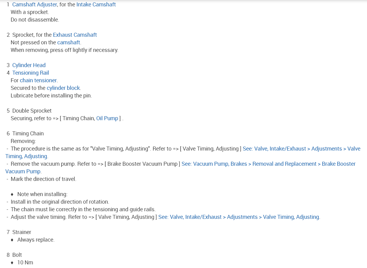

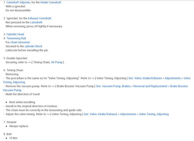

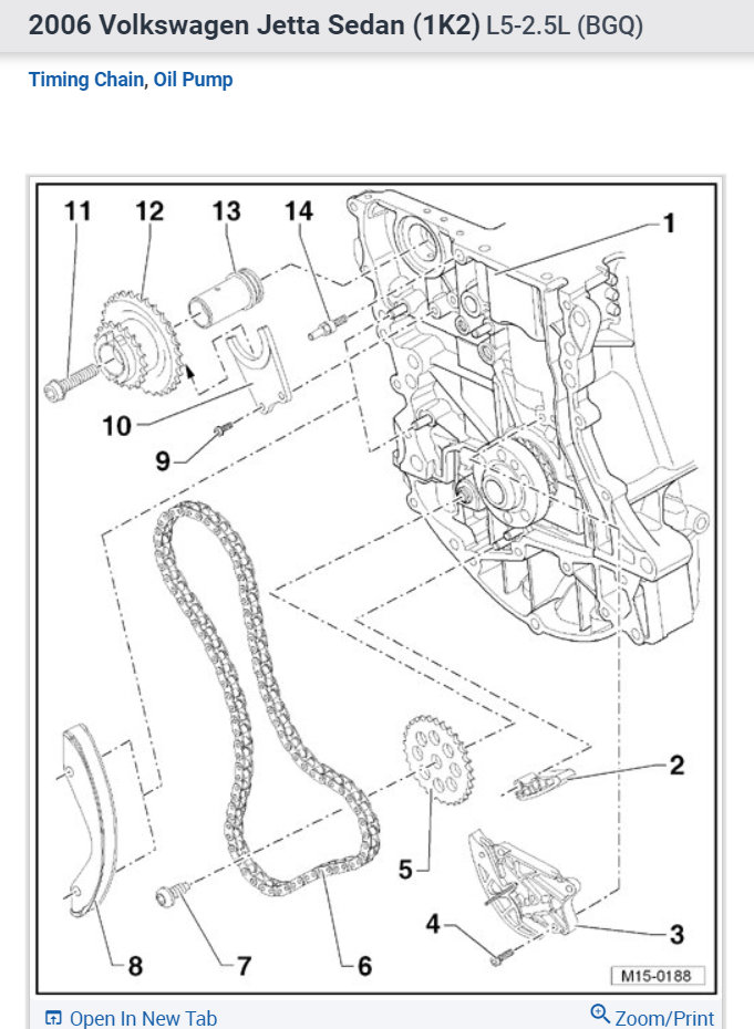

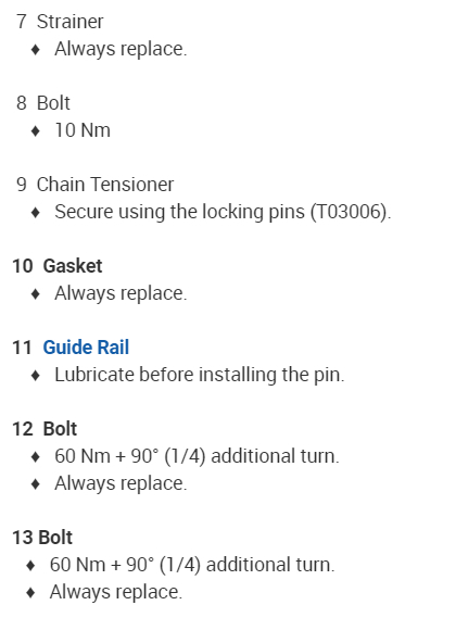

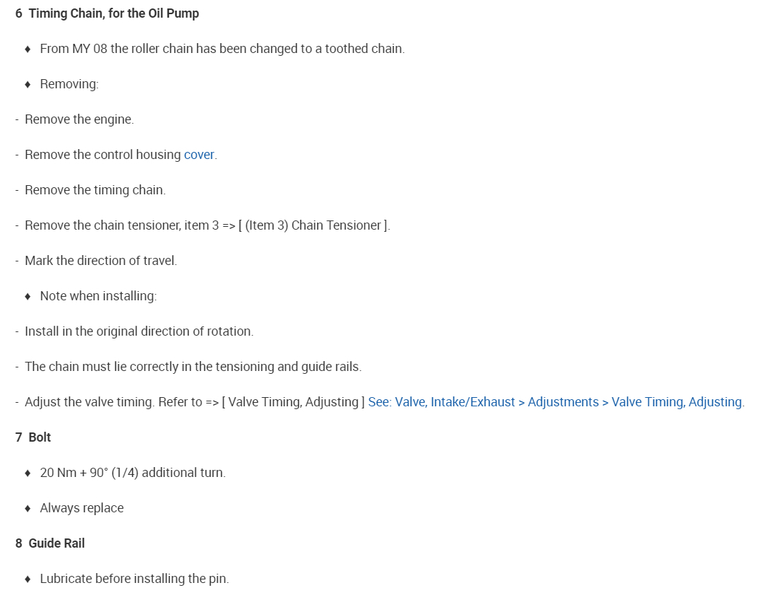

Bummer, it sounds like the timing chain broke due to an oil pump lock up. To be sure here are instructions in the diagrams below to show you what to look for inside the engine. Check out the diagrams (below). Please let us know what happens.
