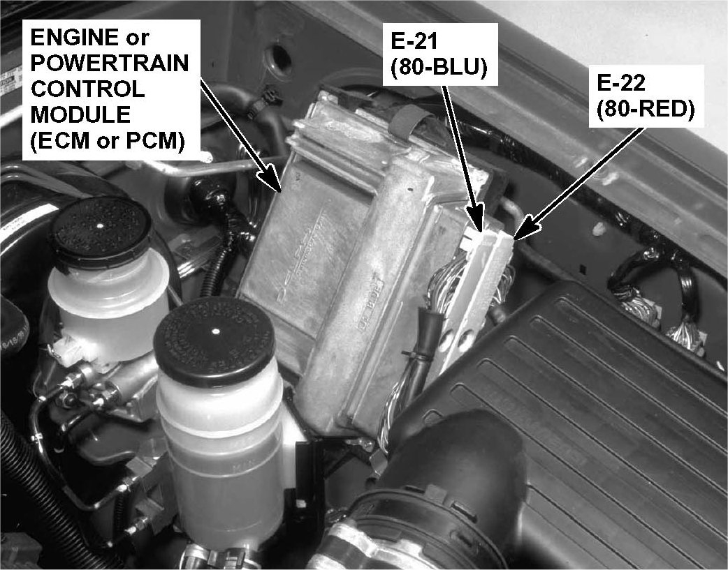

What is a PCM n where is it ?
Dec 3, 2018 at 2:37 AM
  • 110,248 POSTS
PCM stands for power control module. It is basically a computer. The PCM supplies either 5 or 12 volts to power various sensors or switches throughout the vehicle. When it fails, many different things can happen.
It is located under the hood near the air box. I attached a picture for you to see it.
