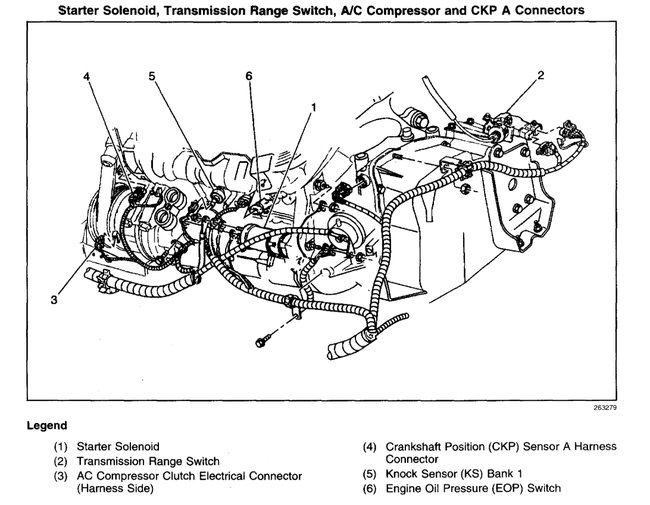

Just had plugs and plug wires put on and a new radiator and battery.Go down the road it cuts off. Pull to the side of the road it cranks back go a mile or two ,cuts off but cranks back.

This can be many things but it sounds like the crank shaft angle sensor is going out which will not set a code. Here is a guide that will walk you through the sensor change with diagrams below to show you how on your car:
this guide can help as well:
