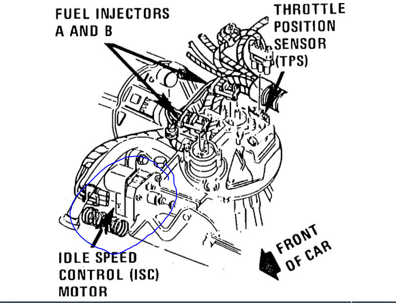

They had an idle speed control motor on the throttle body but if it was bad, it would do it all the time.
https://www.2carpros.com/articles/how-to-replace-an-idle-speed-control-motor-iac

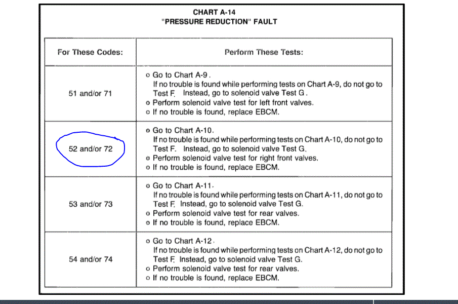

Can you check for codes by pushing the off and warmer buttons at the same time and give me all the E codes?

Got code E52 out of that car.

Is E52 related to oil temperature sensor?
Sep 15, 2020 at 6:41 AM
The 52 is for the anti lock brake system. I attached the chart for you.
It has nothing to do with your issue.
Watch the idle control motor. When you put it in forward, does the arm come out and increase the idle?

Okay, will have a helper start the car and I will watch.
It's just so weird that it lopes and runs inconsistent in Drive/Park/Idle then in Reverse it runs perfect.
This one has me totally stumped.
I looked up on GM website the ECodes. What I found was low engine temperature was E52, would that affect the engine?
Could a temp sensor be out?
I will check the throttle body and the idle control asap and get back to you.

Alright we started it and the arm came out.

Did the arm come out in drive?
No to the coolant sensor. It would effect both forward and reverse.
Sorry, I reattached the chart.

Yes the arm came out!
Sep 16, 2020 at 3:52 AM

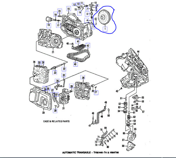

Okay, that concerns me. This means it is working correctly and it should run and not stall.
The one thing that could cause it to stall is the torque converter. It could be locked internally and not releasing.

Thanks. will check that next.
Sep 16, 2020 at 1:15 PM
ACTIONAUTOREPAIR
  • 19 POSTS
You know that's funny, I mentioned that to my guys and got nothing but "no's couldn't be!"
Sep 16, 2020 at 1:20 PM
ACTIONAUTOREPAIR
  • 19 POSTS
I remembered from years ago having a car do that, but none believed me this last two weeks. ...
Thanks again for your quick responses will keep you posted..
