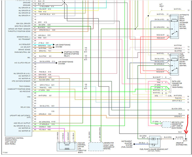

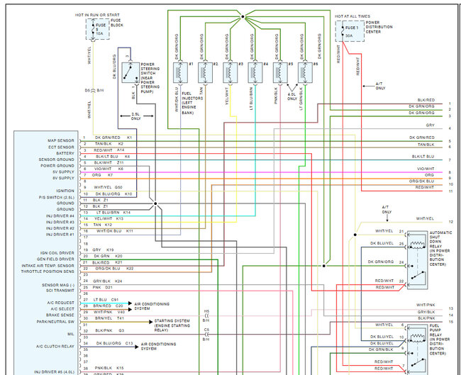

I replaced my 95 YJ engine with a 98 YJengin and now the no start symptoms are no check engine light, Fuel gauge pegged above full. No fuel in fuel rail. Fires using starting fluid. I replaced the Crank position sensor, Pickup coil, fuel pump and computer capacitors. I am not a mechanic; I am only guessing maybe replace computer to a 1998 and then replace wire harness because computer plugs are diffrent. Any ideas are greatly appreciated.
Oct 30, 2024 at 12:24 AM
  • 55,423 POSTS

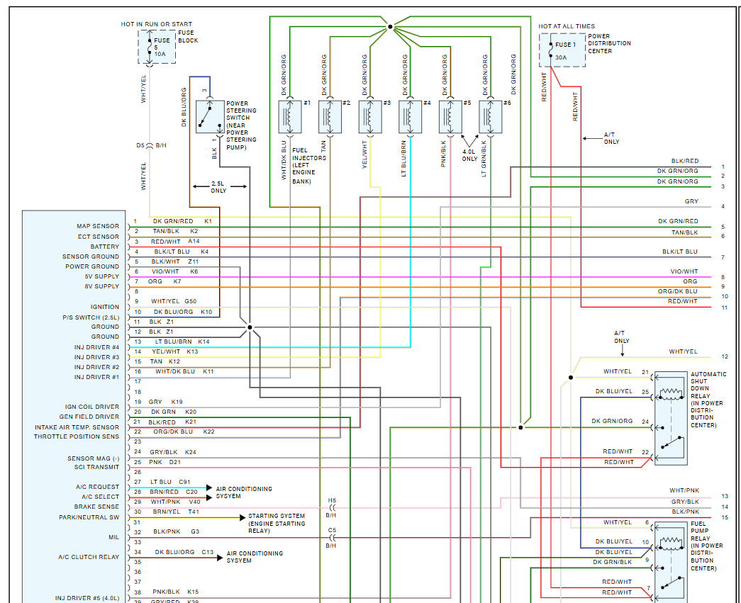

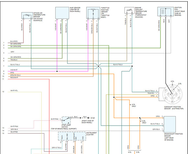

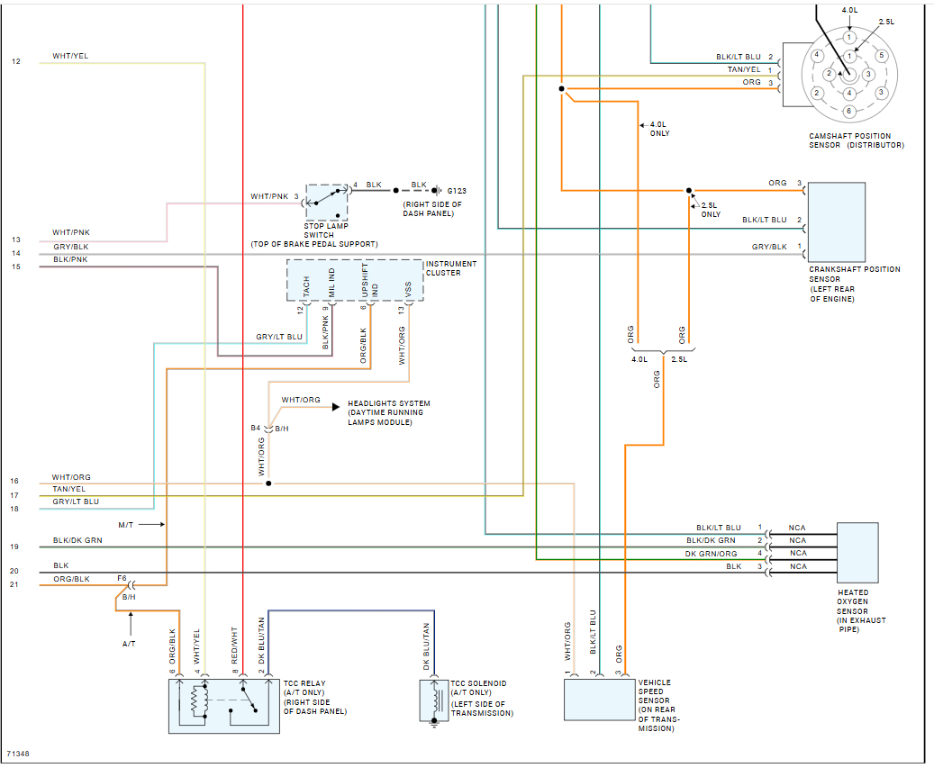

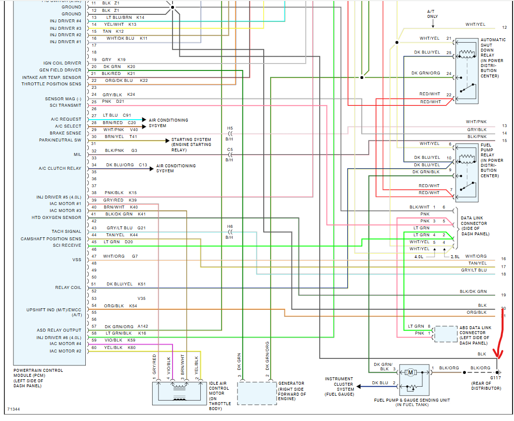

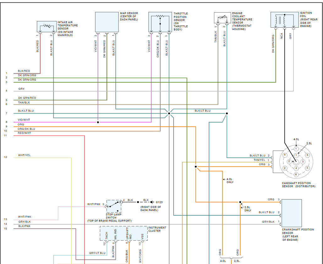

Usually when this happens it is because of one of the engine wiring harness grounds are not connected. I would use a flashlight to go over the grounds again to make sure all connections are clean and tight. The one I am talking about is behind the distributor. Here is the engine and PCM wiring diagrams so you can see how the system works, and I have marked the ground I need you to check. Also, I would make the MAP sensor is plugged in and mounted, if the PCM does not see vacuum it will not turn on the fuel pump. Also, let's run the codes to see what are stored.

Ken, Thank you. I already have cleaned that ground wire attachment earlier. I def. Will check the wires on the MAP sensor. I can not check codes because my check engin light hasn't came on after this swap. Check engin light stays off and Ebrake dash light is permently on when key is turned on. I also hot wired gas pump relay and still no gas comes to rail. So I will do all you said and I will let you know. I do this when I am able.

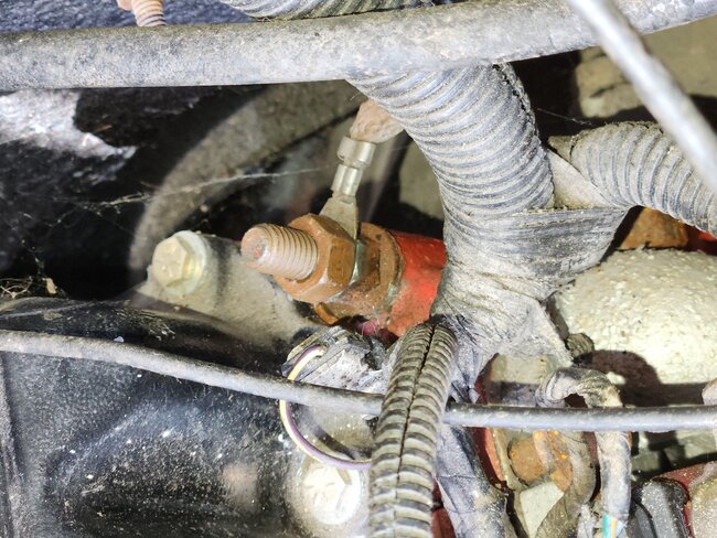

I looked today and MAP sensor wire connection was on properly and tight. The tube on it was attached on MAP sensor and other end was on the intake manifold at the carburetor. I found a rusty connection on the driver side rear top engine that I will take apart and clean with a wire wheel on a Dremel, soon. I will keep you posted. Thank you for your help, time and patience.
Oct 31, 2024 at 8:29 AM
JIM TRENTON
  • 23 POSTS
The rusty connection is a copper braided ribbon going from the top rear of engine to firewall. The other end of that ground on firewall looks clean and good as I did clean that earlier. It's the end attached to engine that is rusted up.

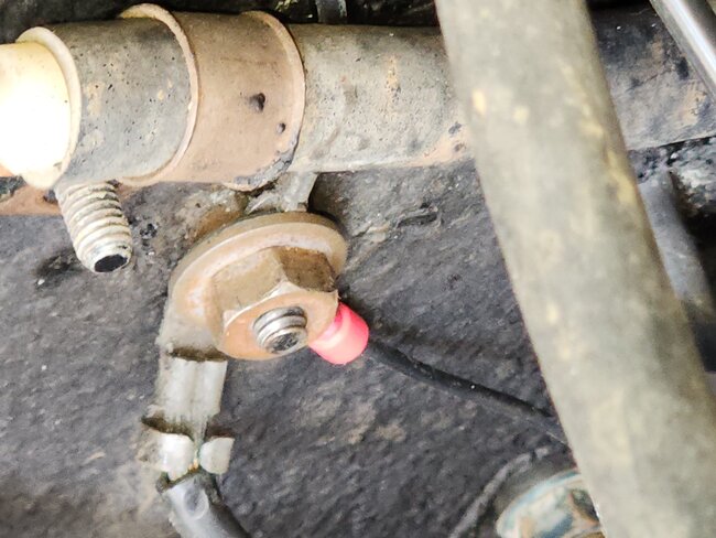

You can see 2 of the 3 grounds i cleaned today. One pic was a duplicate and the other not related to this project. I'm not good with using my phone.

In the last image it looks like the ground is not good like the plastic insulator is getting in the way of the connection. Let's see if you have power to the ignition coil when the key is on? This guide will help:

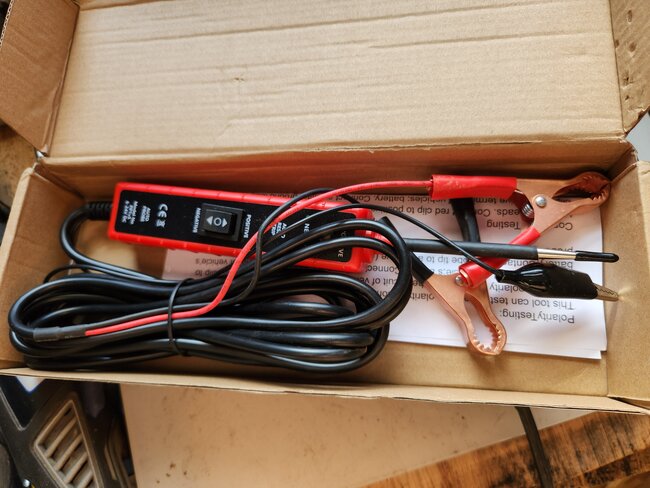

Ken, we haven't made it to the store but I ordered a test light online.

Ken, I hope you have a nice Thanksgiving. Do not reply this week since it is a Holliday. I hooked up my tester and it showed green until I had her turn the Jeep over. The red positive light flashed one time. We did this twice with the same results both times. Red and Black clips went on battery connections, small ground clip went on ground bolt on engine block then I touched probe to exit stud on coil. I hope this gives you the info you need. If I need to do anything else, I will. Thank you, Jim
