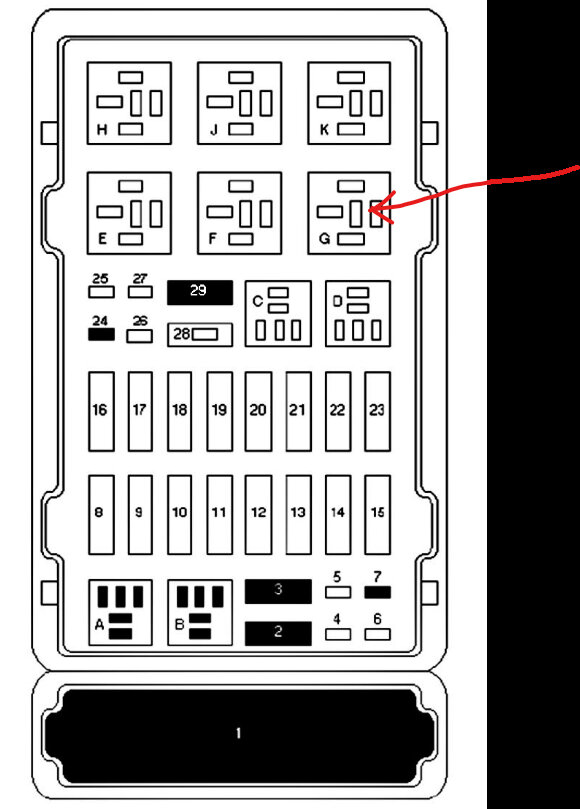

Hello, there guys, it's just me Warren again. I have a question(s). Not too long ago (yesterday) i had my check engine light to come on. The following code is what my scanner found. First the familiar codes P0171 and P0102. I know the P0102 is the MAF sensor. We replaced that yesterday. And now these codes have shown up C1230 rear center input, C1229 rear speed sensor center coherency. On top of that i drove the van today and it ran really good. so far, the codes haven't come back on but as soon as i got home and pulled up in my driveway the van stalled on me. Now that is the first time i have ever seen it do that to me. But it did let me start it back up and pull it on up in the drive and to park it. Any ideas what is going on this time?

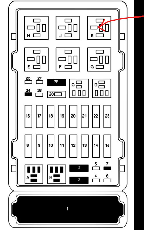

Yes, this can happen when the fuel pump or the PCM power relay is going out. I would do a fuel pressure test to see if it is low, which will help us find the problem.
30 to 45 psi - you can rent a fuel pressure gauge from the auto parts store for cheap or free.

Here is the PCM power relay and fuel pump relay you can swap out which can fix the problem. Check out the images (below). Please let us know how it goes

Oh, i forgot to ask. What is supposed to happen when i swap the relays? Just asking.
Aug 3, 2023 at 3:01 AM
  • 55,456 POSTS
It should fix the stalling problem, I hope.

Me too... Say, if i can find a store that has the ones i have... Would it be a good idea to replace them both with new ones?
Aug 4, 2023 at 2:22 PM
  • 55,456 POSTS
I would give it a try.

Just so you know, so far it hasn't stalled (and it starts right up too) on me since we replaced the MAF sensor. and no, i haven't swapped out the relays yet. But i will buy some anyway because here they're only $8.00 - $21.00.
