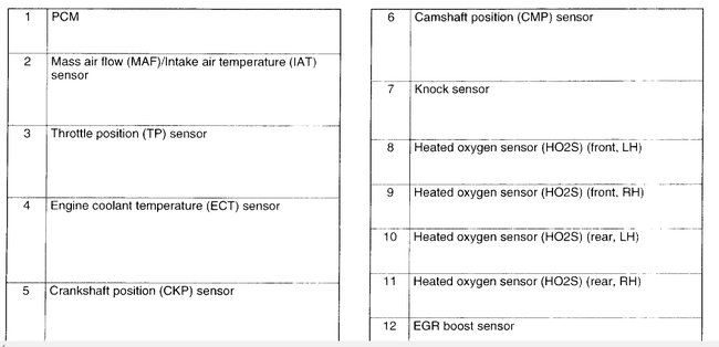

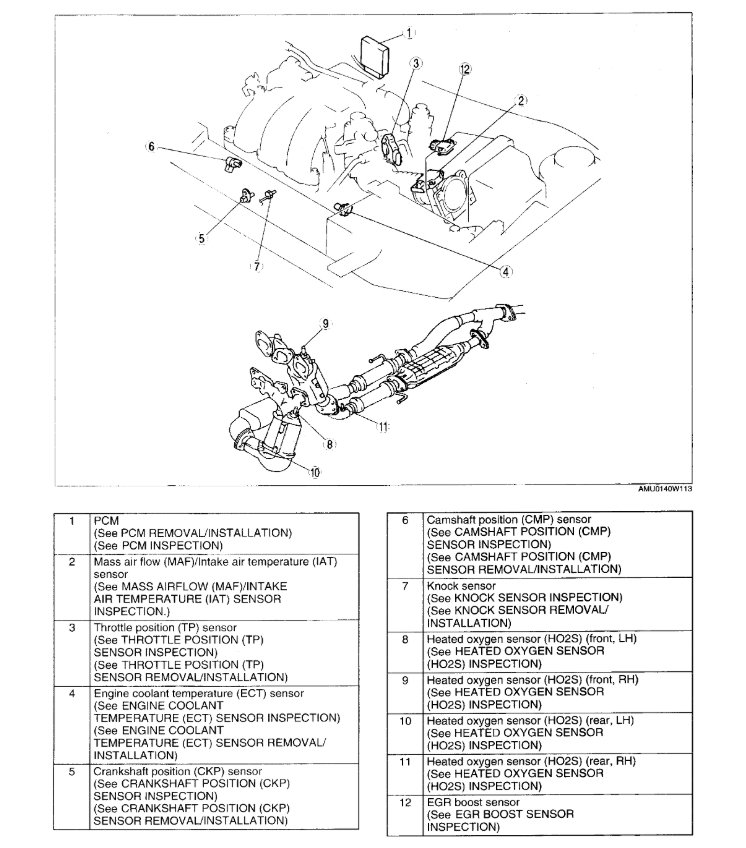

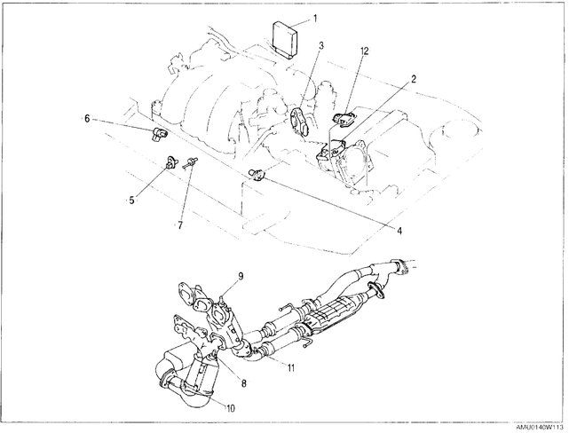

You sent me a link awhile back but it never got bookmarked correctly. I need a diagram on the location of 02 Sensor Bank 1 Sensor 1 that I need to examine and or replace.

This is north America locations, the second is except North America.

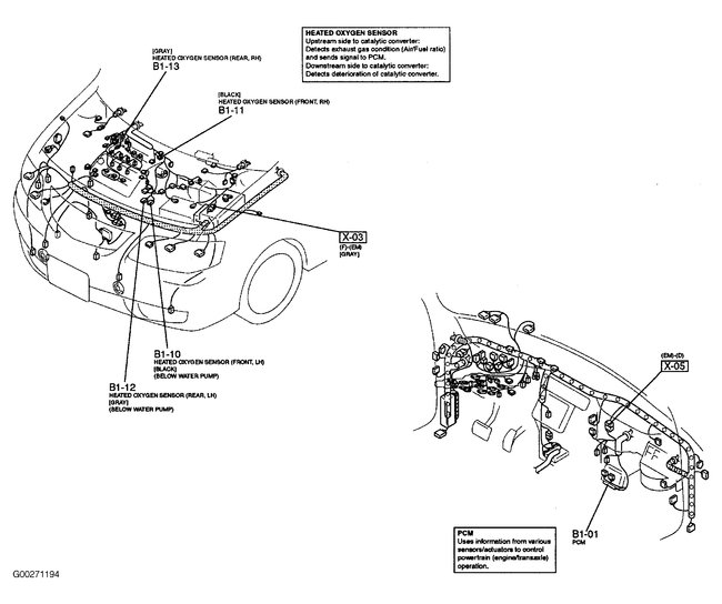

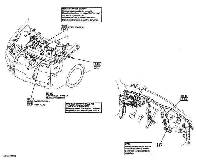

Thanks for the diagram. Do I have to remove the plenum to get to this sensor?

Not sure, all I read is maybe disconnect alternator but do not remove it and use a rope or mechanics wire and attach it to keep it from falling.

There are four, left front, right front, left rear and right rear. Depending on which code you have these are also the locations. Check out the diagrams (Below). Please let us know if you need anything else to get the problem fixed.

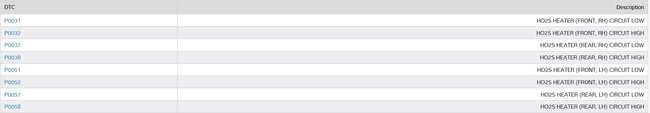

Code is P0051. HO2S II needs to be replaced.
Can you tell me how to physically reach the electrical connector at the end of this sensor? From underneath the car it appears to go up above the alternator. I can't see where the connector is; not from underneath, not through the passenger side wheel well and not from the top of the engine compartment. Any thoughts on what must be removed to access this connector?
