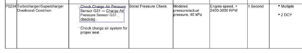

I had the diagnostics put on and got the code po234 which is over boost problem. I have looked at the symptoms of this, but the car is running fine no limp mode or misfire. I was wondering would cleaning the boost sensor take of this? Any answers would be appreciated.

Honestly, either there is an over boost issue or the charge air pressure sensor is bad. I attached a diagnostic flow chart, but it will require specialized tooling. See picture 1.
Here are the diagnostic directions for the sensor. All remaining pics but the last one correlate with these directions.

Let me know if this helps. And honestly, if it is over boosting, it can cause engine damage. When you remove the sensor for cleaning, do the checks listed above to confirm it is good.
