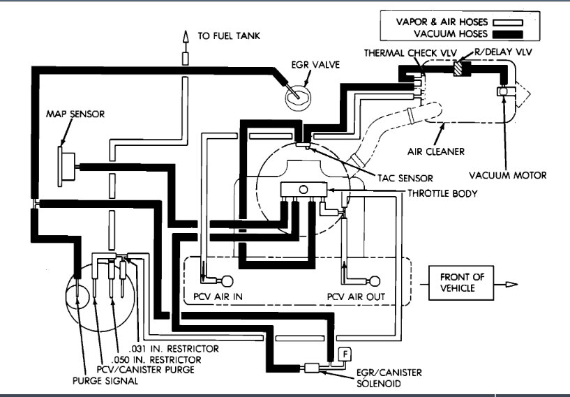

Can I get a diagram on how to hook up charcoal canister?
1989 JEEP WANGLER YJ
100,000 MILES • 2.5L • 4 CYL • 4WD • MANUAL
MARTYCHAR67
MEMBER
1 POST
diagram on how to hook up a charcoal canister?
Feb 13, 2023 at 4:50 AM
Experienced Mechanic
110,251 POSTS
The only thing I have is a vacuum schematic. I attached it below. Take a look at it and let me know if it helps or if you have questions.
See pic below.
