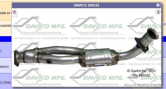

The 430 code is for the catalytic converter for bank 2, which is the passenger side converter. It needs to be replaced.
https://www.2carpros.com/articles/catalytic-converter-replacement
Rock auto has the converter for under 200.
