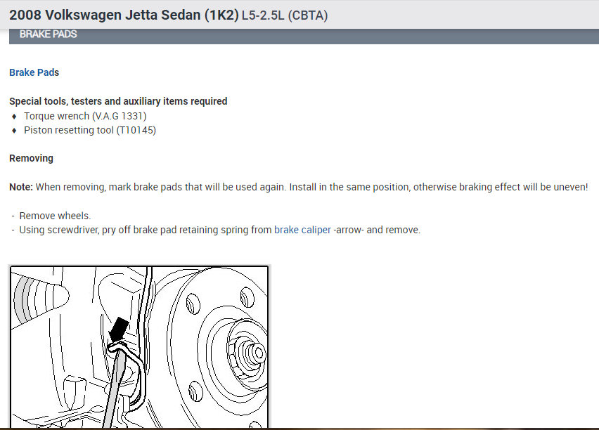

now I noticed the front brakes are bad
2008 VOLKSWAGEN JETTA
154,000 MILES
ASMITH9020
It’s been sitting since December. We finally got new spark plugs and a new battery and it sounds good but now I noticed the front brakes are bad. Thank you

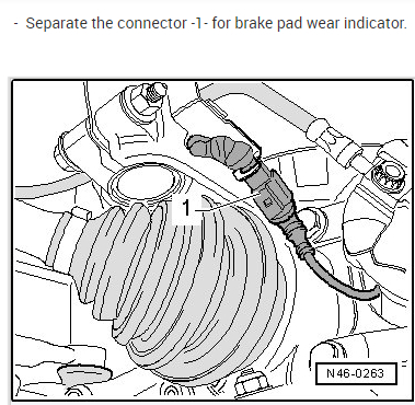

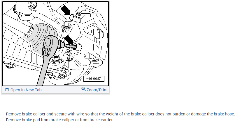

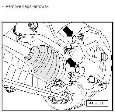

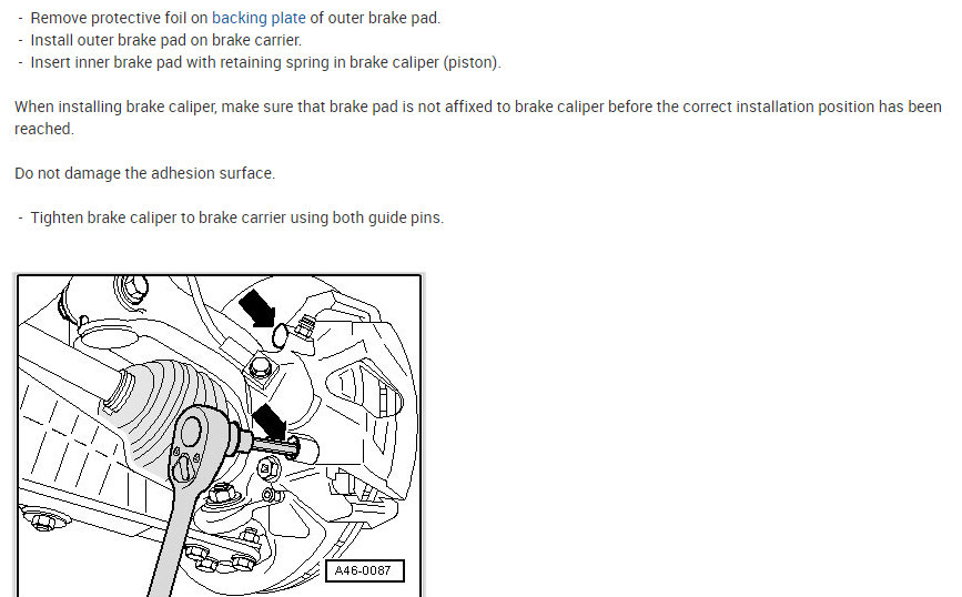

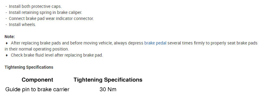

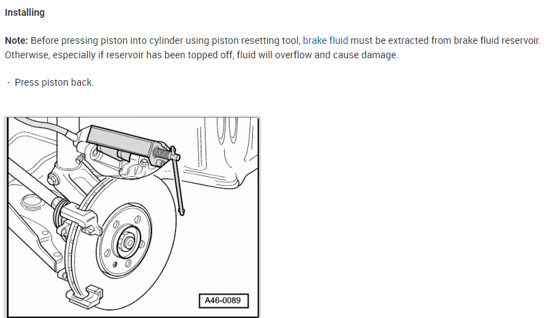

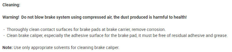

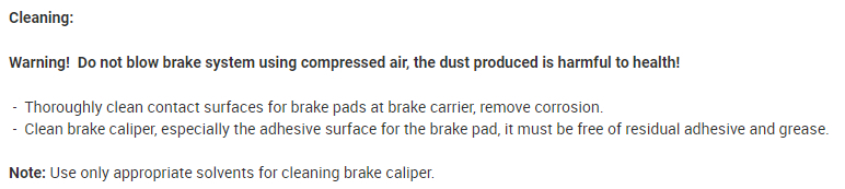

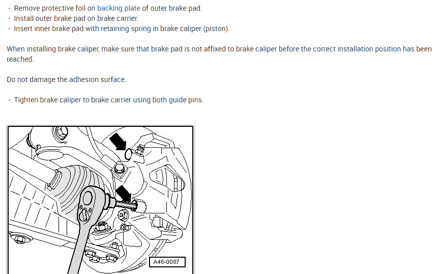

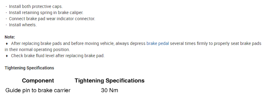

Here is the information you requested. This is a tutorial showing what is involved on how to change front brake pads and brake rotors:
I've attached picture steps below on how to change the front brake pads on your car. Hope this helps and thanks for using 2CarPros.
