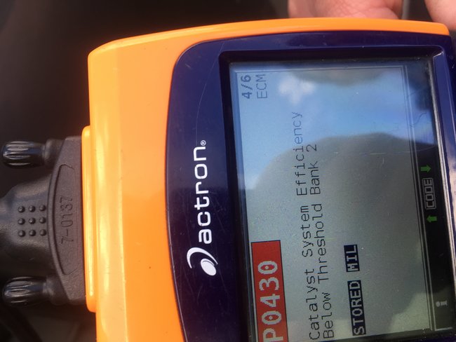

Truck engine light will come on for a week or couple days then go off for a while then back on. Advance read the code and said it could be vapor canister or vapor solenoid or filter but when you look it up online it shows fuel injectors or o2 sensor or catalyst converter spark plugs. What is it really?

Po430
Catalyst system efficiency below threshold bank 2.
Oct 30, 2018 at 11:33 AM
Okay, that codes indicates a failed cat converter for bank 2.

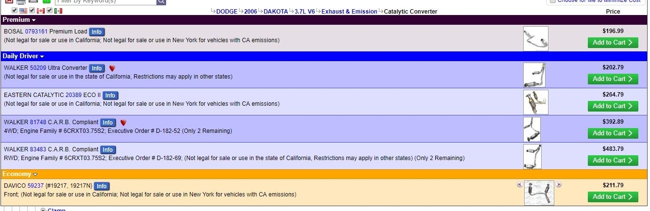

You need a new converter. I attached some possible parts for you to view. The catalytic converter is one assembly that contains both cats. one for bank 1 and one for bank 2.

So I need a catalytic converter not the list of parts you sent me about o2 sensors stuff.
Oct 30, 2018 at 12:06 PM
That is not a list of parts, it is possibilities only.
If you do not have an exhaust leak, then it is the catalytic converter. Roy
