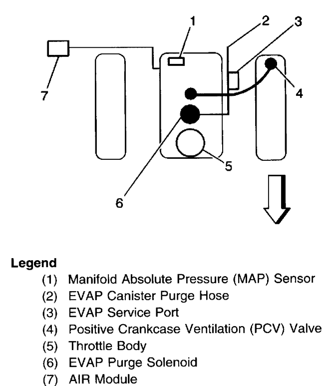

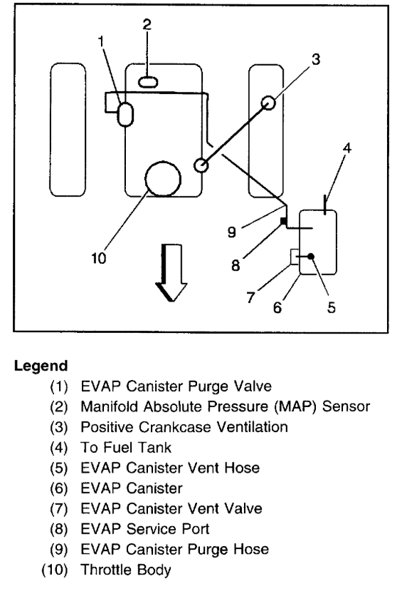

I need a complete block diagram of vacuume hose routing
Jul 22, 2026 at 3:12 PM
Experienced Mechanic
55,694 POSTS
What size engine? Here is what we have for the 5.3 and 5.7 liter. Let me know if this helps.
