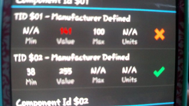

I am trying to get my car to pass smog. The only mil that does not pass is the catalyst. I replaced the one that is just under the intake manifold and all new o2 sensors. I have driven the car well over four hundred miles now and the check engine light does not come on (no DTC). What could be the problem?

What is the actual reason you are failing? Is it because it is setting a trouble code or is it because the monitors have not reset?
If it is a code, give us the actual number. If it is a monitor, give us the exact monitor.

The catalyst will not pass. There are no trouble codes.

I have done the proper driving patterns to set the system and still everything passes except catalyst, and there are still no trouble codes(no check engine light). The diagnostic device gives me info that I am not familiar with (see image).

That is raw data that has not been processed yet. Do not worry about that.

There could be codes set that your scan tool is not seeing as it will not set if codes are stored. Other than that, it's just keep driving it.

I used a pretty decent scan tool called Mentor, and to my understanding it is a very good device. I have driven the car well over 400 miles, probably double that actually. Is there a way to get a smog waiver in California so I can get my registration renewed?

Even the best scan tools have bugs in them sometimes and miss things. It wouldn't hurt to try a different brand.
