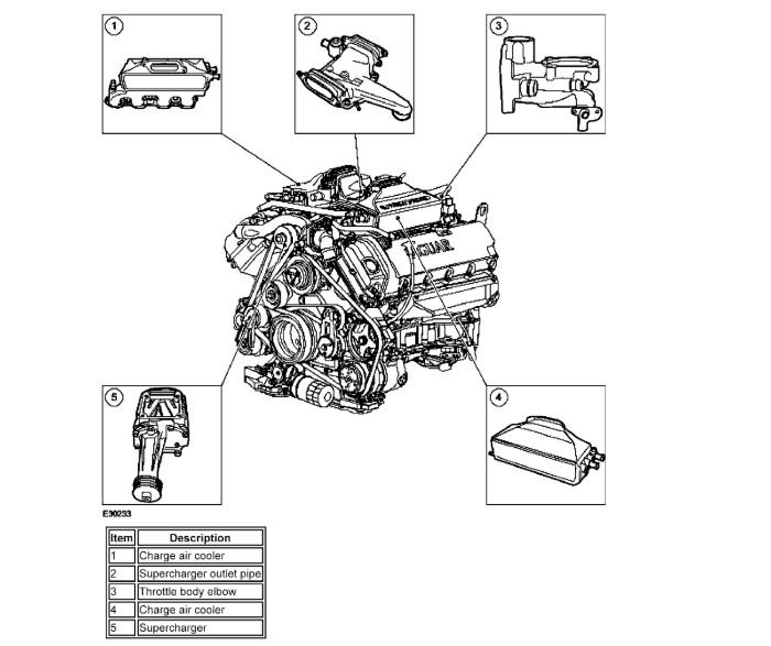

Do you have a scan tool that can read the long term trims for me when the engine is smoking?
Is this a supercharged motor? If it is, that could be the issue with the smoke and the running?

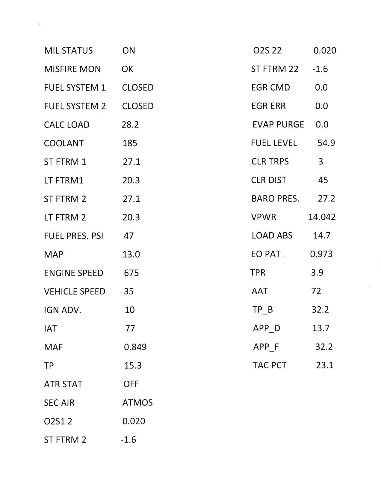

Hey Roy sorry about how long it took. AutoZone did not have live data. Neither did anyone else in this town. One shop had live data, but wanted to charge me $95.00. I am attaching a file. Please tell me if that is what you are looking for. Am I seeing an EGR or EVAP problem?
Apr 26, 2019 at 3:50 PM
Specs for fuel pressure. 47 is too low as it should up in the 50's. Looks like you need a fuel pump which would also explain the fuel trim readings.

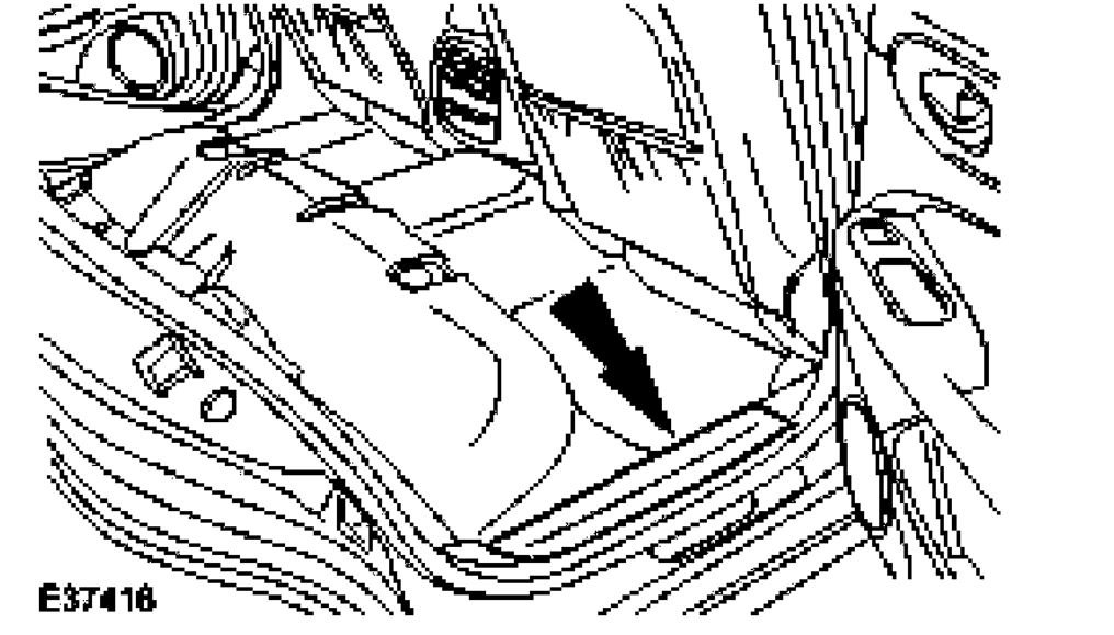

Hey Roy, I want to thank you for all that good information. Sorry for taking so long to get back to you, but I want to check everything and be sure before I tackle that fuel pump. It's one of the harder ones to do. If I have to, I'll cut an access panel under the rear seat. I checked the EGR valve, the injectors, I don't have a PCV per say,but connectors and hoses are all good. I have no leaks. I replaced the MAF. I don't have a schrader valve so it's going to be hard to check pressure from the pump. I went ahead and bought a code reader that reads live data. Paid $100.00 for it. What I did find is this. I pulled the fuel filter and it seemed a little clogged. I cleaned it out and blew it out. Checked the data and I now have 51 psi. I checked the fuel pressure regulator and pulled the vacuum line. No fuel or leaks and it had vacuum to it. When I checked the data with the vacuum line off, there was no change. The pressure should have jumped about 8 psi shouldn't it??? I hope that's the problem and not the pump.
Apr 27, 2019 at 1:49 PM
Yes, it should have jumped. You do need a pump.

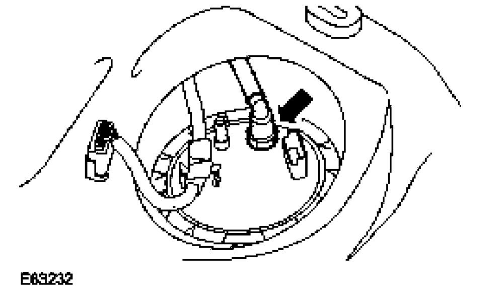

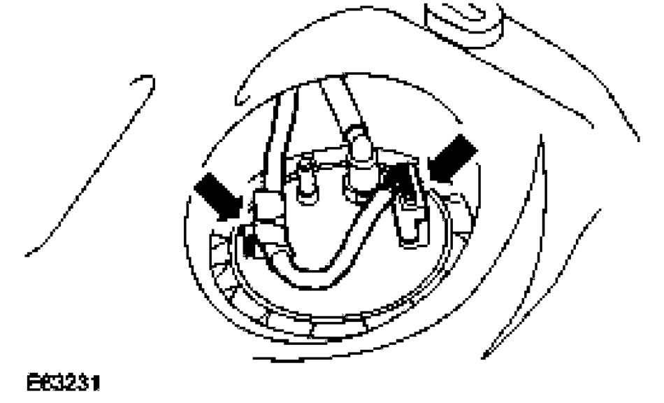

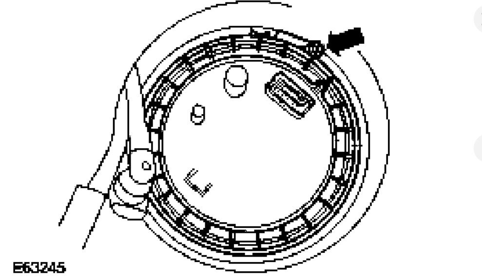

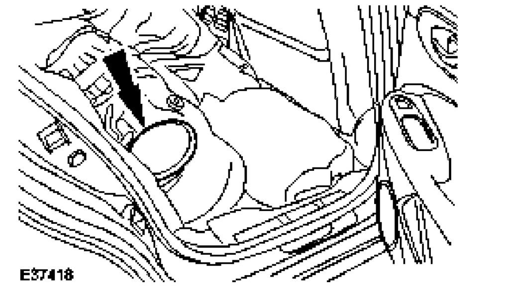

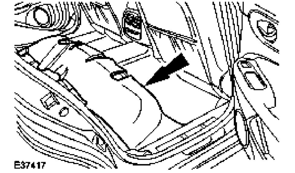

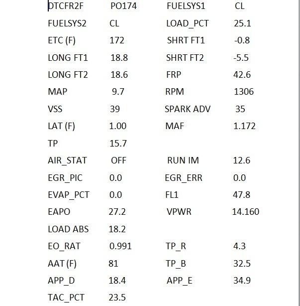

Hello, I hope I am communicating with Roy. It's been a few weeks, but that is who I was working with. Anyway, I put a fuel pump in. As it turned out, the 2006 Jaguar XJ8 is one of the easiest fuel pumps to replace. The car runs great. Before, when I tromp on the accelerator the car would bog down, the check engine light would come on and it would smoke like hell and the Restricted performance message would come on. Now when I tromp on the accelerator, it takes off smooth and runs like it is supposed to. However the codes came back, P0171 and P0174. I am attaching a print out of live data. I know it shows fuel pump pressure at 47 but it can't be fuel pump the car runs great.
May 16, 2019 at 3:07 PM
Okay,
The long term trims are too high.
Vacuum leaks, PCV valve or mass air flow sensor could be the cause of the codes.
May 16, 2019 at 4:05 PM

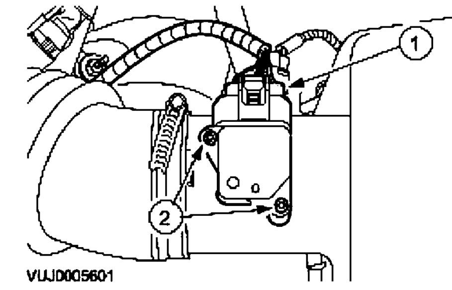

Thank you. I got a new MAS air flow sensor, don't have a PCV, I better check for leaks. I'll let you know.

I replied to this but I don't think it went through so I'll do it again. Looks like you did it again Roy. I had a little rip in the rubber boot that holds the MAF sensor to the throttle body. I repaired it, let it sit overnight and drove the car all over town today and didn't get any codes. It didn't take much, that was a small rip. Looks like I got away cheap. Thanks again Roy you know your stuff.
