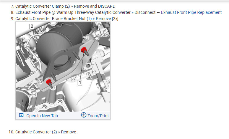

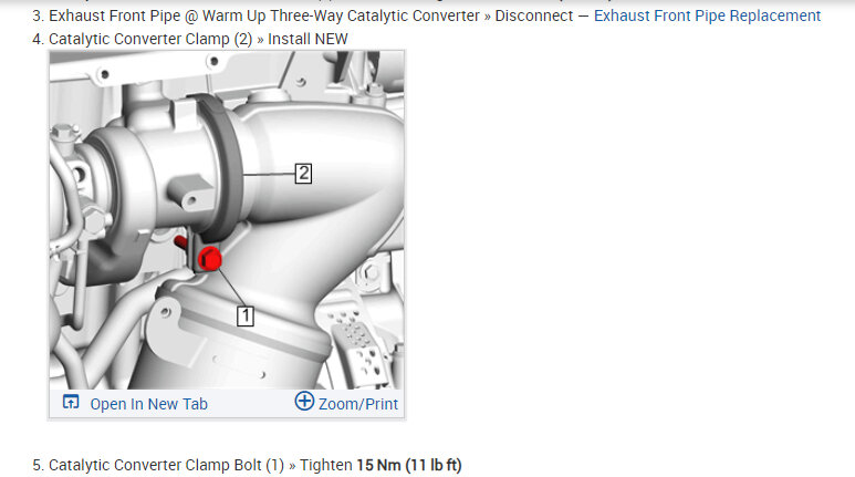

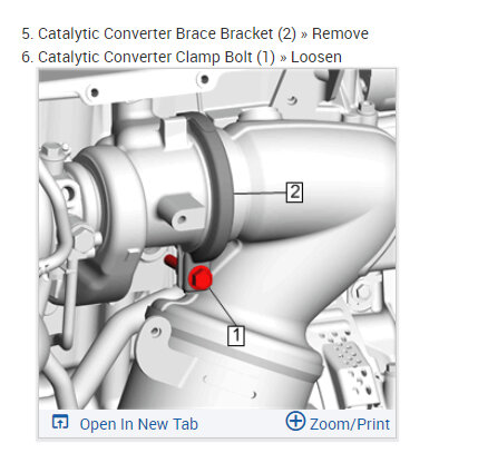

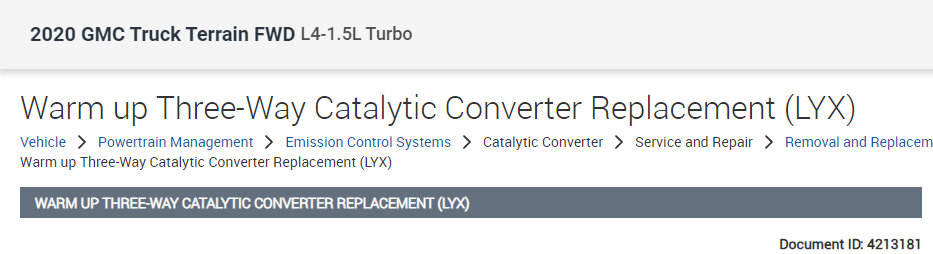

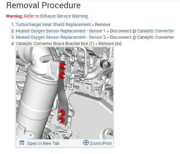

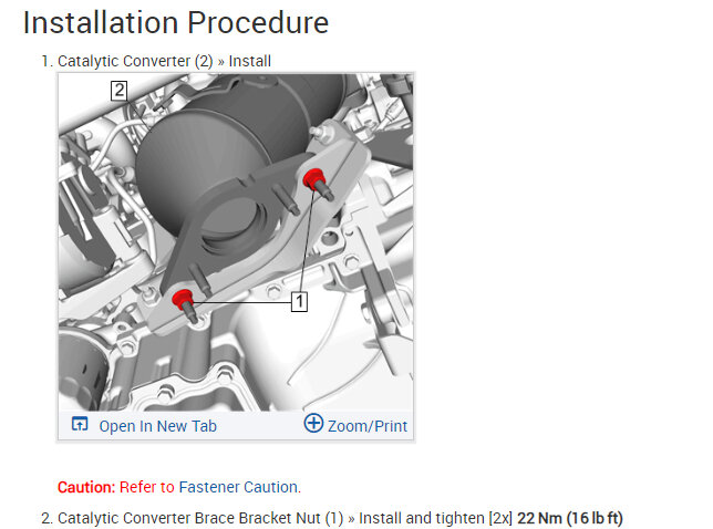

If the converter is faulty, can you send me a video or diagram on how to replace it? Iam going to replace it myself. Thank you!
Jul 17, 2024 at 10:00 PM
  • 110,251 POSTS

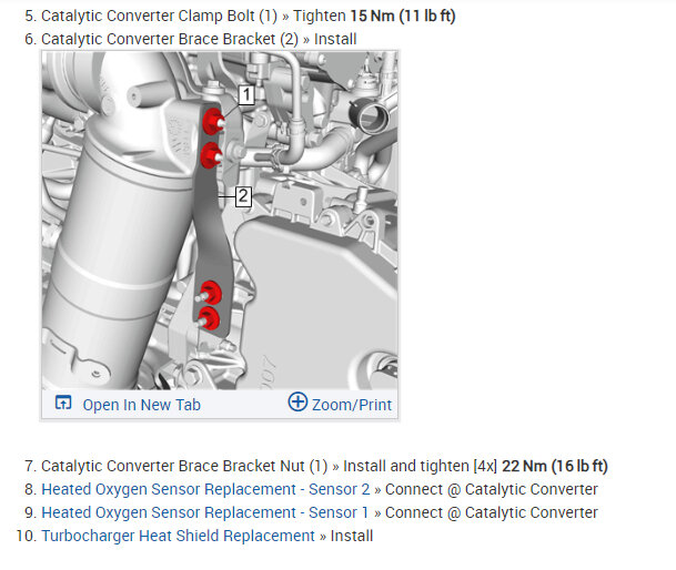

No problem whatsoever. Note that one end bolts to the exhaust manifold and the opposite end bolts to the exhaust system. If rust is a concern where you live, spray the bolts with some penetrating fluid in advance to help.
If you look below, I attached the directions from my manual. There is a bracket that will need removed.
See pics below. Note, make sure the engine is cool before you do this procedure. Also, it is a good idea to disconnect the negative battery cable.
Jul 18, 2024 at 12:24 PM
BADBOYROD
  • 16 POSTS
Thank you for y’all help. I replaced catalytic converter and that was the issue. Running better.

I replaced with a new catalytic converter, few days after I get a rattling noise every time at startup but goes away, check engine light is back on, PO420 Catalyst System efficiency below threshold bank 1. What can it be? Please help.
Aug 24, 2024 at 4:41 AM
  • 110,251 POSTS
The rattle is interesting. Do me a favor, with the engine cold, take a rubber mallet and tap on the exhaust system to see if you can recreate the sound.
If you can, check to see if it is coming from the new converter.
Aug 24, 2024 at 12:31 PM
BADBOYROD
  • 16 POSTS
Got it figured out it was the clamp that connects between the turbo and catalytic converter, it was loose I didn’t tighten it enough. I just didn’t want to over tighten it. No rattling noise. Thank you for your help.

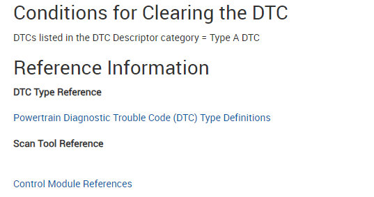

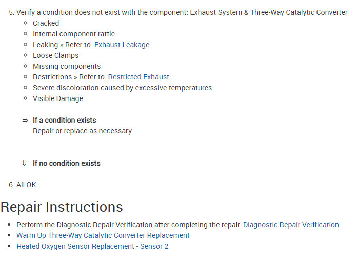

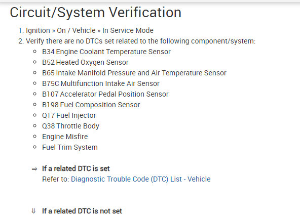

I replaced the catalytic converter with a new one and replaced 02sensors new, and check engine light is back on again this is the 3rd time, everything is tightened nothing loose gaskets are on. I am out of options.
Aug 26, 2024 at 9:54 PM
BADBOYROD
  • 16 POSTS
It’s giving me the same code PO420 catalyst system efficiency below threshold bank 1.
Aug 26, 2024 at 9:55 PM

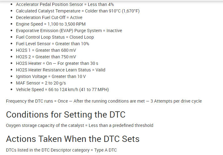

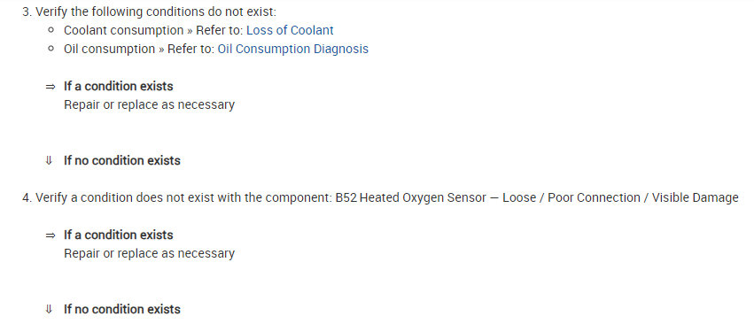

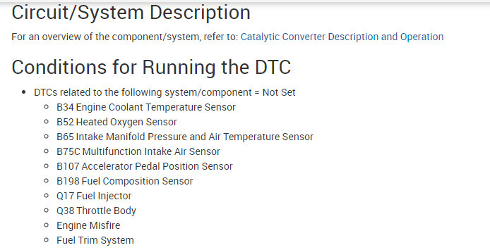

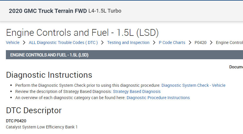

  • 110,251 POSTS
Do me a favor. Take a look at the description and diagnostics to check below. See if anything there was missed.
