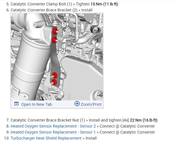

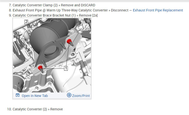

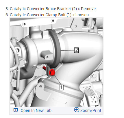

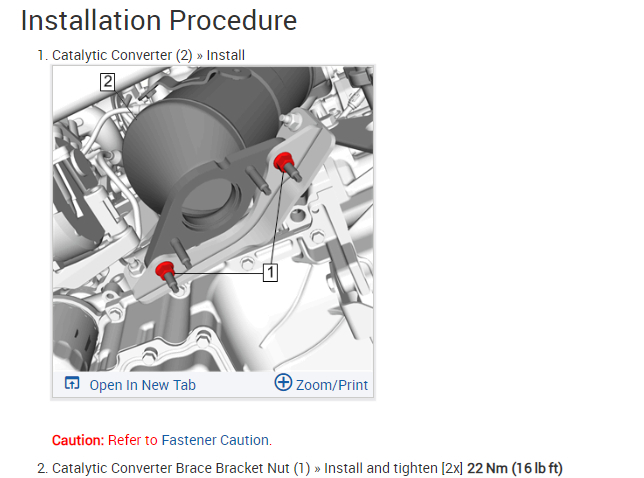

If the converter is faulty, can you send me a video or diagram on how to replace it? Iam going to replace it myself. Thank you!
Jul 18, 2024 at 5:00 AM
  • 110,193 POSTS

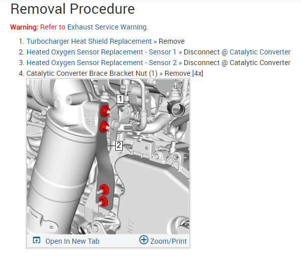

No problem whatsoever. Note that one end bolts to the exhaust manifold and the opposite end bolts to the exhaust system. If rust is a concern where you live, spray the bolts with some penetrating fluid in advance to help.

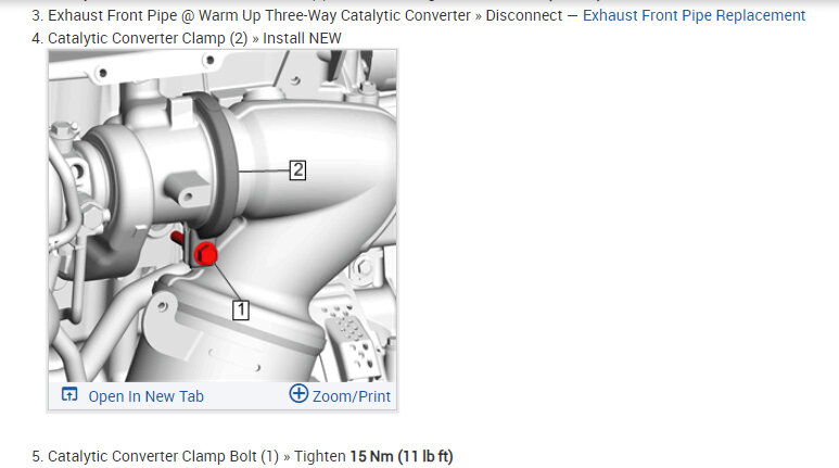

If you look below, I attached the directions from my manual. There is a bracket that will need removed.
See pics below. Note, make sure the engine is cool before you do this procedure. Also, it is a good idea to disconnect the negative battery cable.

Got it figured out it was the clamp that connects between the turbo and catalytic converter, it was loose I didn’t tighten it enough. I just didn’t want to over tighten it. No rattling noise. Thank you for your help.

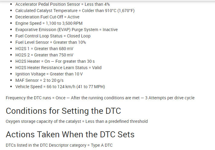

I replaced the catalytic converter with a new one and replaced 02sensors new, and check engine light is back on again this is the 3rd time, everything is tightened nothing loose gaskets are on. I am out of options.
Aug 27, 2024 at 4:54 AM
BADBOYROD
  • 16 POSTS
It’s giving me the same code PO420 catalyst system efficiency below threshold bank 1.
Aug 27, 2024 at 4:55 AM

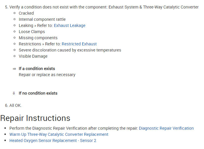

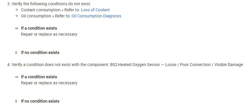

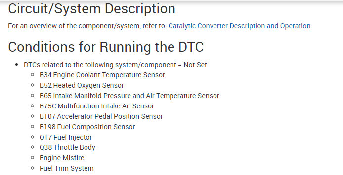

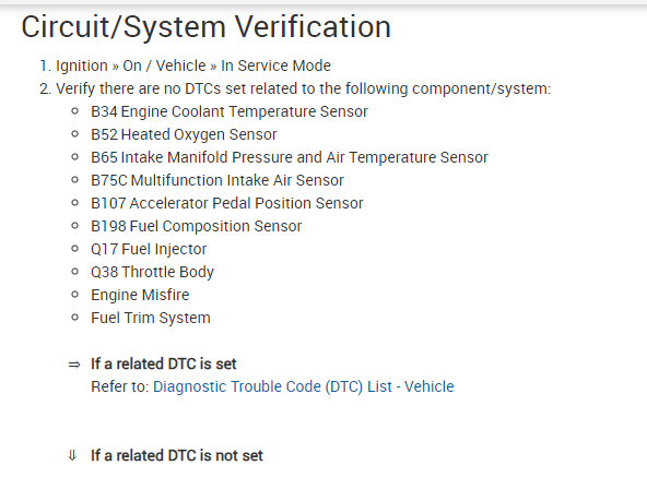

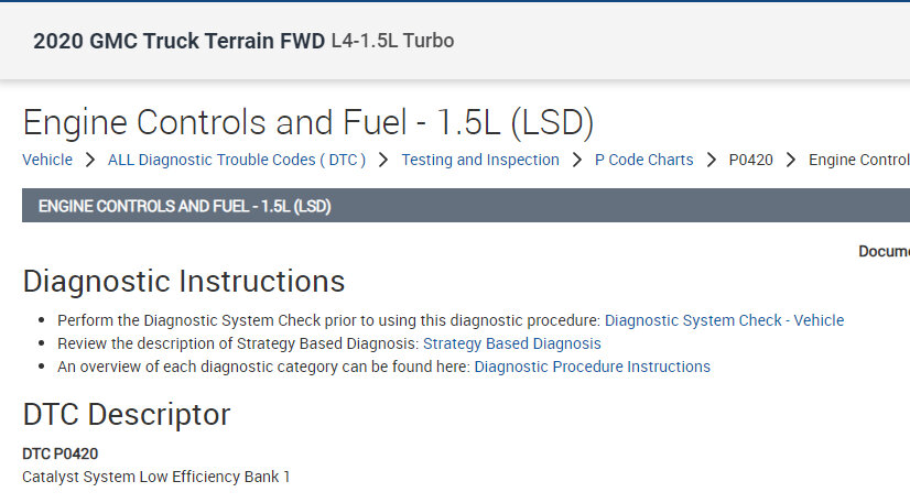

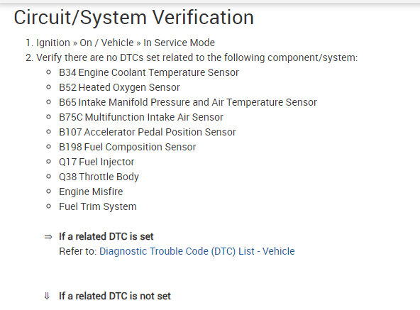

  • 110,193 POSTS
Do me a favor. Take a look at the description and diagnostics to check below. See if anything there was missed.
