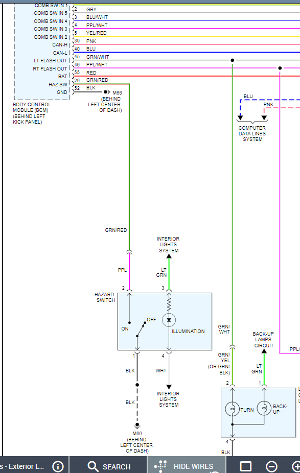

location of emergency flasher.
Apr 22, 2020 at 4:45 PM
Looks like the hazard flasher for this vehicle is part of the BCM. I could be wrong but, I am not finding any location other then the BCM for this.
If your hazards are not working, I would go to the BCM on this circuit and see if you have signal coming in from the switch and then out on the left and right flash circuits. If not, then your BCM is failed.
Let me know if you have questions. Thanks
