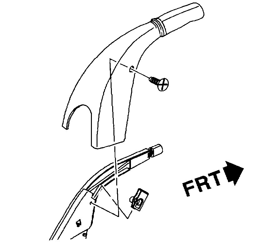

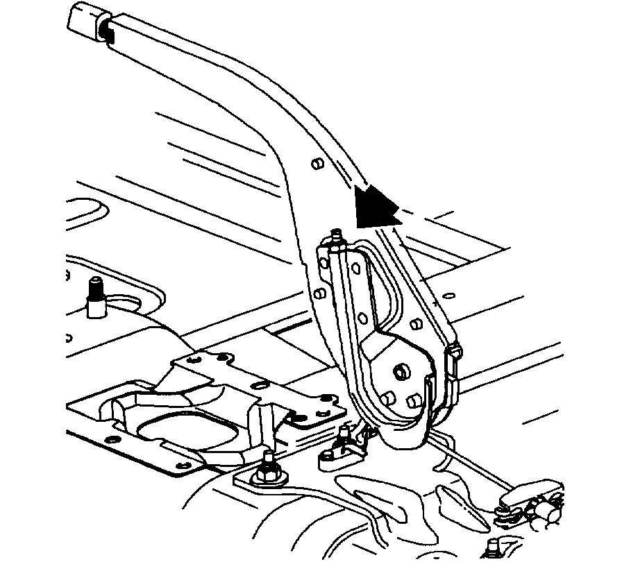

My vehicle recently rolled backwards out of my driveway in the night and into my neighbor's front yard. When I pull the parking/emergency brake lever, I have no resistance and the car does not sit as if parked. On the dash, the parking/emergency brake light comes on as if it is engaged, but nothing physically stops the car from moving.

This can be caused by a few things, a broken cable, adjustment, worn brakes.

Here are the directions for adjusting the parking brake. It is really simple to do. The attached two pics correlate with the directions.

1. Lift park brake lever.
pic 1
2. Remove screw on right-hand side of park brake cover. Remove cover by sliding forward.

4. Pull park brake lever to first click.
pic 2
5. Tighten adjuster nut until moderate drag is felt at both rear wheels when turned by hand
NOTICE: After installation of any new park brake system component(s), the park brake system must be set prior to performing final park brake adjustment. To set park brake system after performing initial adjustment, pull up on park brake lever three or four times with approximately 445 N (100 lbs.) of force. It will require approximately 445 N (100 lbs.) of force to reach the twelfth or thirteenth click position after initial adjustment.
6. Apply and release park brake several times. There should be no drag when park brake lever is in the rest position.
7. Pull park brake lever to first click. There should be moderate drag at both rear wheels when turned by hand.
8. If necessary, repeat steps 5 through 7 until adjustment is correct.

9. Install park brake cover. Secure with screw on right hand-side of cover.

Let me know if this helps or if you have other questions. Also, while you are doing the work, make sure there are no cables hanging or broken under the vehicle.
