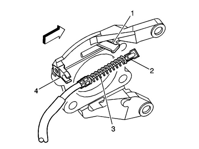

How to replace emergency brakes off How to replace emergency brakes off a 3500 axle with disc brakes to get where cable attaches. All pictures all show old style axle with drums ! Any ideas? Thanks this van has rear discs to get where cable attaches. All pictures all show old style axle with drums. Any ideas?

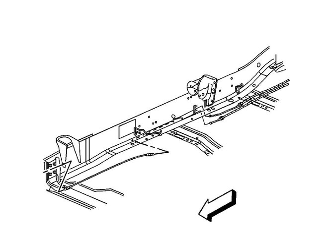

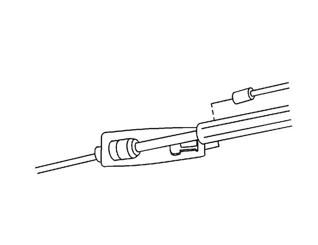

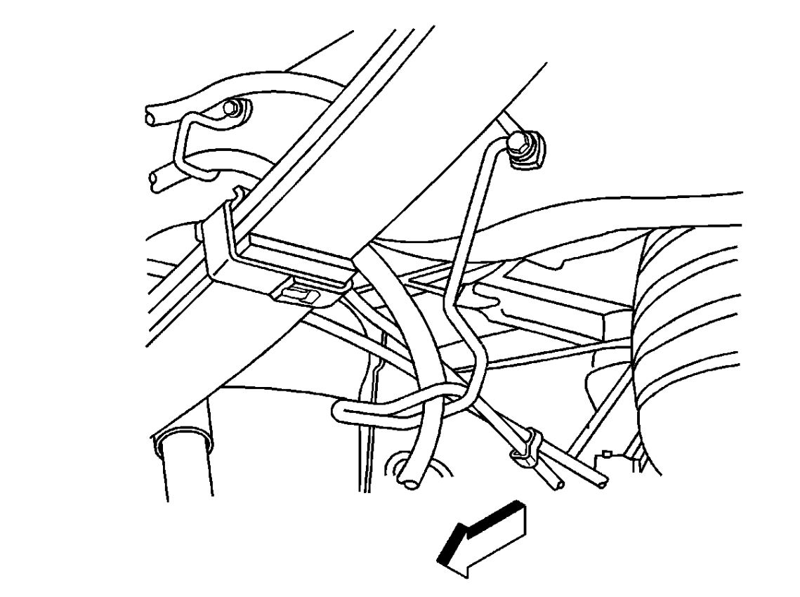

Hi and thanks for using 2carpros.com. I read your question and I believe you are asking how to access the parking brake assembly. That is based on your post. Additionally, you ask about where the parking brake cable attaches. It seems you are already aware that the parking brake shoes are behind the rear brake rotor. Therefore, I have provided the directions to access them. Once you remove the rotor, you will see where the park brake cable attaches. I have limited pictures of the assembly, but I hope they help. First, here are the directions for removal and replacement:

Here is an additional general guide for parking brake servicing that may be helpful.
https://www.2carpros.com/articles/parking-brake-shoe-replacement
Here is a video of the same type of work being completed.
https://youtu.be/uo1RnATyEok
Again, I have attached the few pictures I was able to find regarding replacing the cables
Take care and thanks for using 2CarPros.com.
