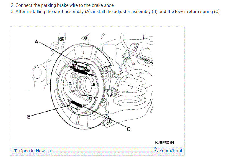

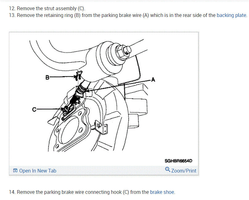

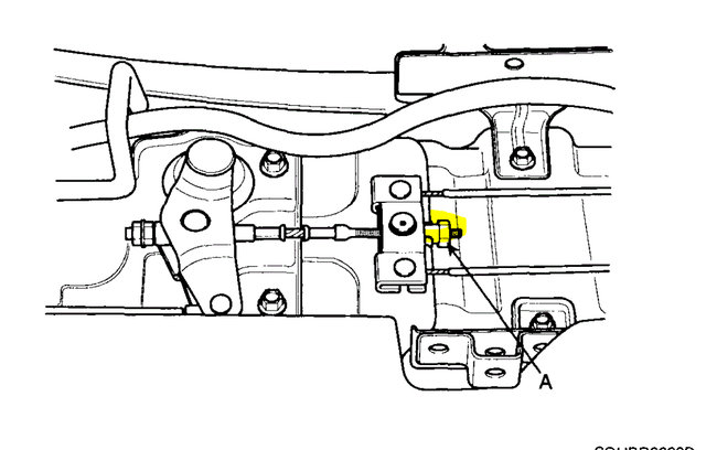

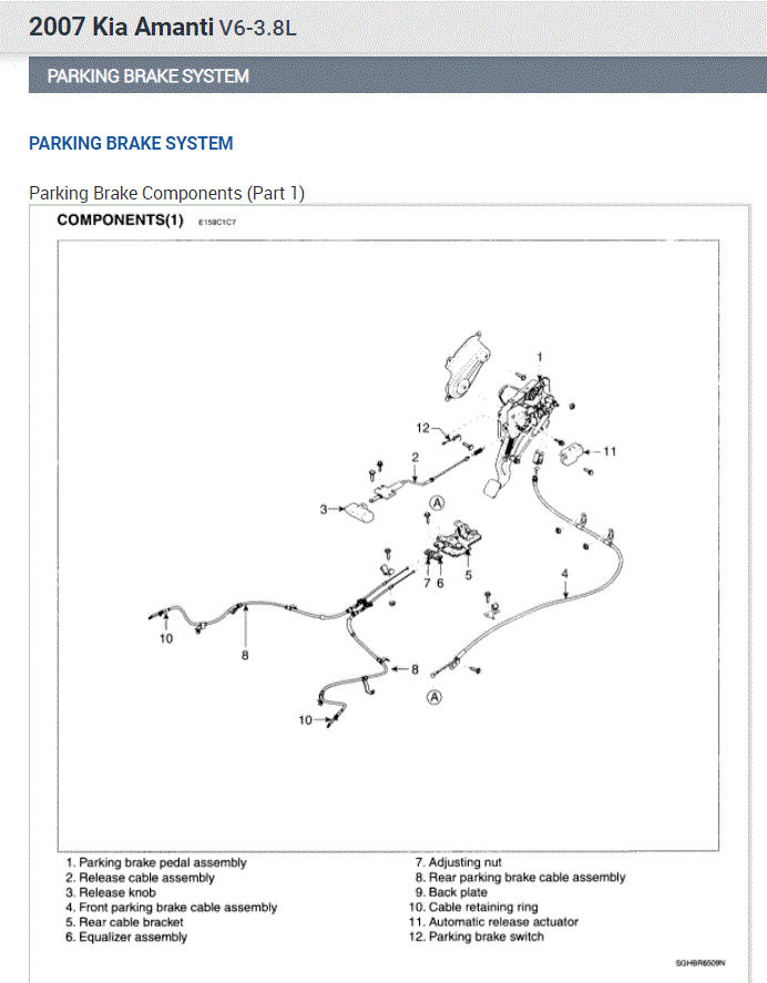

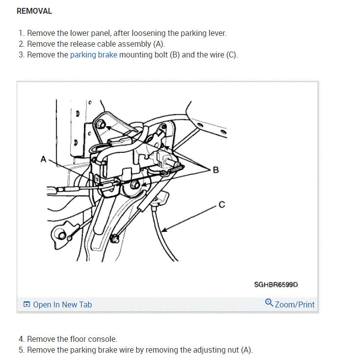

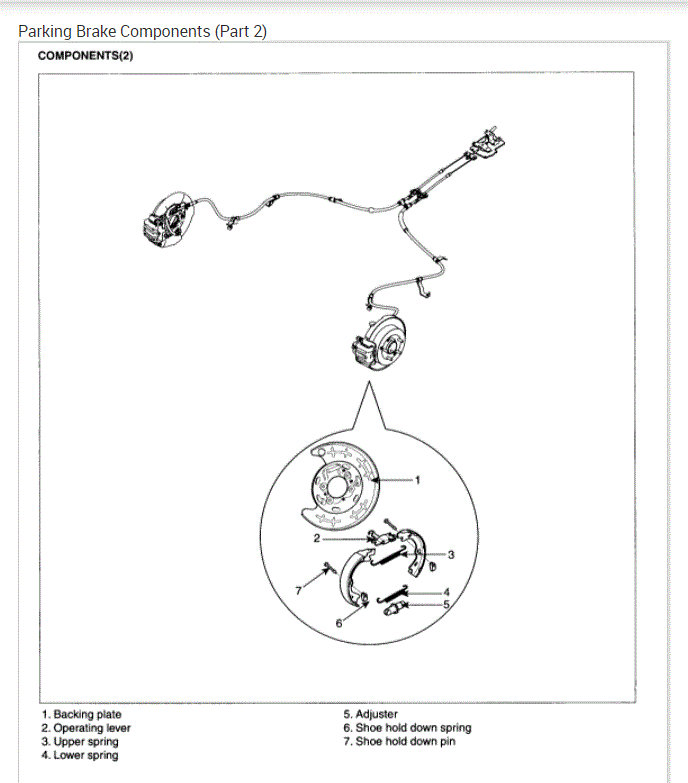

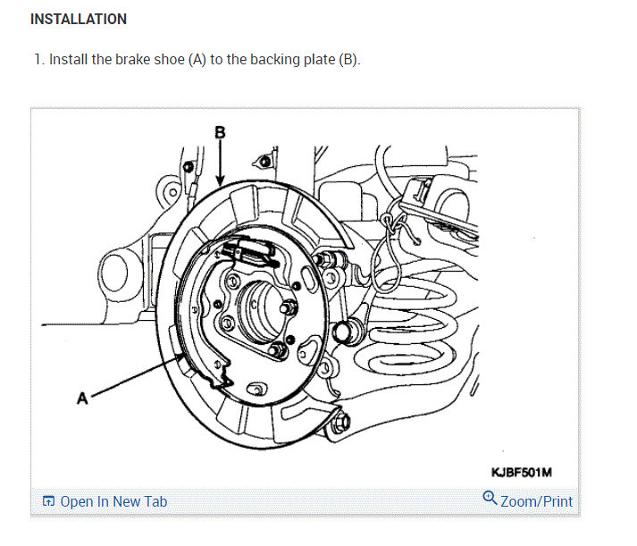

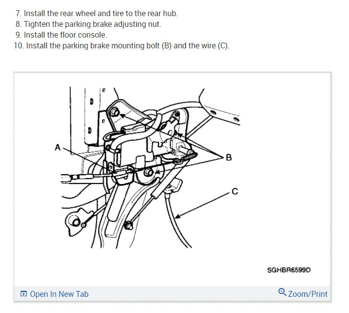

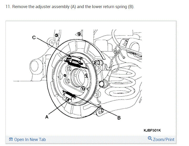

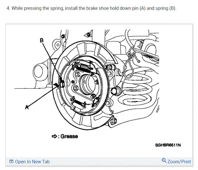

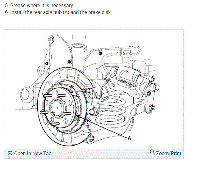

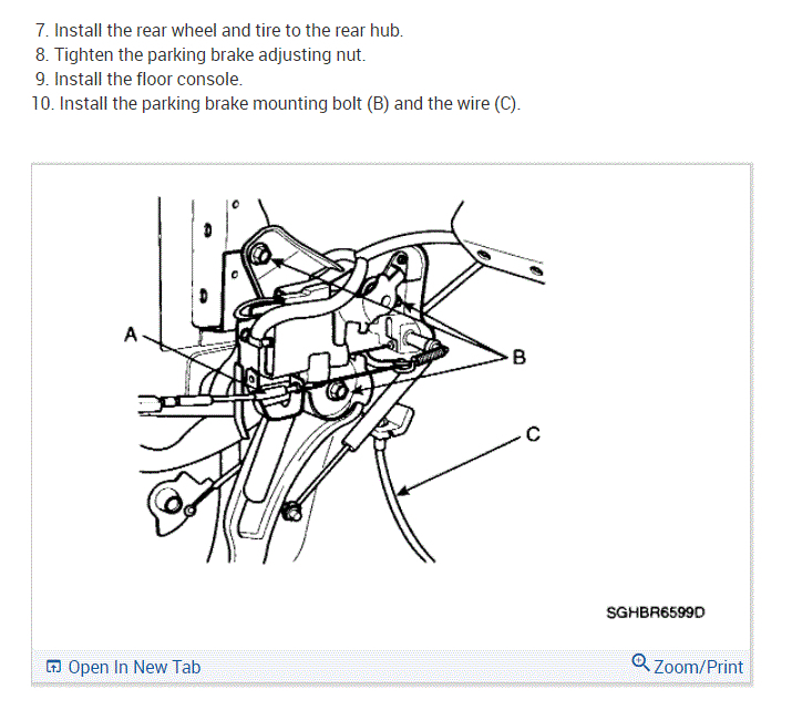

To remove the stretched cable, you need to loosen the adjustment nut.
If you look at the attachments below, they provide the directions for replacing the cable. Take a look and let me know if you have questions.
