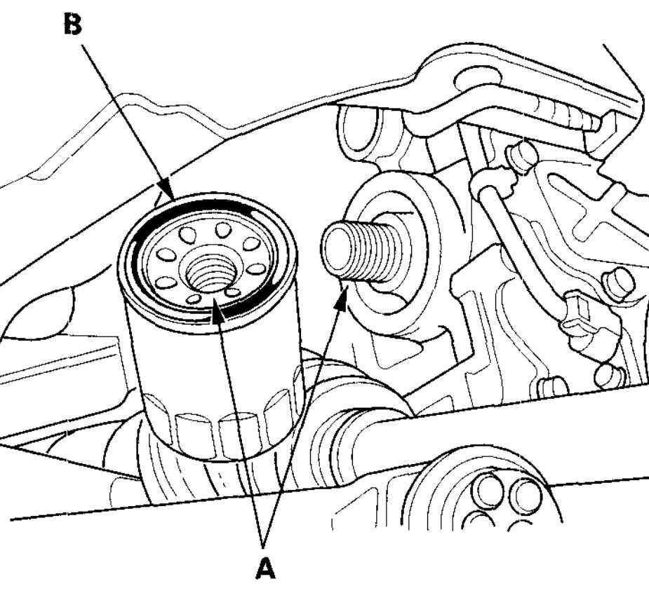

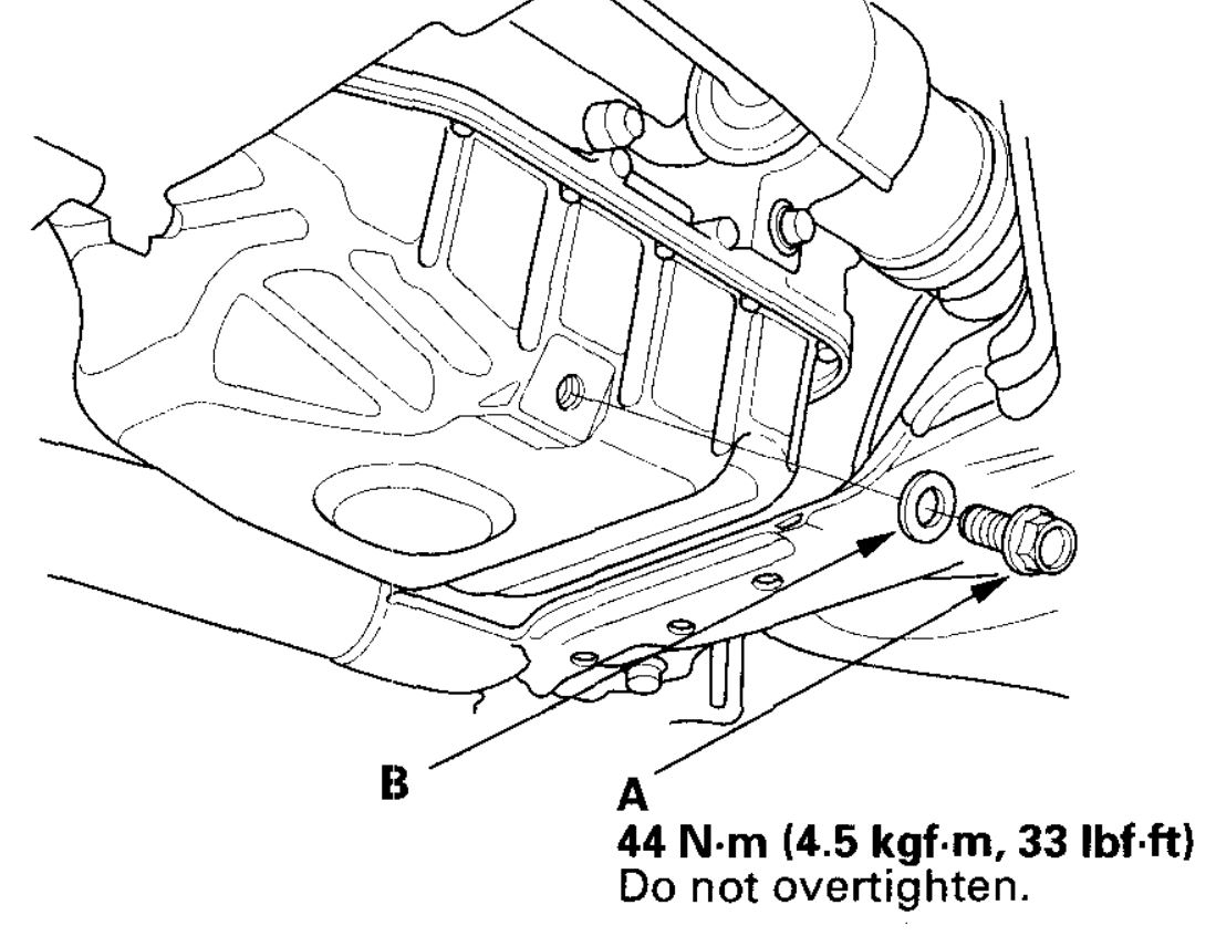

In reality this won't hurt it, transmission fluids are simply a high detergent oil with a color added. No flush or anything else needed, just change the oil and filter and you will be fine.
This guide might help if you wanted to change it yourself. Just be sure to use the correct oil and amount. The oil you need is a 5W-20 rated for gas engines, about 4.5 quarts if you change the oil and filter. Changing the oil isn't a difficult job, but it does require that you have a way to get under the car.
https://www.2carpros.com/articles/how-to-change-engine-oil-and-filter

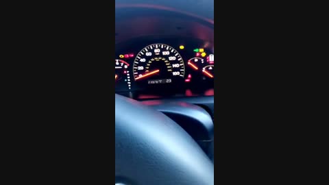

I don't know if this makes a difference but I turned on the car when I put the transmission oils in it. I thought I put engine oil so I turned on and the engine started to sound weird.
Apr 23, 2021 at 1:51 AM
CARMART013
  • 5 POSTS

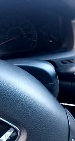

This the video I took this the same day the I made the mistake.
Apr 23, 2021 at 1:52 AM
STEVE W.
  • 15,357 POSTS
Couldn't really hear anything in the video. Was the engine low on oil when you added the transmission fluid? How much did you add in total? That could make a difference if you added a lot.
Apr 23, 2021 at 2:19 AM
CARMART013
  • 5 POSTS
I didn’t add a lot of it. The engine was low on oil though.
Apr 23, 2021 at 2:25 AM
STEVE W.
  • 15,357 POSTS
If it was low on oil that alone may have caused a problem, I would still change the oil and filter. You could cut open the old filter to see if it has a lot of metal in it as well as look at the oil coming out. If it looks like a bottle of glitter glue then you have a problem that wasn't caused by adding oil but by lack of it. If the oil looks okay then see how it sounds with new oil in it.
