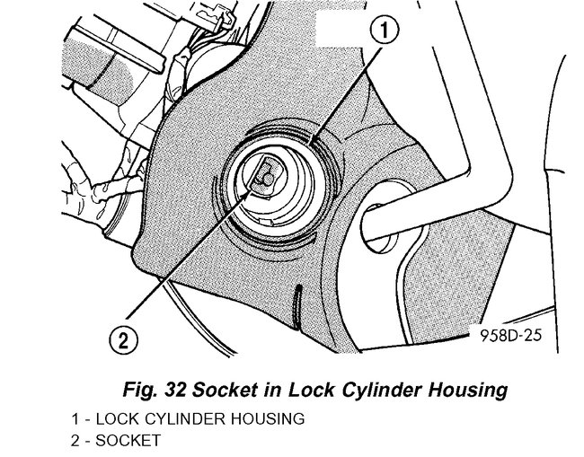

Here are the directions. The attached picture correlates with the directions.
________________________________________________
2003 Dodge or Ram Truck Caravan V6-3.3L VIN R
Key/Lock Cylinder
Vehicle Starting and Charging Sensors and Switches - Starting and Charging Ignition Switch Ignition Switch Lock Cylinder Service and Repair Procedures Key/Lock Cylinder
KEY/LOCK CYLINDER
KEY/LOCK CYLINDER
REMOVAL
1. Disconnect negative cable from battery.
2. Remove steering column cover retaining screws.
3. Remove screws holding steering column shrouds and remove lower shroud.
4. Place key cylinder in RUN position. Depress lock cylinder retaining tab on the bottom of the lock housing and remove key cylinder.
INSTALLATION
1. Install key in lock cylinder. Turn key to run position (retaining tab on lock cylinder can be depressed).
pic 1
2. The shaft at the end of the lock cylinder aligns with the socket in the end of the housing. To align the socket with the lock cylinder, ensure the socket is in the Run position (Fig. 32).
3. Align the lock cylinder with the grooves in the housing. Slide the lock cylinder into the housing until the tab sticks through the opening in the housing.
4. Turn the key to the Off position. Remove the key.
5. Install lower steering column shroud.
6. Install steering column cover.
7. Connect negative cable to battery.
Let me know how things work out. Also, if you have questions, feel free to ask.
