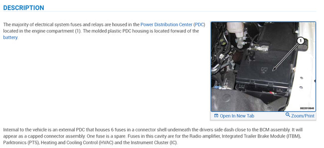

I installed an electronic trailer brake controller and had it flashed at the Ram dealership. I now have a message from the truck saying “trailer brake not connected”.
Oct 30, 2023 at 12:04 AM
  • 55,865 POSTS

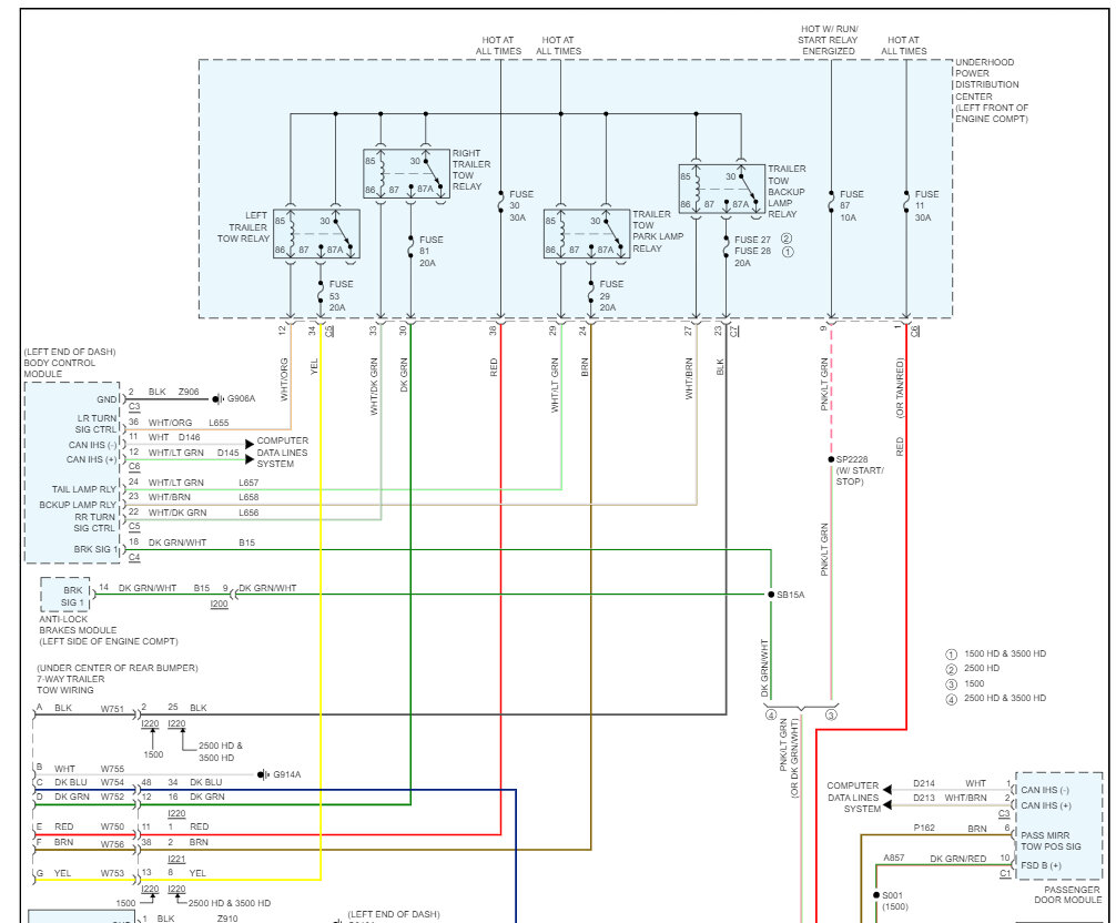

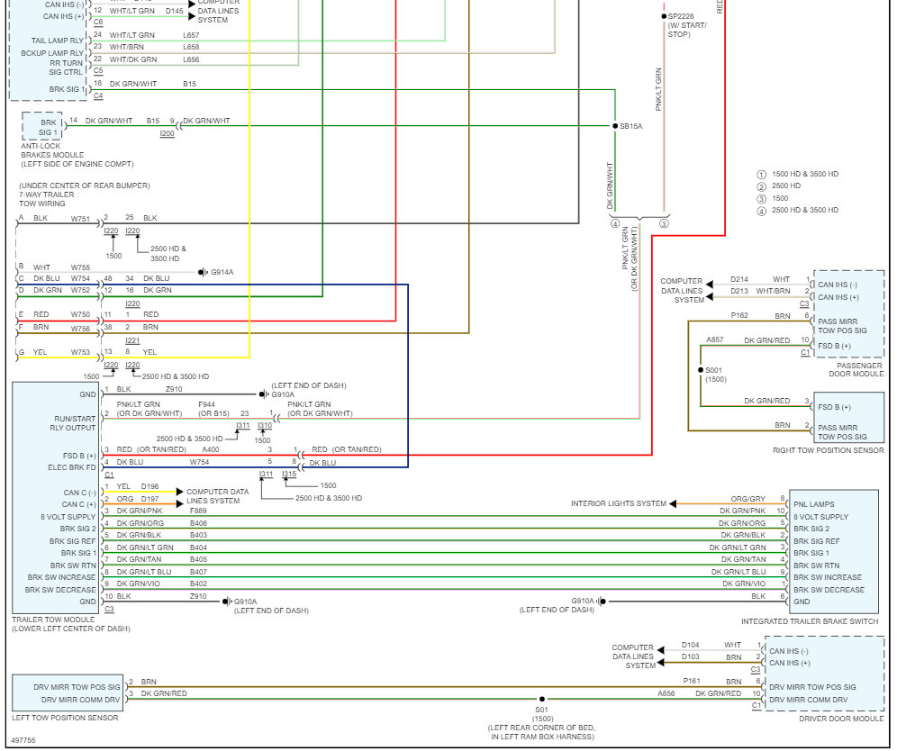

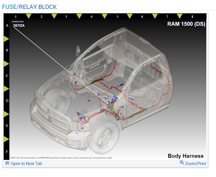

If it did not have this message before the flash, then something went wrong with the programming, and it will need to be done again. Before you go though there are 7 fuses that run the system which we should check. This guide will help, and I have included the trailer package wiring diagrams so you can see which fuses to check.
Check out the images (below) to see the fuses. Please let us know what happens.
