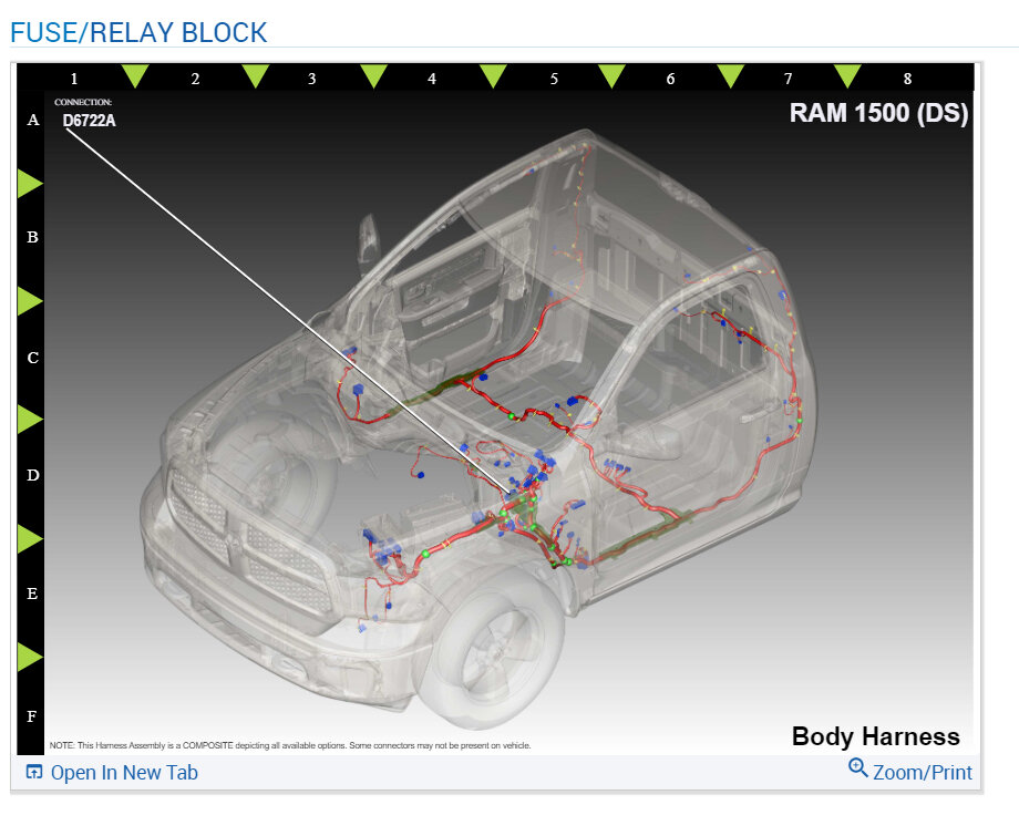

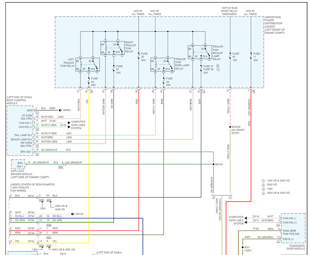

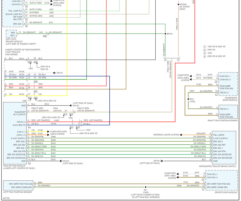

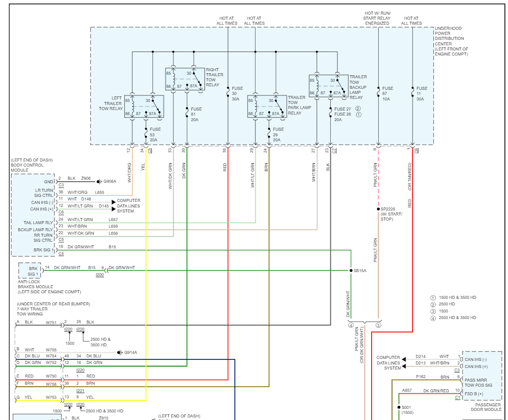

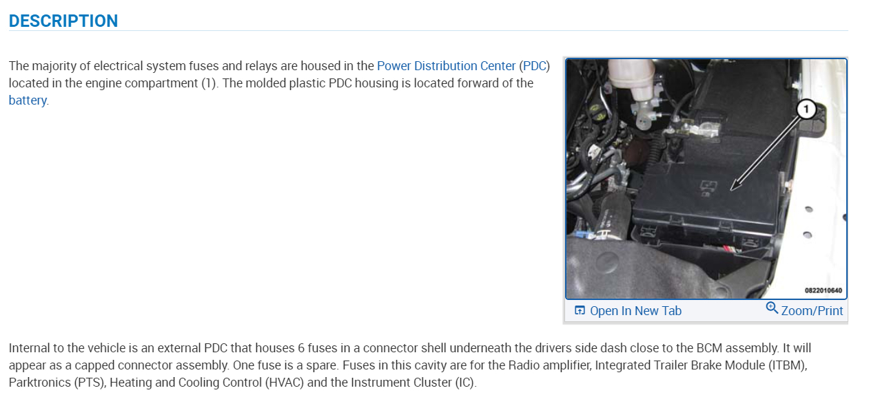

If it did not have this message before the flash, then something went wrong with the programming, and it will need to be done again. Before you go though there are 7 fuses that run the system which we should check. This guide will help, and I have included the trailer package wiring diagrams so you can see which fuses to check.
Check out the images (below) to see the fuses. Please let us know what happens.
