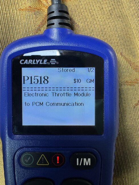

Having issues with Engine reduced power as soon as I start the truck up. The code is stating no communication between the throttle module and PCM.
I have changed the module on the driver side with a new and still having the same issues.
Wondering if anyone has an idea of what could be done?

Thank you for the response, the code itself showing is P1518. I have attached an image below. I checked the fuse in the engine bay area fuse box all 2 of them which are 15 amp are working.
I hope this can help.

After you changed the module out did you clear the codes? I have seen the accelerator position sensor go out and fool the throttle control module data which can cause this code.
P1518 - Throttle Actuator Control (TAC) Module Serial Data Circuit Malfunction
To be clear this is the part you changed out correct, also did you check the electrical connector for corrosion? I would also check the G104 ground for the module which is at the left rear of the engine. If everything looks okay, I would swap out the accelerator position sensor. Check out the images (below). Please let us know what happens.
