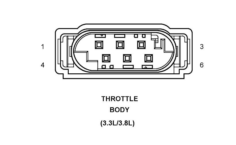

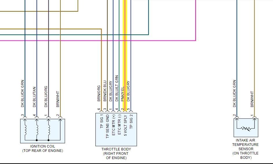

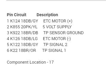

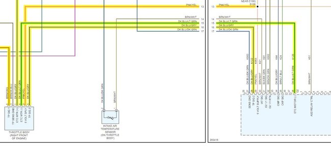

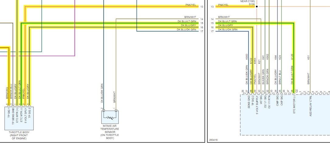

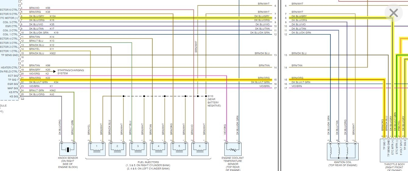

I am needing the ETC wiring diagram for my van. I had to replace the plug and there are 2 wires that are blue and gray. I need to identify what they go to.
Wednesday, November 20th, 2019 AT 10:37 AM
  • 52,797 POSTS
Good evening,
I attached the diagram for you to view. I also attached the connector diagram as well. Check out the diagrams (Below). Please let us know what you find.
